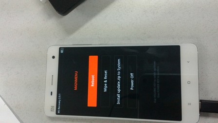

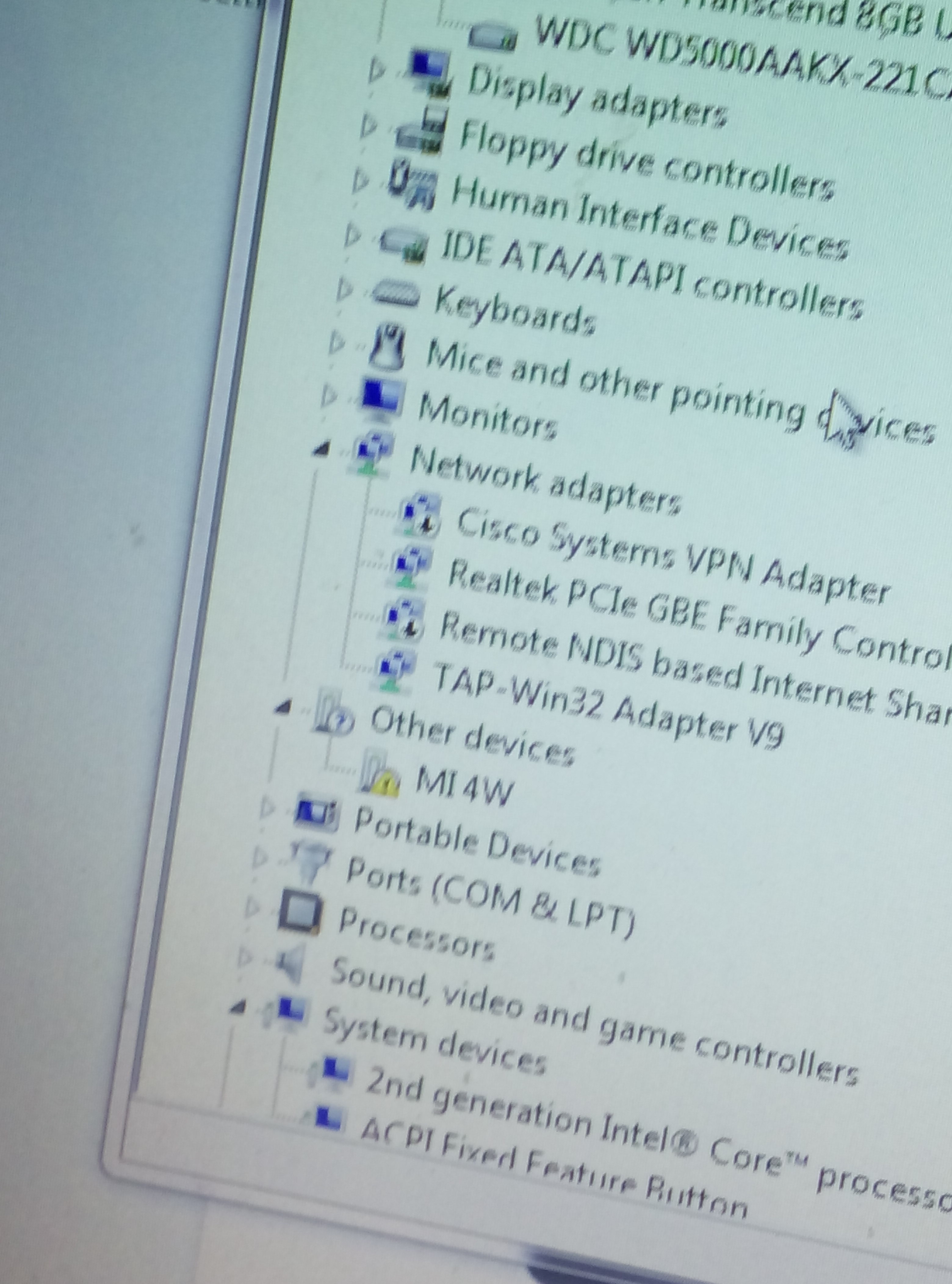

Dear pertti..i've already instaall mi pc suite, when i connected usb cable to mi4..still no connected..no device..
And also i am already trying to flash via updater like u said but..just stock in mi logo..something wrong with my mi4??

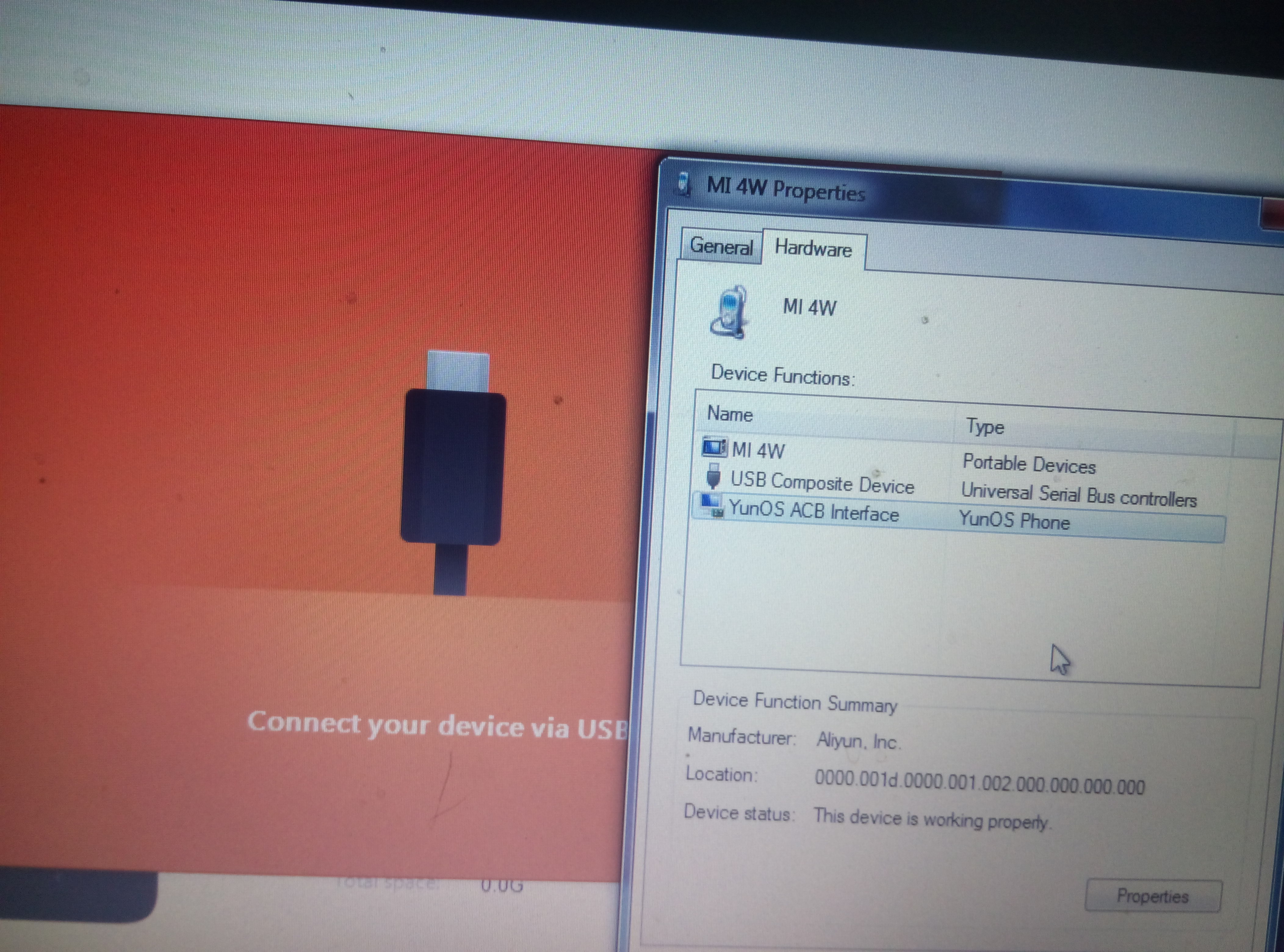

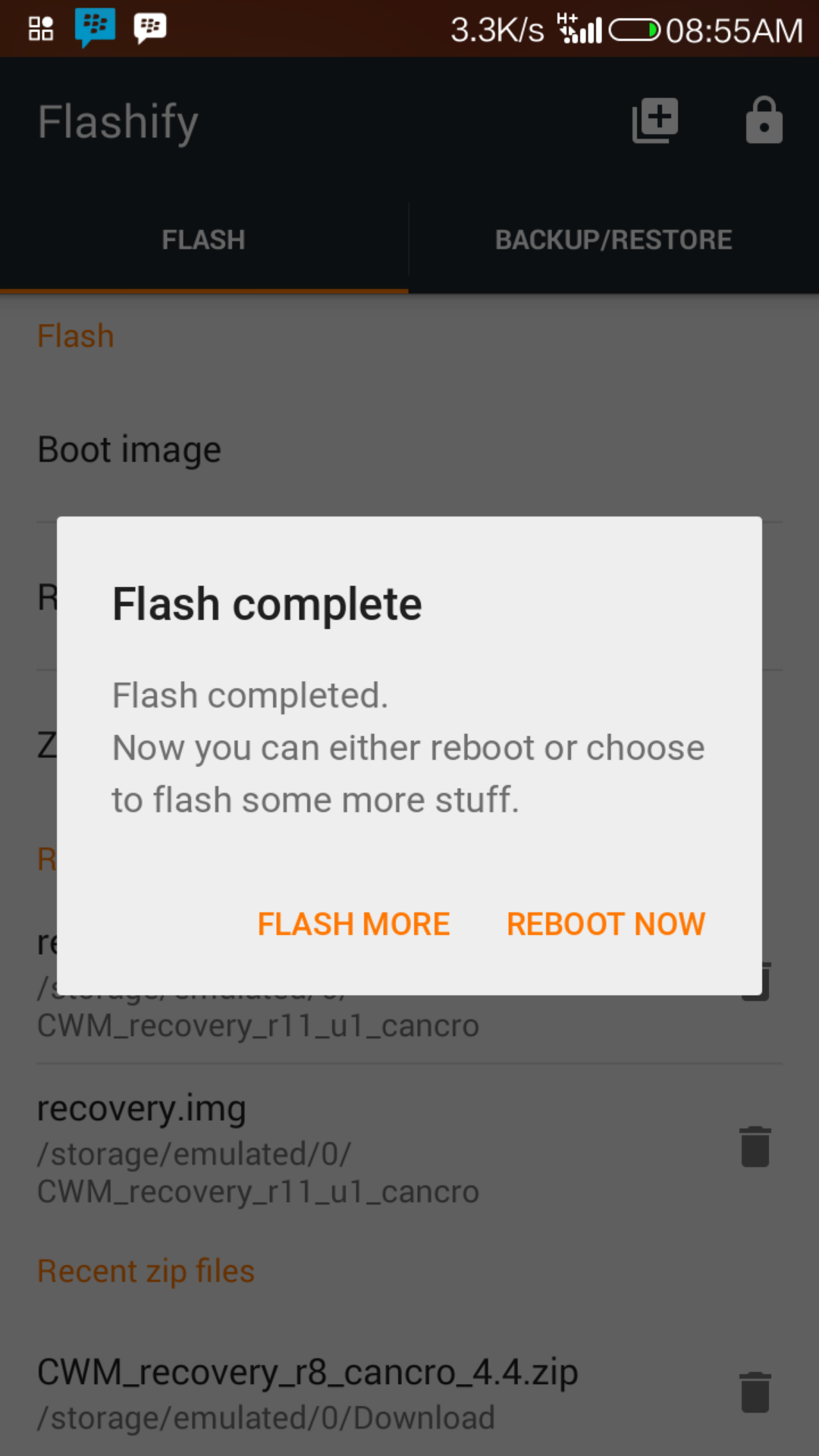

Is that YunOS Phone your Mi4?
You should install Mi-Recovery back with Flashify, you can find it in cancro fastboot factory image package (recovery.img).
Then download latest xiaomi.eu cancro international rom, move it to root of internal memory, rename to update.zip, boot to recovery and install it with Mi-Recovery (check my first pot).
Now you should have Mi Pc Suite compatible rom and kernel with correct USB ID, just enable developer tools again.

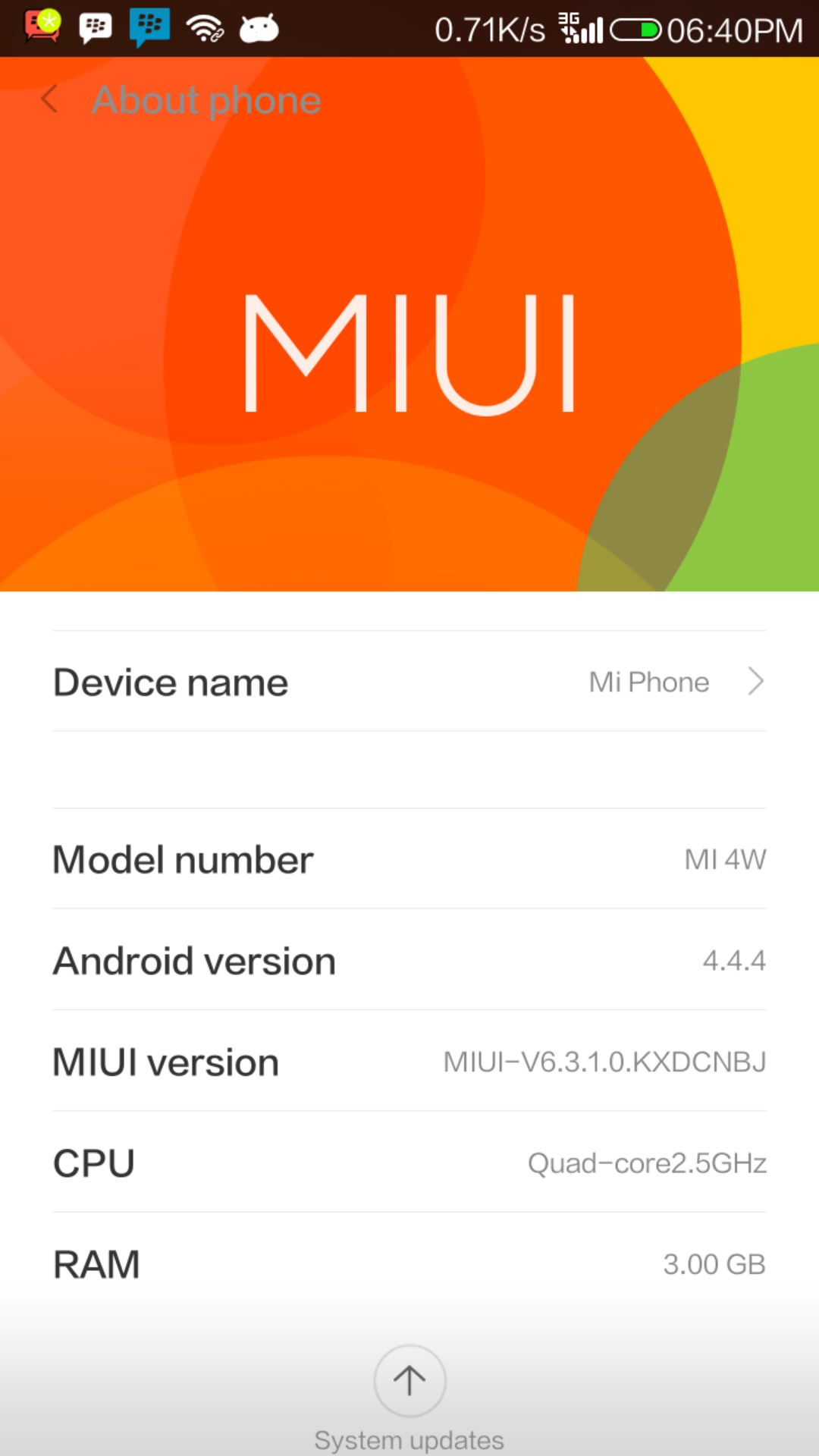

It is fake or not..i am already cek mi fake ..its chienese,but the colour its green...
Can you help me link for mi recovery cancro...i am affraid i am wrong the right one...thanks

#17
when you're on the devices list in control pannel and get the yelow sign near the MI4 right click on it, unninstall it then turn off your phone and connect to pc, it will install your drivers again

#18
Thanks.. The fact is my phone is fake one.. With cpu identifier its said mediatek with 1 gb ram.. So i return it to seller.. And got replace with ori ones.. Thanks all.. Its solved
