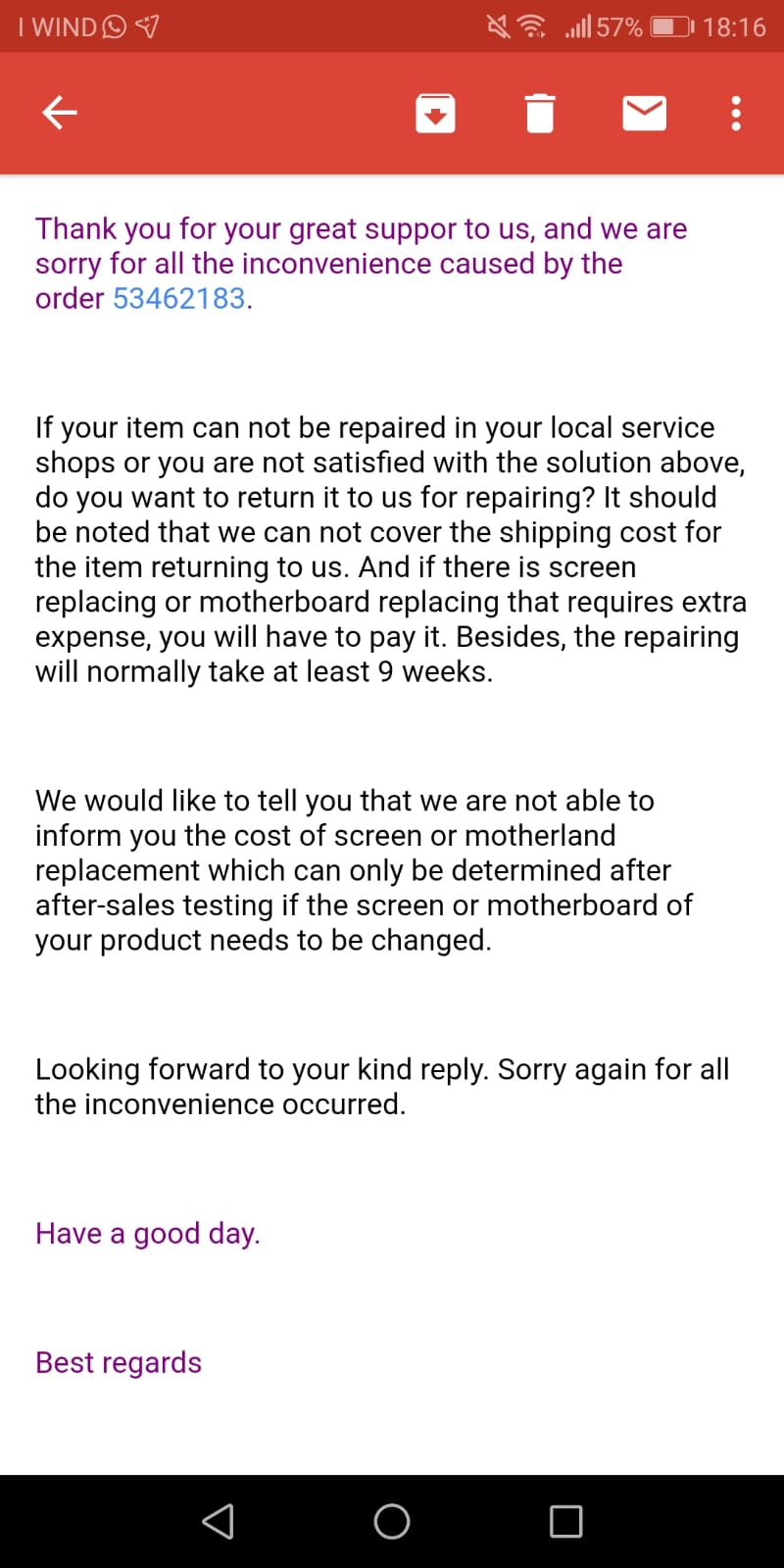

Bangg**d told me I have to pay every replacement my Mi 8 needs (screen or motherboard), plus shipping cost.
Atm screen is working but it turns off frequently, so I think the problem isn't screen: maybe connector or motherboard.
What do you suggest me? I could open it.

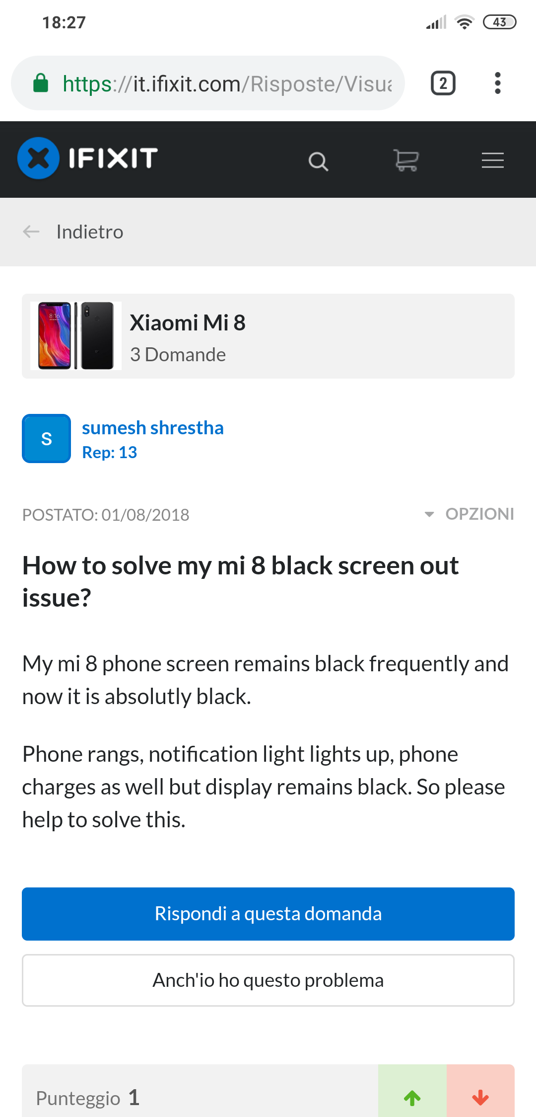

I googled the problem, and I found only a guy having the same issue, but nobody answered. Here's a screenshot
