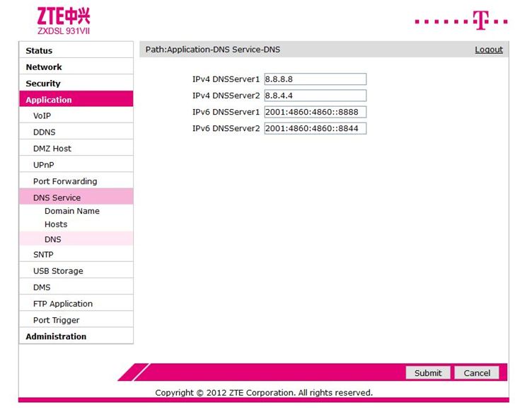

    In hope of helping someone else with this issue I’ll share what I found to be solution for problem with browser loading pages slower over Wi-FI since coming to marshmallow. For Croatian users who are on T-Mobile network and have ZTE 931VII router setting Google DNS in router seams to speed up Wi-Fi experience significantly. Maybe it works for other routers too. It doesn’t hurt to try.

    Ok, so I found that slow wifi on my Mi4 was caused by my router. I got a hold of mikrotik router and set it up as AP and the difference is hudge!!! Everything opens instantly, apps using internet open fast and load content fast.
    Wifi problems started after upgrade to marshmallow so I gues my router works better on kitkat and has problems on marshmallow, would like to know why though.

    I have ZTE 931VII - takes forewer to open anything using Internet over wifi yet the measured speed is 40Mbps. On mikrotik RB941-2ND AP connected to ZTE every app opens fast, pages load almost instantly, yet the speed measured is 20Mbps. My data plan is 50/10Mbps.
    Before upgrade to marshmallow from kitkat I had fast wifi over zte too.
