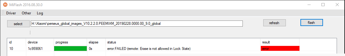

I downloaded the tools and the ROM from the official forum.
When flashing I got this :

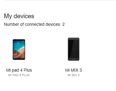

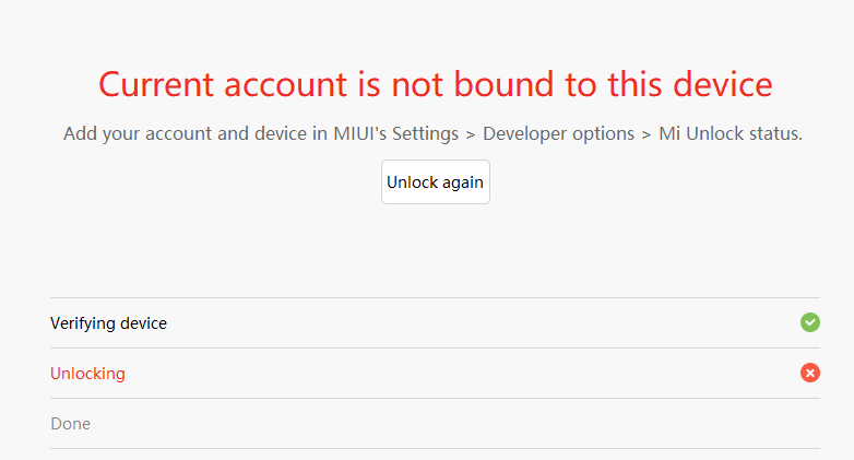

I tried to unlock my device (applied for unlock and use the official tool several days ago) and get this message :
From my cloud account, I can see the device is attached (Mi MIX 3) but offline :
When flashing I got this : View attachment 23992

I gave you the wrong advice as to being able to flash a fastboot ROM with a locked bootloader, sorry - it's been such a long time since I did this.
What you can do is "local flash" an official recovery ROM with a locked bootloader.
But if you can do this without being able to boot the current system I don't know, possibly from within MI recovery.
Here is the official instruction:
https://en.miui.com/a-232.html
But this likely will not help get rid of the password, even if successful.
I don't have any more ideas just now.
