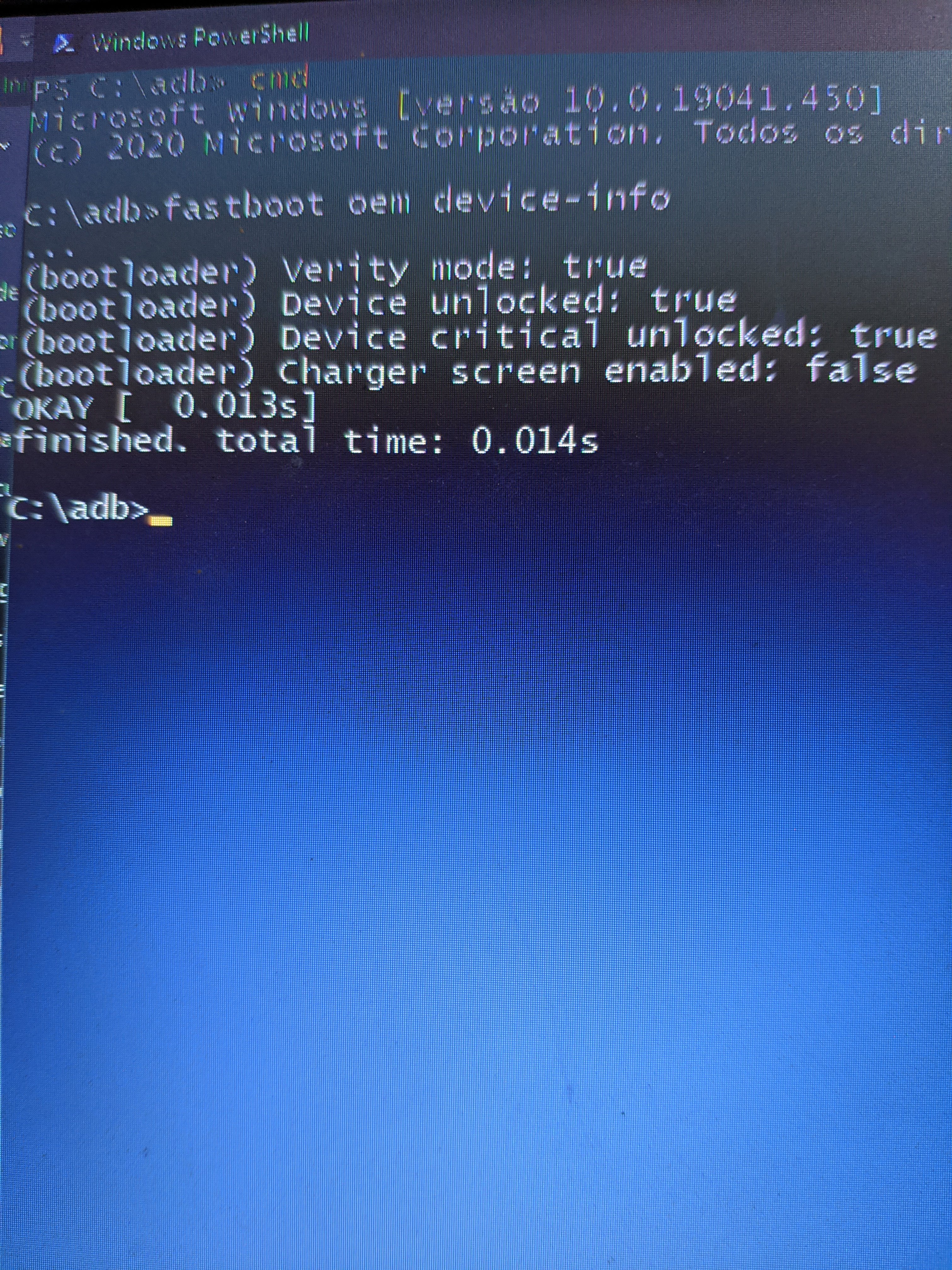

How do I check if the bootloader is relocked, and twrp for android 10 and the official latest version
fastboot oem device-info
more info here;
I did it but didn't start rertonou to the fastboot screen
that' perfect.
Now find official TWRP version and install EU rom.
Try the fisrt android 10 release (when migration was done from android 9 to 10)
