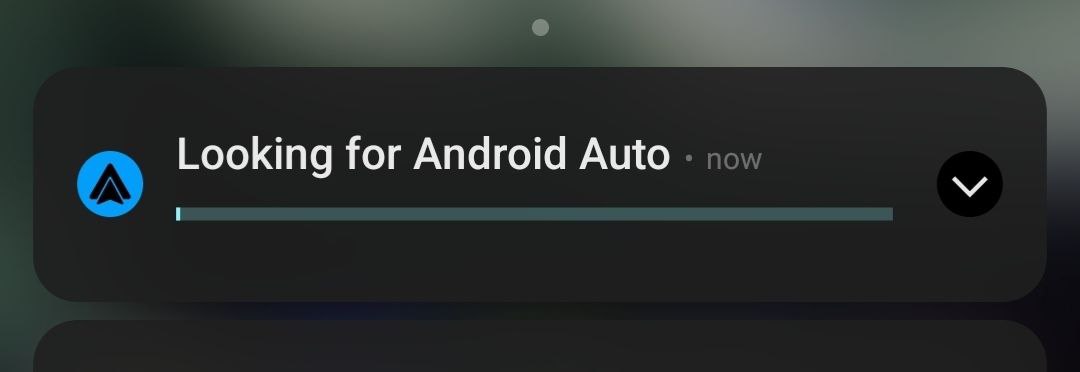

The car connects to the phone, I can use bluetooth audio, phone calls, basically everything except for Android Auto. Whenever I try to start it from the car's head unit I see this message pop up in my phone notification drawer
and the progress bar just sits there forever.
I am not sure what caused this to happen, most likely it has been an overnight MIUI update (I have automatic install turned on), but I can not confirm this as I don't know if there's a history kept somewhere. Also I'm pretty sure it was not caused by the Android Auto update because the version I'm using is pretty old (released somewhere in june), neither by my car's head unit because Android Auto of the same version works well with my wife's samsung.
The things I've tried: rebooting my car's head unit, toggling off/on bluetooth and wifi on the phone, rebooting the phone, removing the saved car from android auto, clearing android auto cache, removing android auto, installing a couple previous versions of andoird auto (some didn't work the same way, some made me update to a newer version which of course didn't work).
The only thing that I have not tried is resetting the phone to factory but at this point for me it's easier to get a different phone with all the stuff I'd need to backup and restore. Are there any suggestions that I could try that could fix the issue before I do that?
