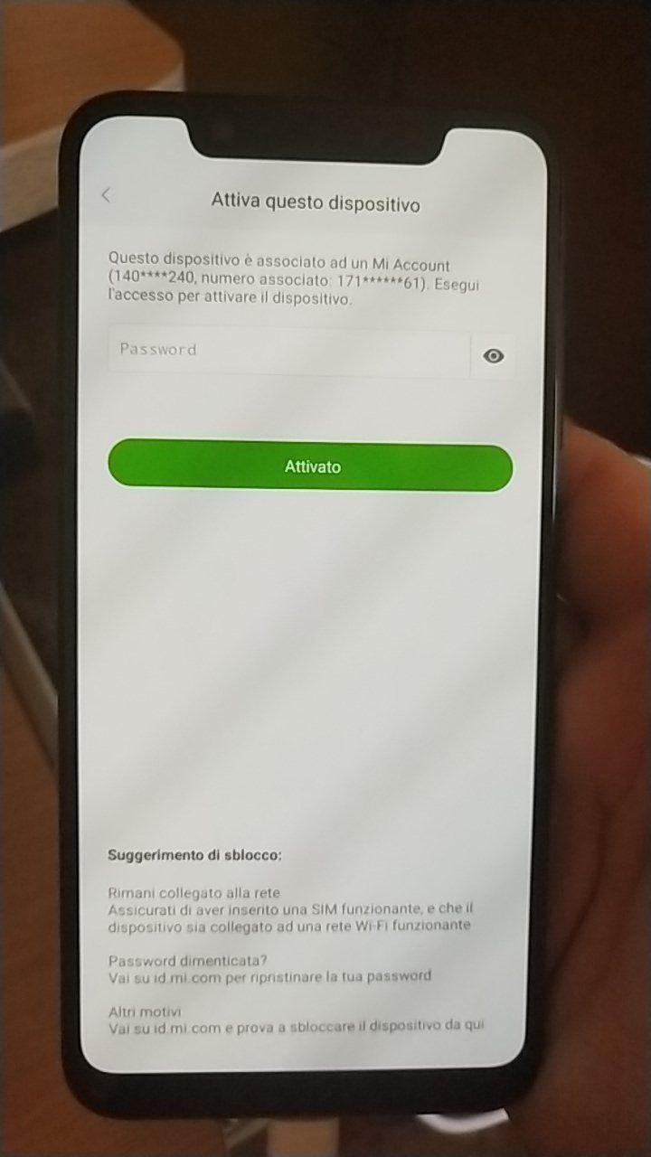

Hi to all. After i unlocked bootloader i decided to flash a xiaomi.eu rom on my Xiaomi Mi 8. All seem went good but at the first boot i got an xiaomi account block, but the account is not mine, the associated phone number seems to be indian mobile number. Someone can help me?
First all if You unlocked your phone with your account then the phone is associated to your account. You can try go back to Xioami original firmware by flashing fastboot rom with Mi flash tool but remember select the option clean all. Default is clean all and lock and that is you have to change before flash otherwise you will lock bootloader again.

The phone was new and sealed. I unlocked it with my xiaomi account
I had the same problem, my solution was to connect the phone to a WiFi without security (no password) to get the mi8 connected to internet, as my mobiy phone nr is associated to mi account, I connected my sim card to other phone. Then with mi8 connected to internet and your sim in other phone ready to receive unlock code from Xiaomi, you continue with the unlocking process in the mi8, the text message for unlock arrives to your sim(connected in the other phone) and finally you can fill the unlock code in the final step in your Mi8. I hope is clear, it worked to me.
