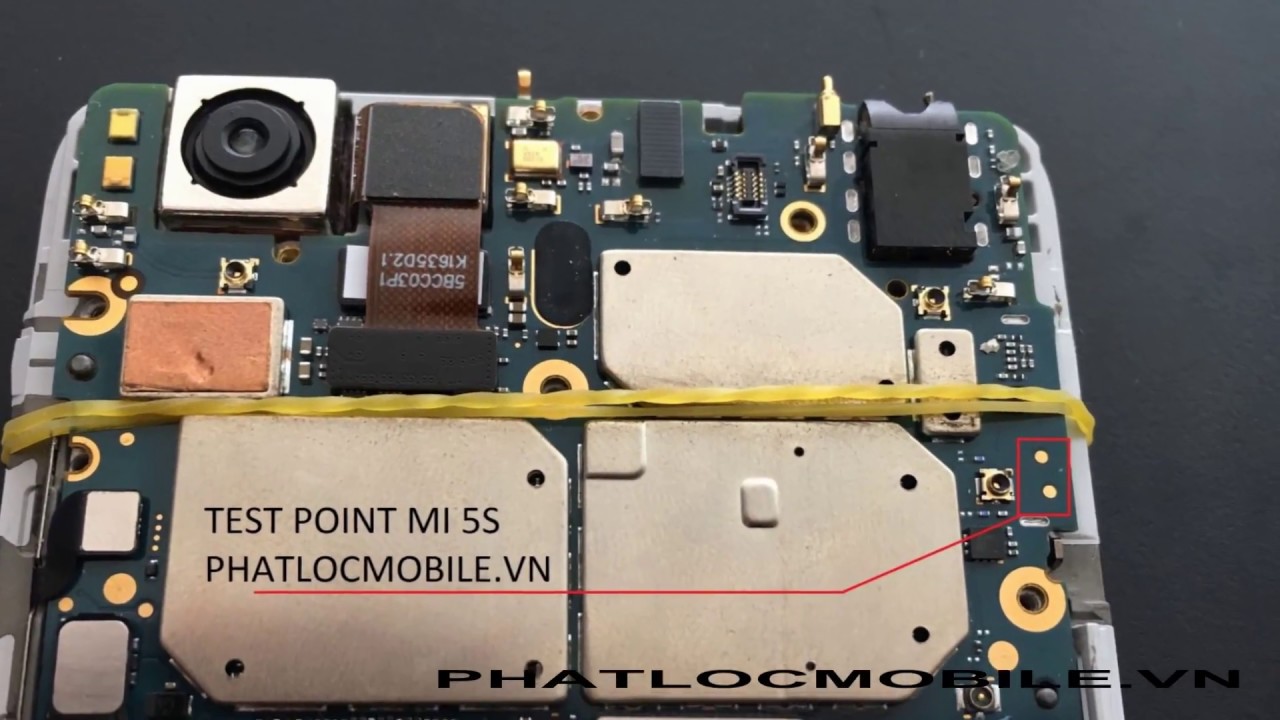

I want to update my status.
I unlocked it!!!!!!!!!!!!
I tryed everything, the deep flash cable didn't work for me and I installed a ROM at half so I was without wifi and a lot of stuff.
I tried with the test-point mode and it worked in 2 minutes!!!!!! I installed directly the China Developer and unlocked it with it's own tool. Now I'm going to install the Xiaomi.eu ROM :) :)

Sir can you explain clearly how you unlock the bootloader? i tried different ways to unlock but still no success. cause i also want to flash xiaomi.eu rom.
Well it's not so simple.
This should be the last chance to do.
So, I tried with deep flash cable to send the phone in EDL mode but with MiFlash app I wasn't able to load any ROM. So I look after the test point mode. This is really the last chance. You have to open your phone. to do that you have to unscrew the 2 little screws at the bottom, near the battery charge connector and with a litte tool you can open it, removing the screen (you can see on youtube a video show how to open and replace a battery so you can see it). Then you have to look for the test points, there are 2 little pins on the board, you connect the cable to the phone, then shortcut the two pins with a piece of wire or pliers, keep it shorten then connect the cable to the pc, after that you remove the shortcut and the pc will reconise the phone in EDL mode and if you Refresh in MiFlash app you will see it in a COM port. Now you can flash anything you want, to be sure, I flashed first the China Dev so I was able to unlock it with standard app, with the code, then I wipe it all and flashed xiaomi.eu ROM.

Thanks for your response.
Looks it's too risky. I don't know if i can do that. Hehe. Anyway, thanks for your help. I should find another way to unlock this or maybe i'll wait for the official global dev to be release. More power!
