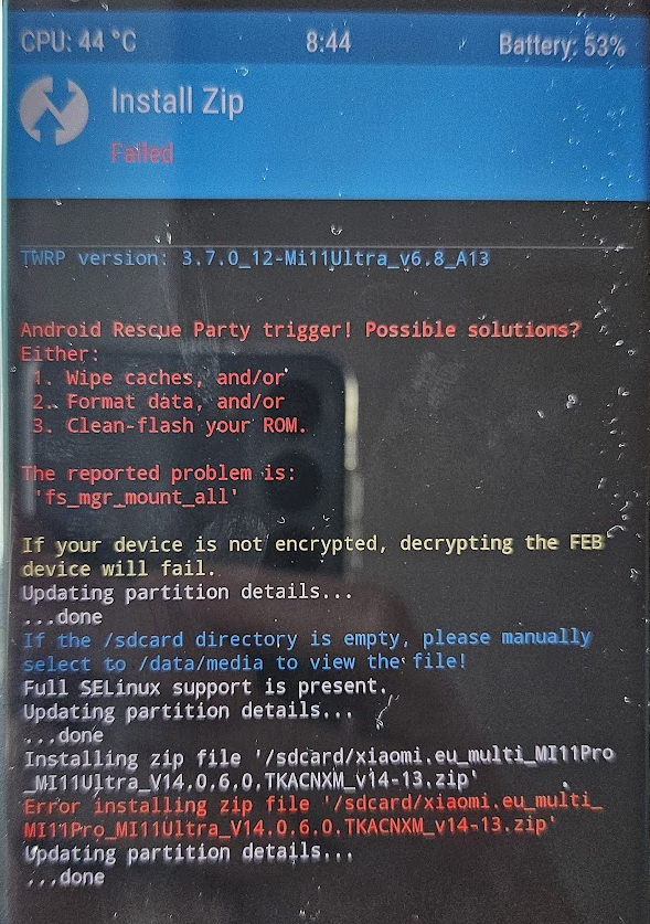

I factory reseted my Mi11 Ultra which was running the latest MIUI 14 stable.
After I've done that, I recognized that all data was still there but I wanted a completely fresh system.
So I bootet into TWRP (3.7.0) and advanced wiped the phone. I don't remember which checkboxes I checked.
After that TWRP showed 0MB for the internal storage, I found a manual to repair filesystem. I followed the manual and it showed me the internal storage again. Of course it was completely empty.
But since then I'm not able to install the ROM from scratch.
I receive an error "Error installing zip file '/sdcard/xiaomi.eu.............zip'
Does anyone know if and how I can fix that? Or did I really brick my device? :(

Have you tried a fastboot flash? Try latest version and then if you are working, install twrp if you need to.

Today I tried your idea to do a fastboot flash @Mark F and IT WORKED :emoji_grin::emoji_grin::emoji_grin::emoji_grin::emoji_grin:
The Mi 11 Ultra is up and running again.
Thank you and @Regioenleon so much!!

Fastboot flash with Mi Flash tool ?
Going back to stock rom then starting over ?
