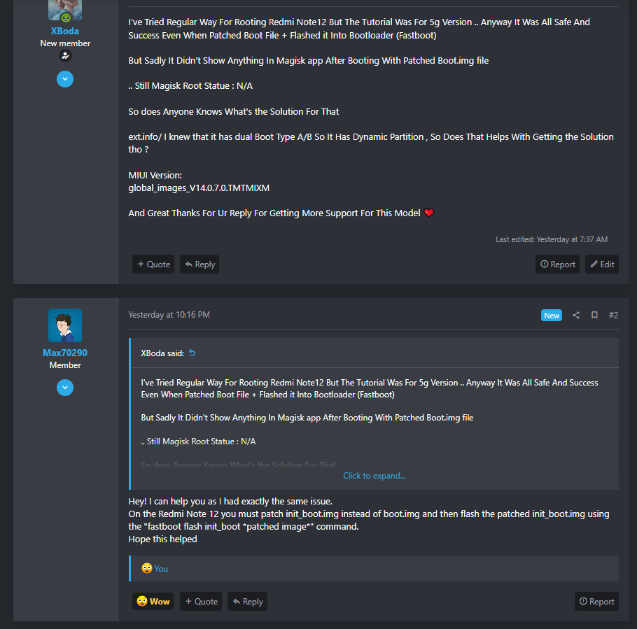

Tried to Root Redmi Note 12 4g After Making Sure That All Tutorial Vids Are Clear ,
But Sadly it Didn't Work
I've Watched Vid for Same Phone But was for " 5G Version "
It worked properly in Vid , But Not in 4G Version That I Tested With , Even After I patched boot file and succesfully flashed it
But Result Shows in Magisk App That
Installed Statue is : N/A
So idk if there's Any other thing should do to get it succedd
I Would Be Thankful For any Solution For That ❤
What you current rom version?

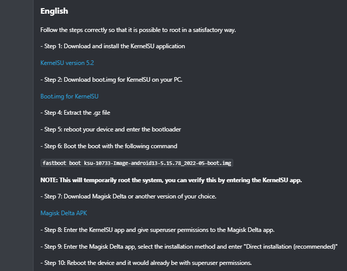

Bro Thanks alot for Ur interests . i've Finally found the solution
by this guy
Thanks to you two ❤
This trick worked with Xiaomi UI Eu Version too
Got stuck at fastboot
but
renamed pathced init_boot.img into "init_boot.img" only!
Then
excuted update phone script for win
That's all

This method worked for me. I attempted the init_boot.img method, but I ended up stuck in a bootloop. I had to reflash the stock ROM and attempt this method.
