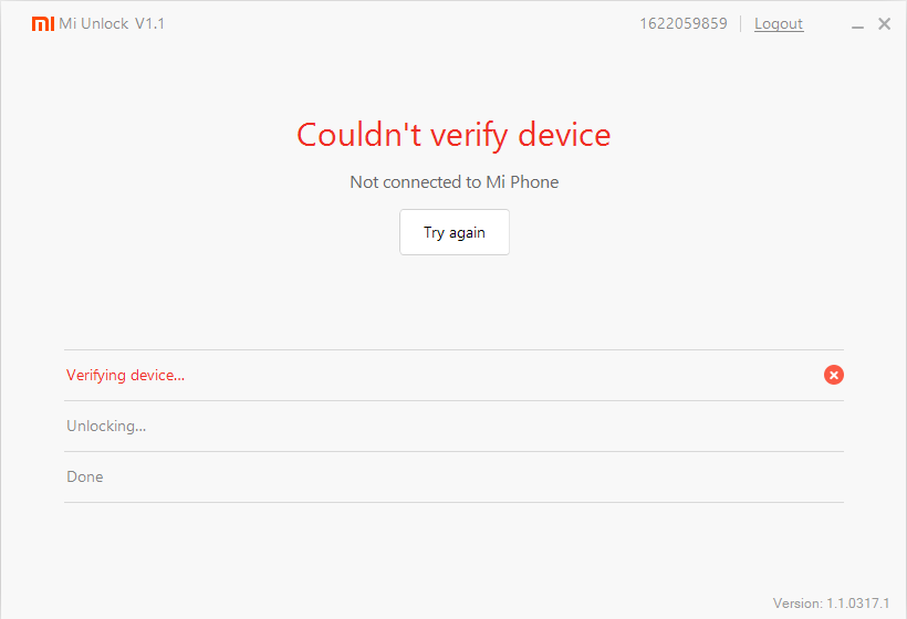

I just unlocked the Mi5s with the Xiaomi unlocking tool and everything went OK - all three entries were checked. But the phone would not re-start from the tool so I manually did it. It works all good, but when I want to enter fastboo again, the screen looks like normal and the device manager shows Android bootloader interface, but in fastboot devices it does not get shown anymore and the unlocking tool also cant find it anymore. I want to put TWRP on the Mi5s to install the weekling ROM, but do not know how to go further from where I am right now.

Any update please? My mi5 has same problem - fastboot cannot get the device!

My device no in adb devices at all. When mobile enters FASTBOOT mode, nothing can be found from PC, nothing appears in Device Manager (MI5 and ADB disappear both) just like not connected. Tried dfferent PCs, win10 and win7, same.
