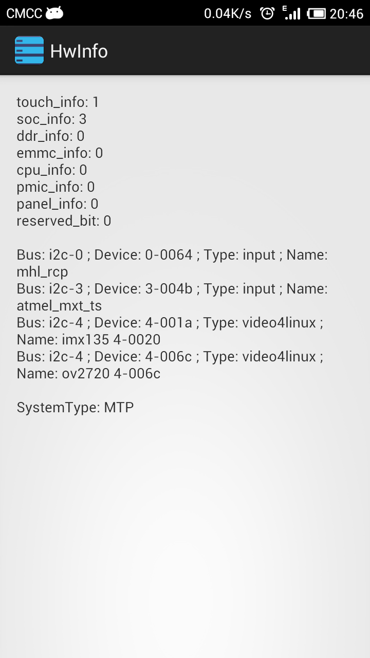

I've got almost the same.
Only one change
Enviado desde mi MI 2S usando Tapatalk 2
nice, only different camera. So either in the beginning or development they used different hardware or the stock kernel just is spammed with useless drivers.

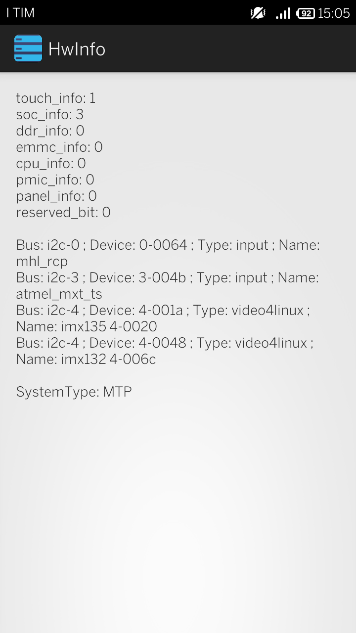

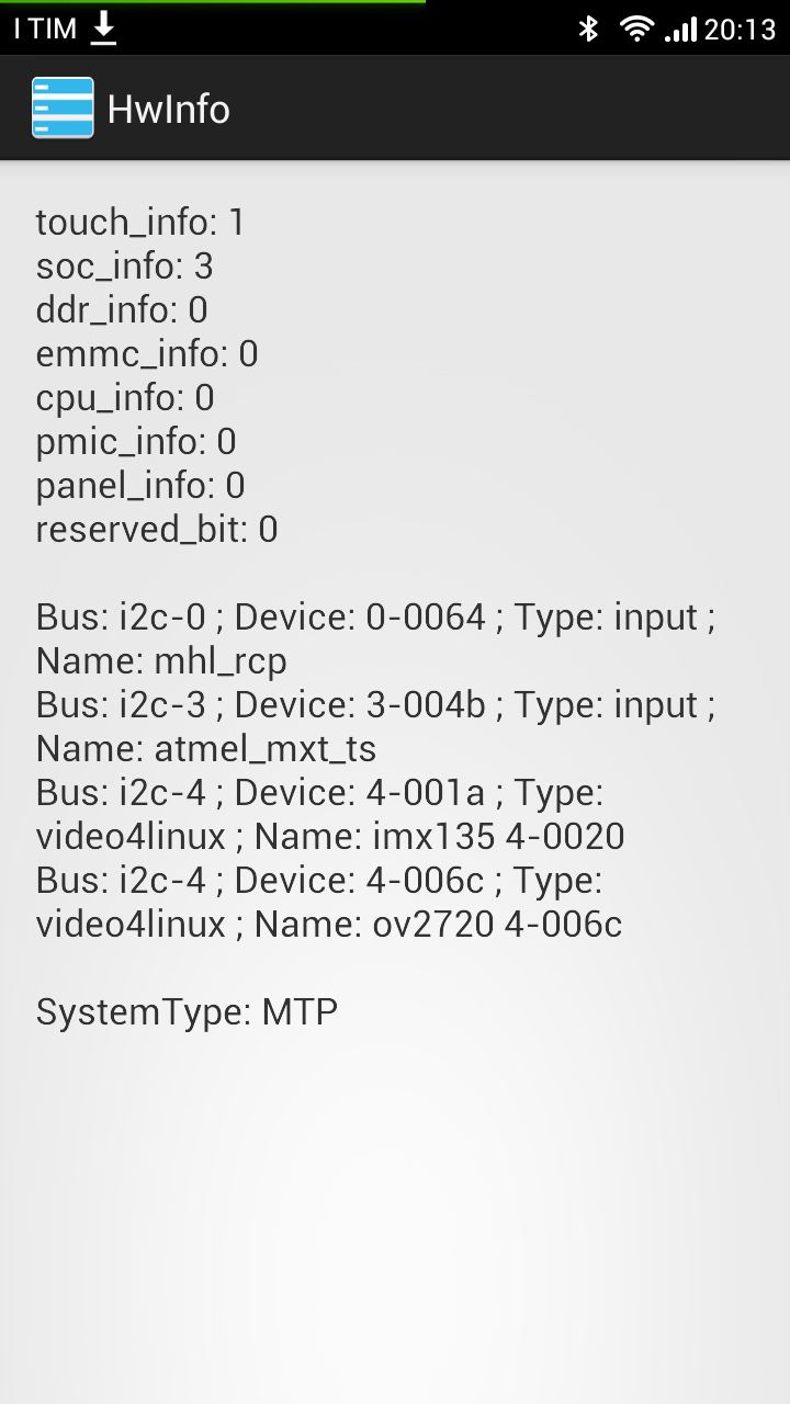

Hi M1cha this si my screenshot. Hope it's helpful.Device MI2S

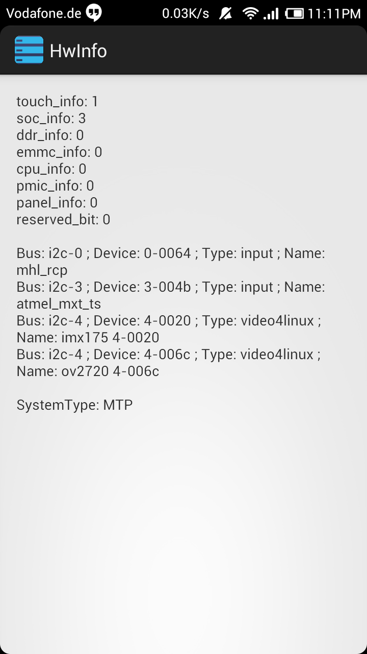

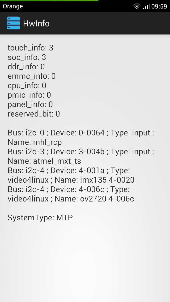

Mine. From a M2S 32 GB (the one with 13mpx camera)

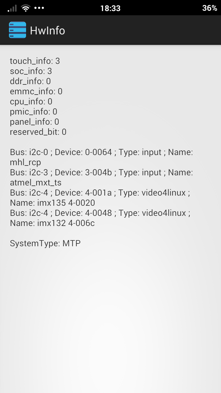

MI2S 32GB (13MP rear camera):
the app gives me a different value for the sensor/driver of the front camera,
it reports an IMX132 sensor instead of the OmniVision one (ov2720)
My MI2S has been produced in November 2013.
Probably, recent MI2S have the IMX (Sony??) sensor instead of the OmniVision one:
https://github.com/mitwo-dev/propri...mmit/f25234bfa452a62c2abed2039e05361798db560d
I bought my phone in July and also have imx132 as front camera.
Sent from my MI 2SC (32GB) using Tapatalk

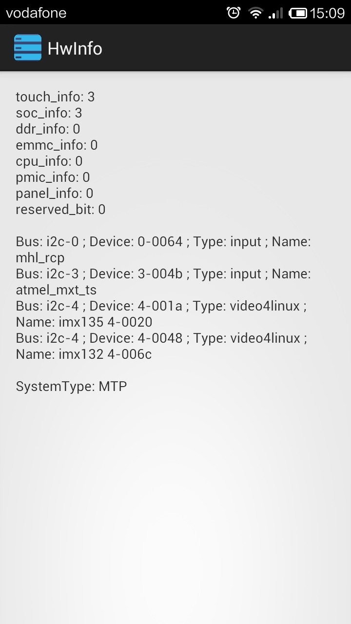

Mi2S 32GB,
exactly same with davfiala's..

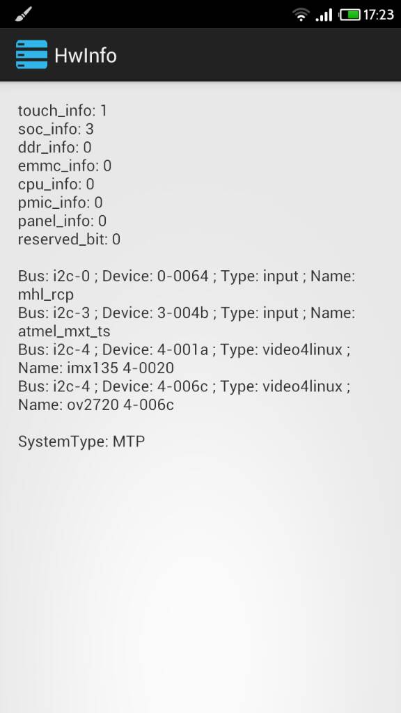

Hi @M1cha, please I need help. I send my Xiaomi M2s for replacing its broken screen, and I think they have installed a non original/faulty one. It has some "stains" and also LED notification light doesn't work.
The app shows a difference with my previous screenshot. Last line says
Bus: i2c-4; Device 40048; Type video4linux; name: imx132 4-006c
instead of the previous
Bus i2c-4; Device 4-006c; Type: video4linux Name: ov2720 4-006c
Is this related to screen?

just send me your full dmesg and I'll tell you what's wrong with your device.
Thank you very much for your attention. I hope you can see something helpful here.. I've just realized that proximity sensor doesn't work either.
  • dmesg.txt
The hardware should be ok. But it looks like you'd have a whole new device because you have different cameras.
If your screen has stains you have to send it to repair again I think.

Hi again. As I suspected, the store is telling me that the problem with LED and proximity sensor are not their responsability.
Is it possible to say, looking at dmesg or logcat, if there is a hardware or software issue with both parts? Thanks again

you can boot into cwm and try to manually enable the leds (/sys/class/leds/[red|green|blue/brightness).
if you dunno how todo this I can help you with teamviewer.
Reactions: deini
I don't know if this is correct:
In recovery, I mounted system and opened an adb shell from pc and typed:
echo "1" > /sys/class/leds/red/brightness
But nothing happens. (the response in shell is a line with the command i entered)
since the value has to be between 0 and 255, 1 is hardly noticable. try sth higher like 200 :)
Ok, I remember that in my old HTC Desire, we used 0 and 1 for enabling and disabling button backlight.
But well, I 've tried now with 200 and still nothing, neither in blue or green. So I assume that it is a hardware problem...
