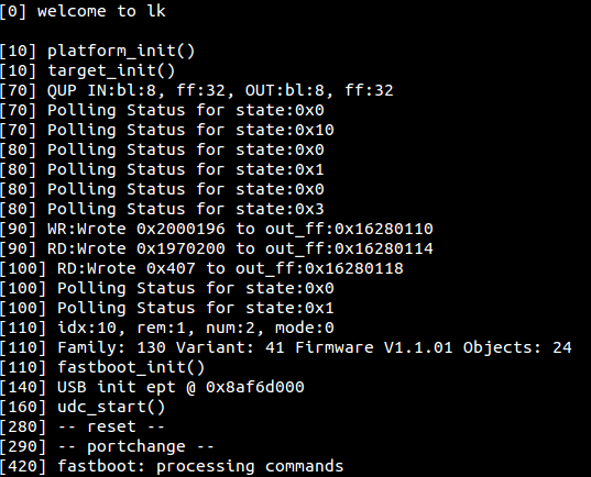

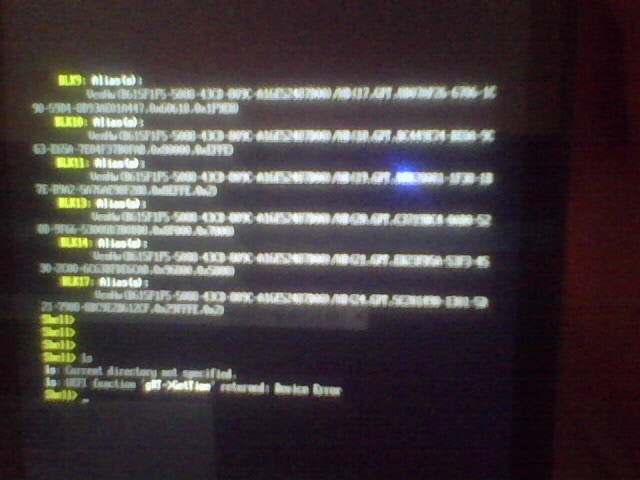

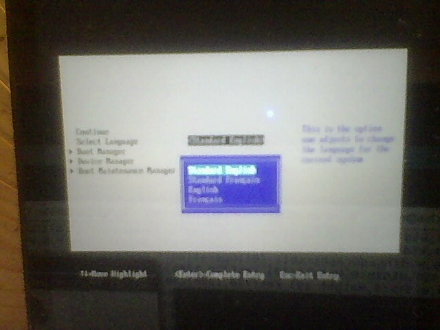

This is the successor of GRUB4Android - a project to bring multiboot to Android.
Even though most people hate UEFI on computers(users because of secureboot and devs because it doesn't change many problems of BIOS afaik), Intel's implementation("EDKII") actually is quite good and perfectly fits our needs.
Also, it still allows you to boot GRUB - just in case you wanna do that.
First off, having UEFI doesn't mean you can boot to Windows without any extra work. actually UEFI would be like the first 2% of work for such a project).
what's working already?:
  • it can boot :D (on mi2)
  • UART, Timer, LCD-screen, MMC
  • It can boot Intel's bootmanager App
  • non-volatile storage
  • add support for booting Android
