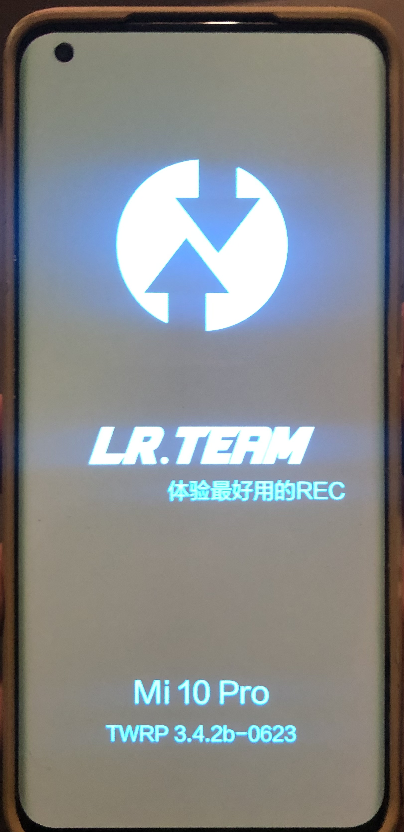

are you able to boot into twrp? if yes, you can check the version. there should be a banner with version number
Here again, I had make some photos, hope they have the information you need.
Thanks in advance for the help mate!
from what I see, you are using an old twrp, it is not compatible with android 12 / MIUI 13.
for example I used twrp 3.6.2 from skkk for installing ROM that you tried to install.
