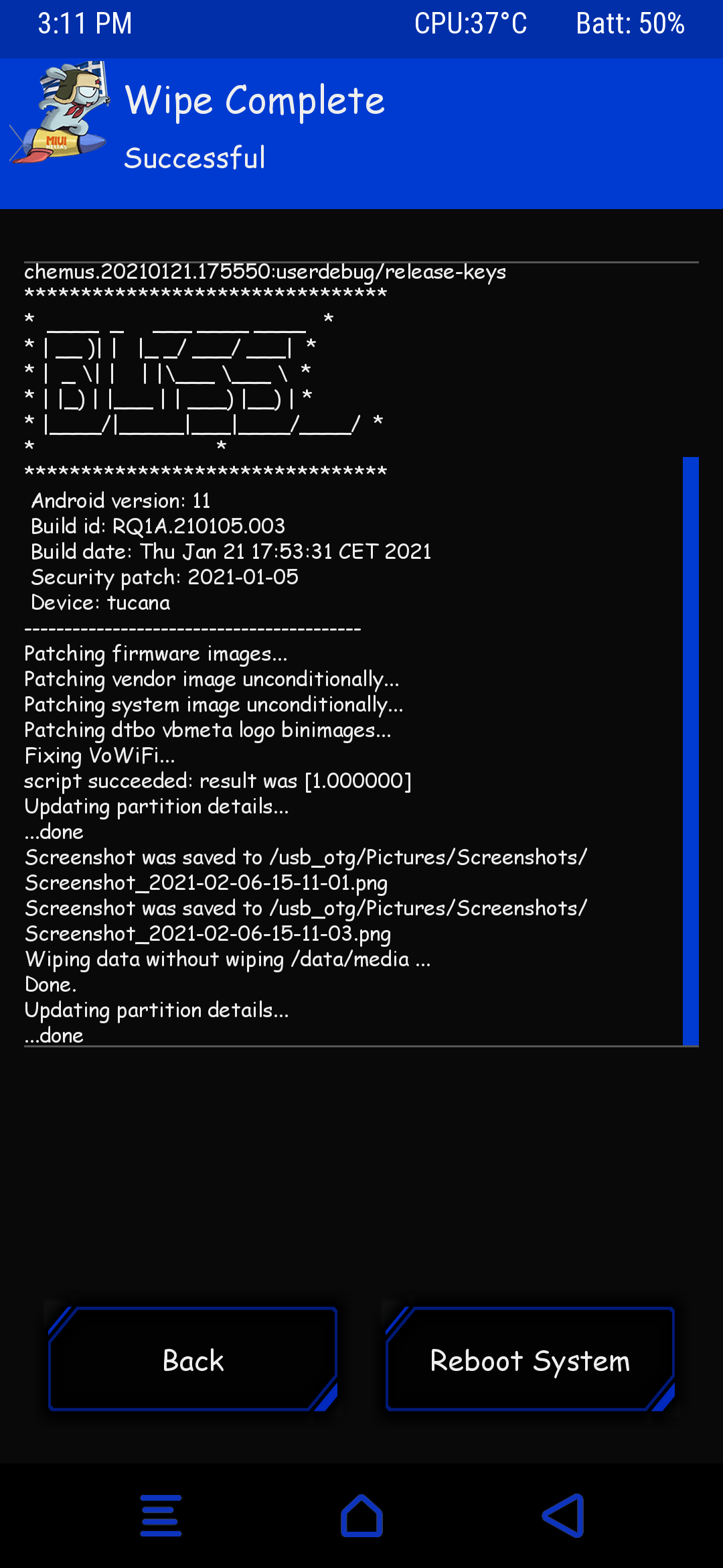

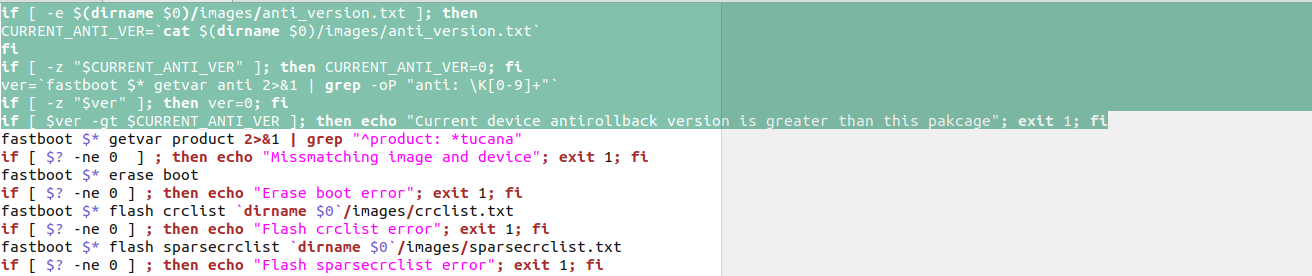

HELP problem after flashing an AOSP ROM, I can't reinstall the weekly beta miui12.5 (problem with vendor or antirollback maybe)
/vendor | /dev/block/sda24 | Size: 1951MB Used: 3MB Free: 1948MB Backup Size: 3MB
Flags: Can_Be_Mounted Can_Be_Wiped Wipe_Available_in_GUI IsPresent Mount_Read_Only
Primary_Block_Device: /dev/block/sda24
Display_Name: Vendor
Storage_Name: Vendor
Backup_Path: /vendor
Backup_Name: vendor
Backup_Display_Name: Vendor
Storage_Path: /vendor
Current_File_System: ext4
Fstab_File_System: ext4
Backup_Method: files
this is after wipe vendor ???

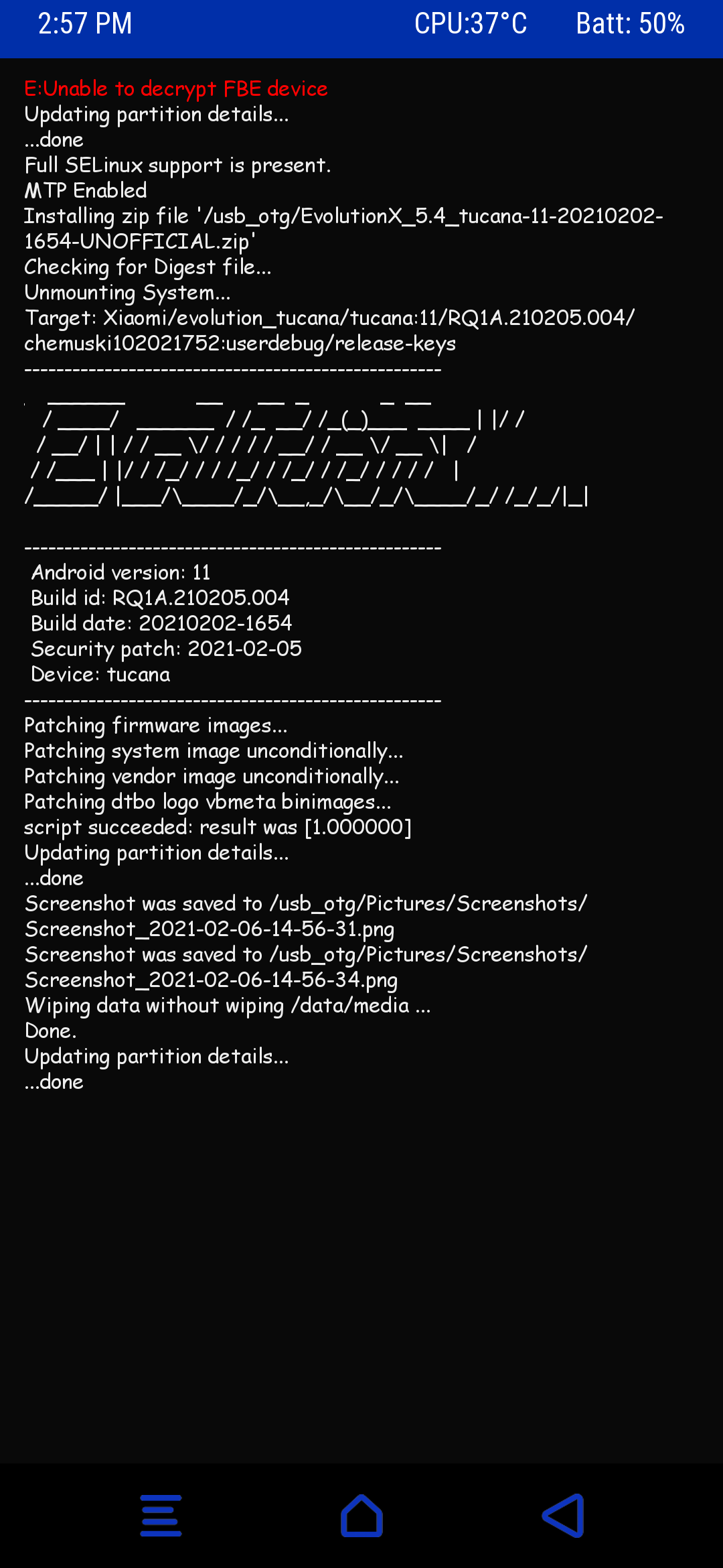

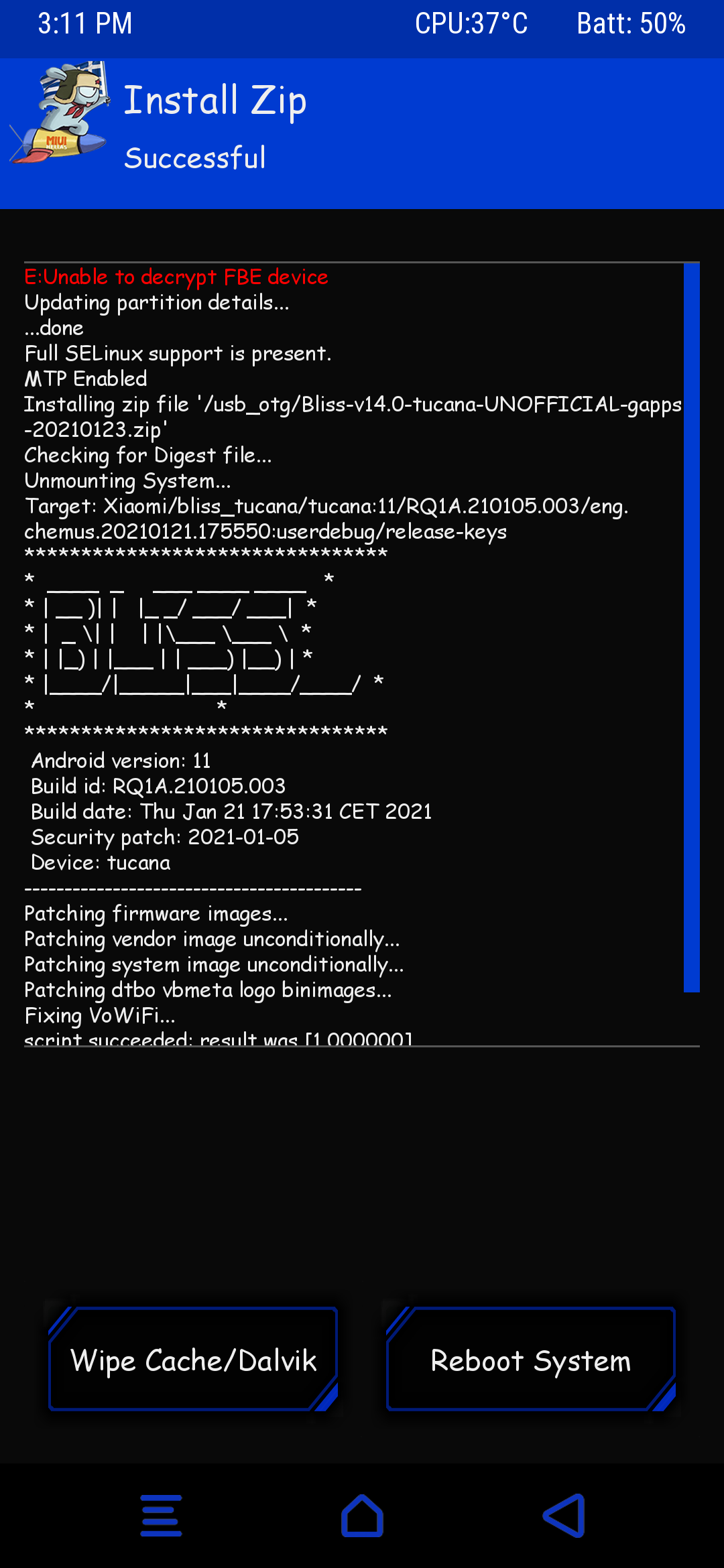

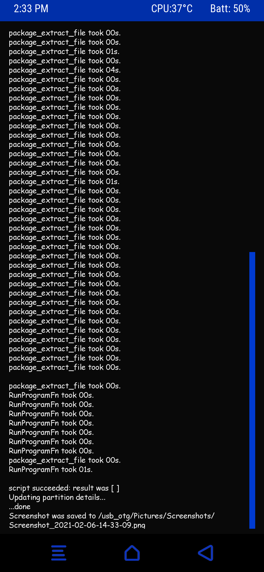

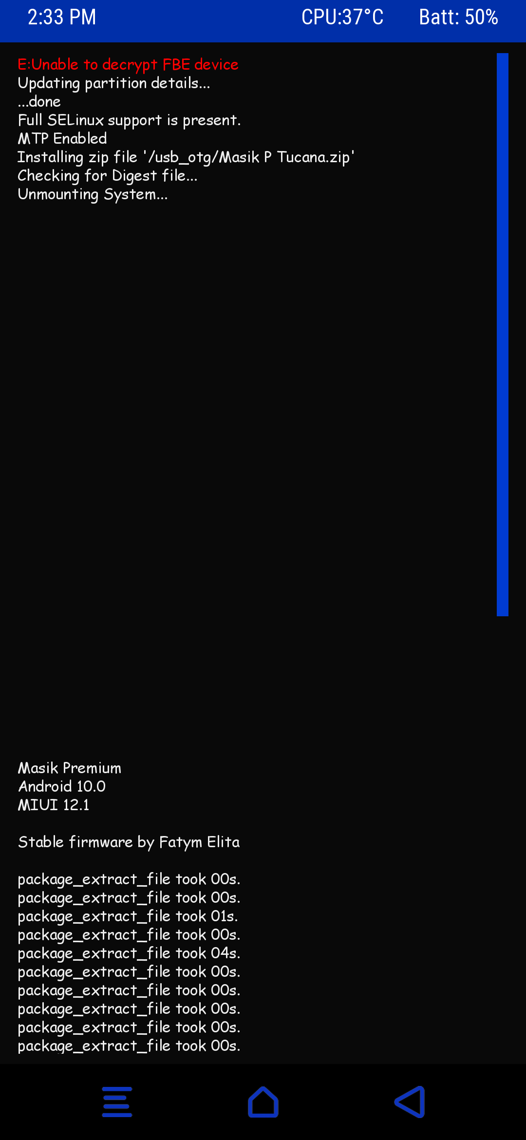

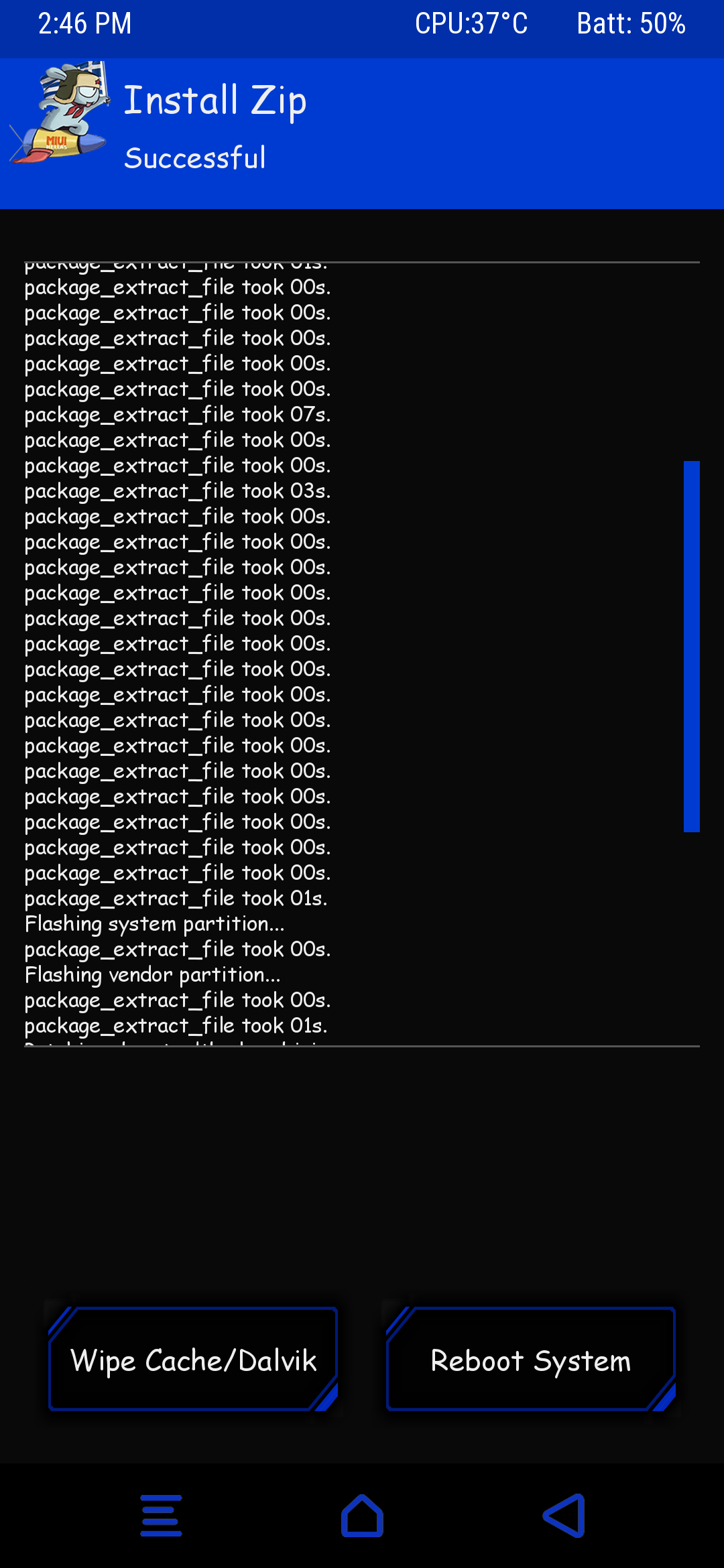

yes, I had installed masik ROM and just now I have formatted vendor and made the .log

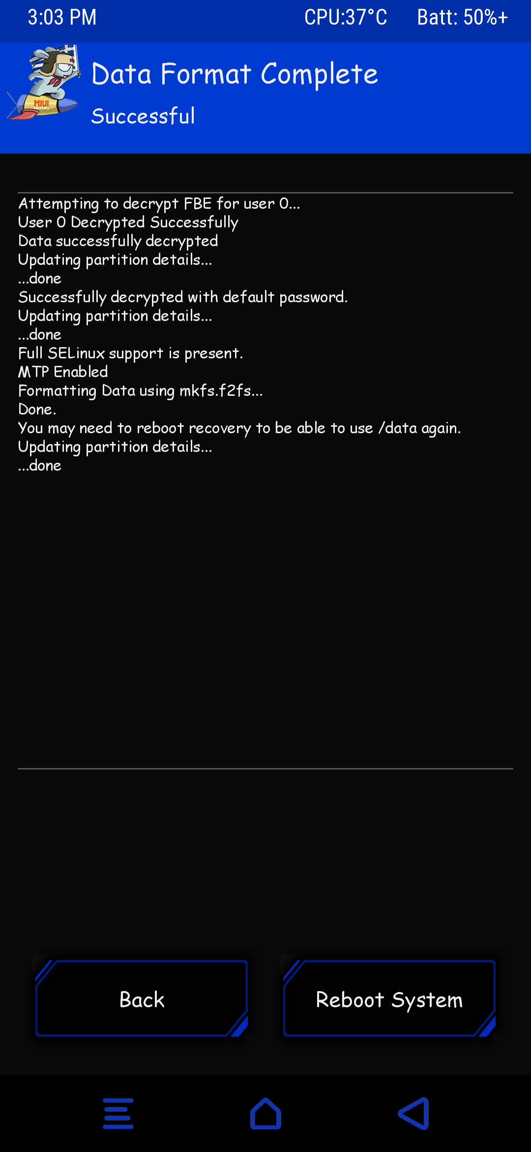

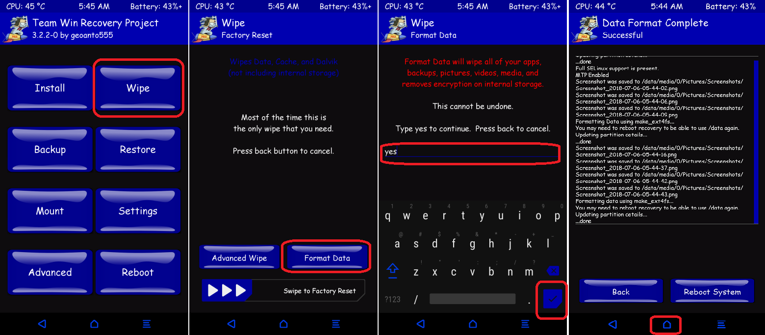

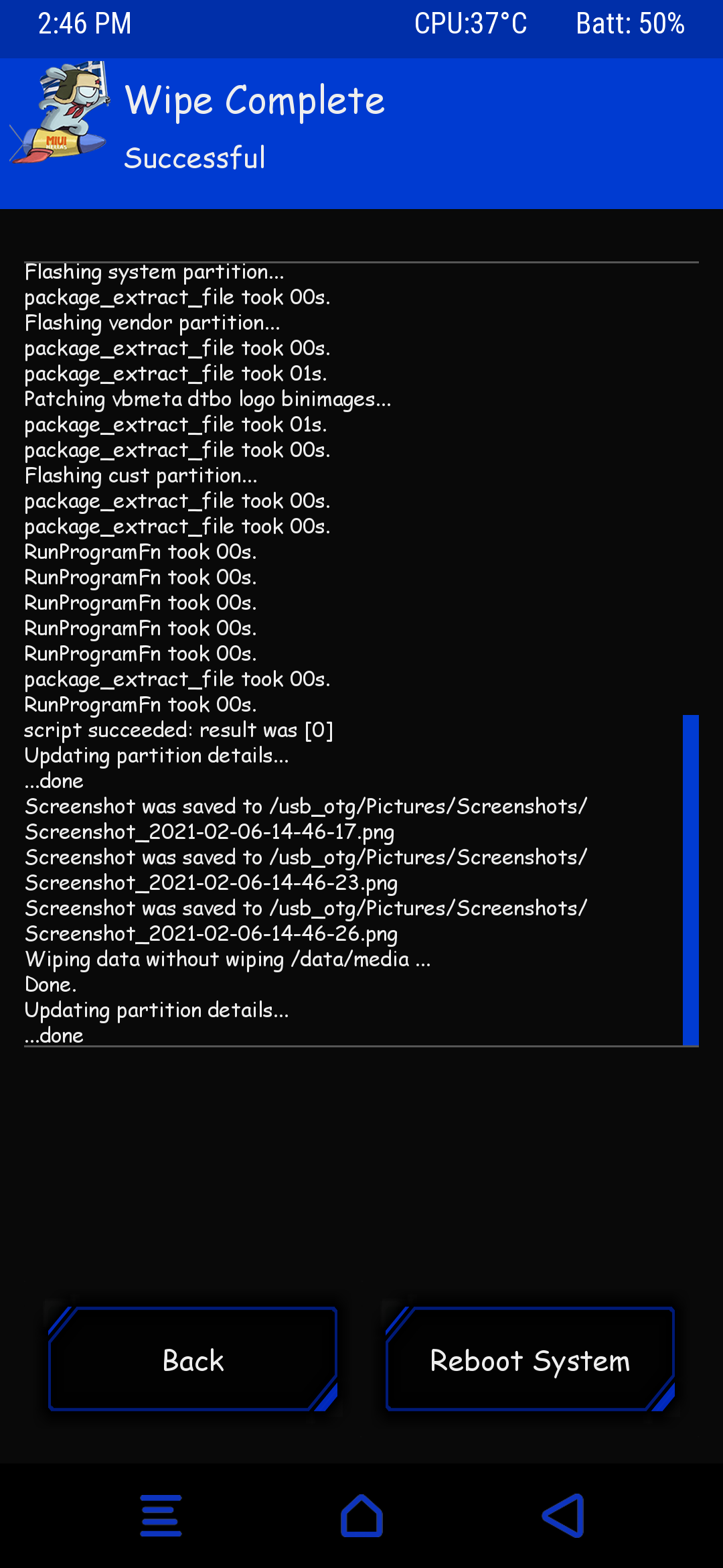

right now I just did a format data, restarted the recovery, wipe vendor and I will install the ROM beta eu and test
the after is wrong...
If installations is completed without fails and format data works I haven't any other ideas to tell you.

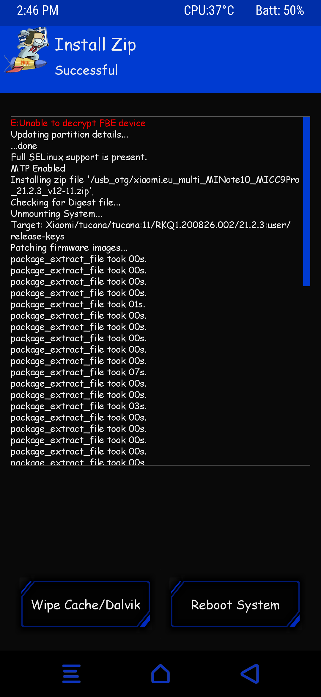

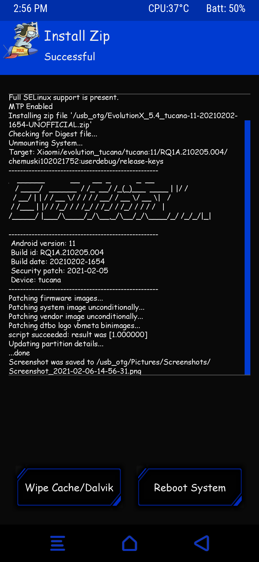

I don't know what else I can do, the ideal would be to be able to install the beta ROM from Xiaomi.eu, I don't know what happened to my phone

Yes! I installed the 12.0.4 Global stable update and it worked, then I tried the Chinese 12.1.3 and it didn't work, I decided to try the latest Chinese beta and it worked (I think it was a coincidence and it worked again), then I did format data and installed the latest eu beta and it worked, I'm configuring everything again now.
