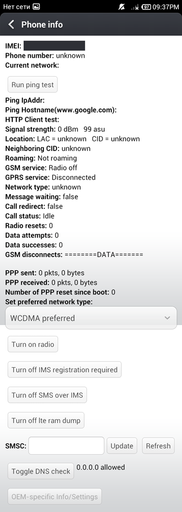

In engineering menu is written that the radio is turned off. How do I turn it on? Button is not active.

Yes, i try to use this engineering menu. Phone is rooted, but many buttons not work. I can select the type of network(WCDMA, GSM and others), but can`t "radio on".
This is my engineering menu
