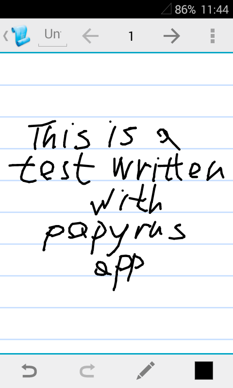

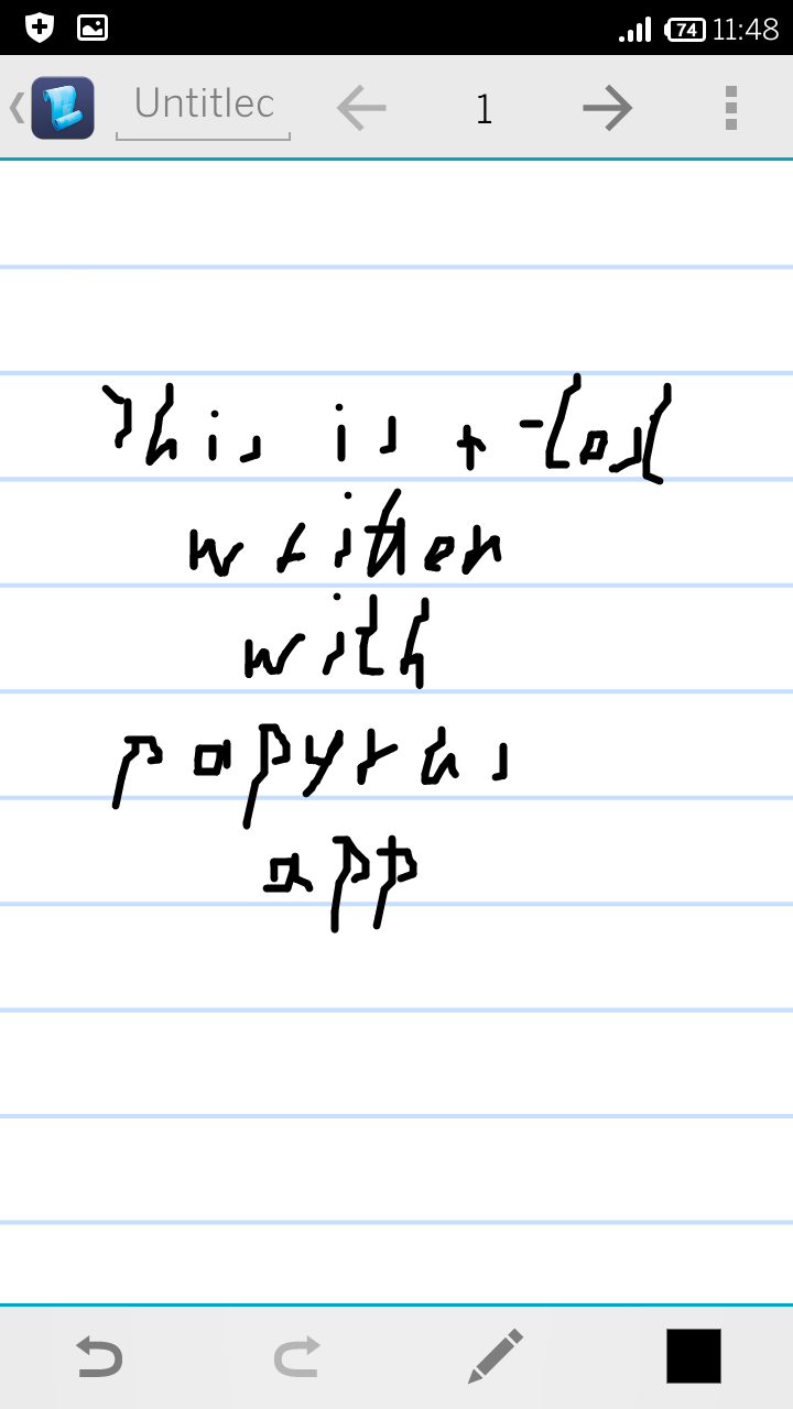

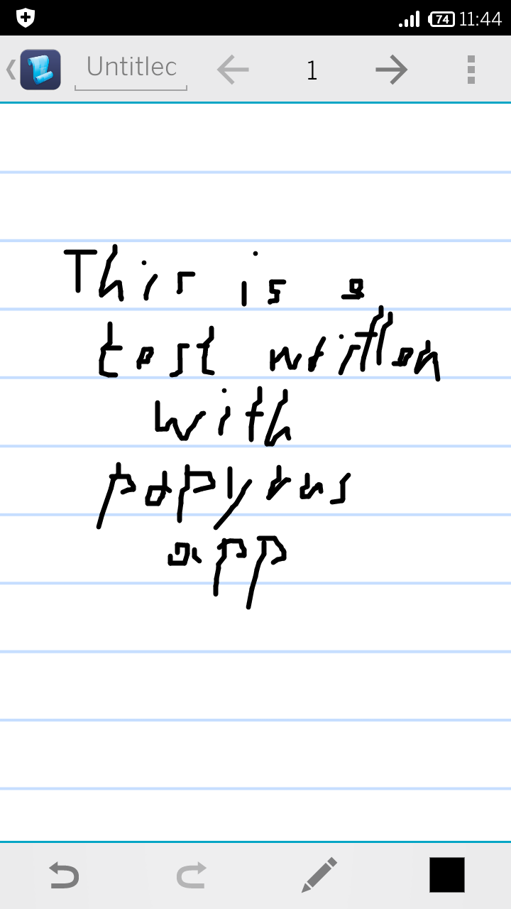

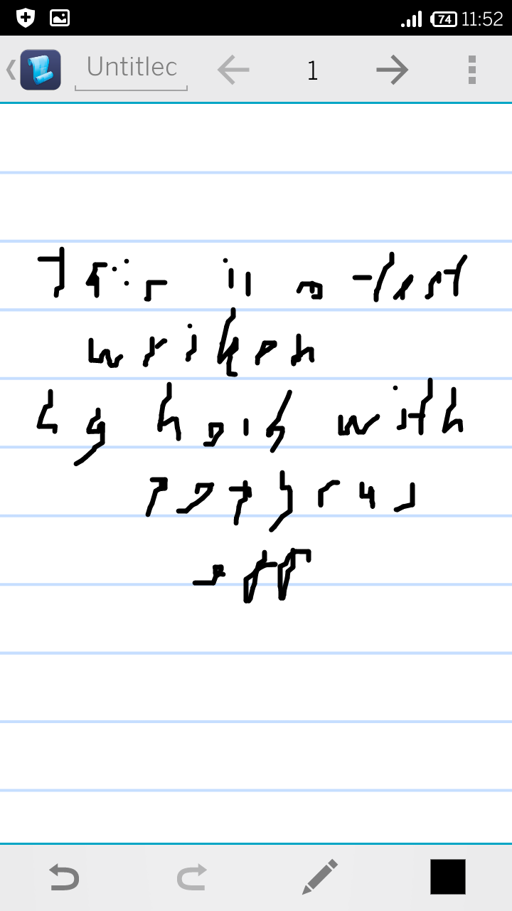

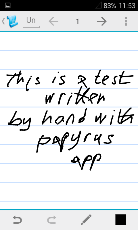

I made another little test, using Papyrus app, last version from playstore installed on:
- Xiaomi MI2S 32GB (4.3 inch display 1280x720px, android 4.1 stock MIUI 21.2.14)
- Samsung Wave S8500 (3.3 inch display 800x480px, android 4.4 CM11 developed and ported completly from scratch by others great devs, but previously I had the same touch feedback also with a CM10 rom);
Here are some screenshots after testing the app to write something with my finger on both the devices, note that the samsung is a 2010 device, with a significantly smaller screen that should make writings harder (writing with a finger on a phone is already an hard task..), lower resolution, with a rom developed by a couple of guys in their free time and that it wasn't an android device (it had Bada OS)... just to point out at least xiaomi bad driver optimization...
MI2S on the left, S8500 on the right:
RESULT: there is no competition at all, S8500 has way better touch accuracy and quickly response. It's very very hard to write something readable on MI2S because what is drawn on the screen doesn't match closely with the path touched (you can notice from the screenshots that the paths/letters drawn are jagged and incomplete).
