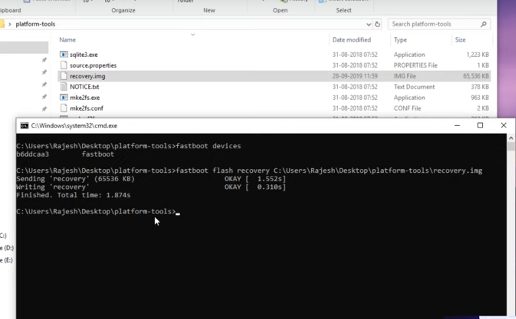

Problem solved:
branded cable from rock charges the phone, but pc can't recognise the phone
no name cable which i borrow from neighbor ....working
i use this steps, to overwrite twrp 3.3....with OrangeFox-R10.1_3-Stable-violet
  • Download the correct OrangeFox zip file
  • Extract recovery.img from the OrangeFox zip file, and copy recovery.img to your PC’s adb directory
  • Unlock your bootloader (skip if already done)
  • Install drivers and open up a command line window / terminal emulator on your PC
  • Next, switch off your phone and reboot to fastboot mode. [Press and hold Power+Volume down button together]
  • Go to the installed ADB Folder on your C drive.
  • Copy the recovery image file on the folder as well.
  • Now, press Shift key + right-click in the blank area inside the ADB folder.
  • You will see the open Command Window here option. Launch it.
  • Now, type the following commands in the command window and press enter:
  • fastboot devices
  • fastboot flash recovery (drag recovery file from folder here and hit enter)
  • when it is finished (look at photo 1) Press and hold Power+Volume UP button together]
  • Reboot in recovery by pressing vol UP + power keys till you will see OrangeFox splash (the keys may be may vary on your device)
  • After OrangeFox has booted up, check that everything is working – eg, that it has mounted the data partition successfully, and that the touchscreen works.
  • copy OrangeFox-R10.1_3-Stable-violet into your phone
  • Find and select the OrangeFox zip, tap on it, and swipe to install it (because OrangeFox Recovery needs some files from the zip)
  • After installation, the phone will automatically reboot into OrangeFox
  • Enjoy!

Fine!
