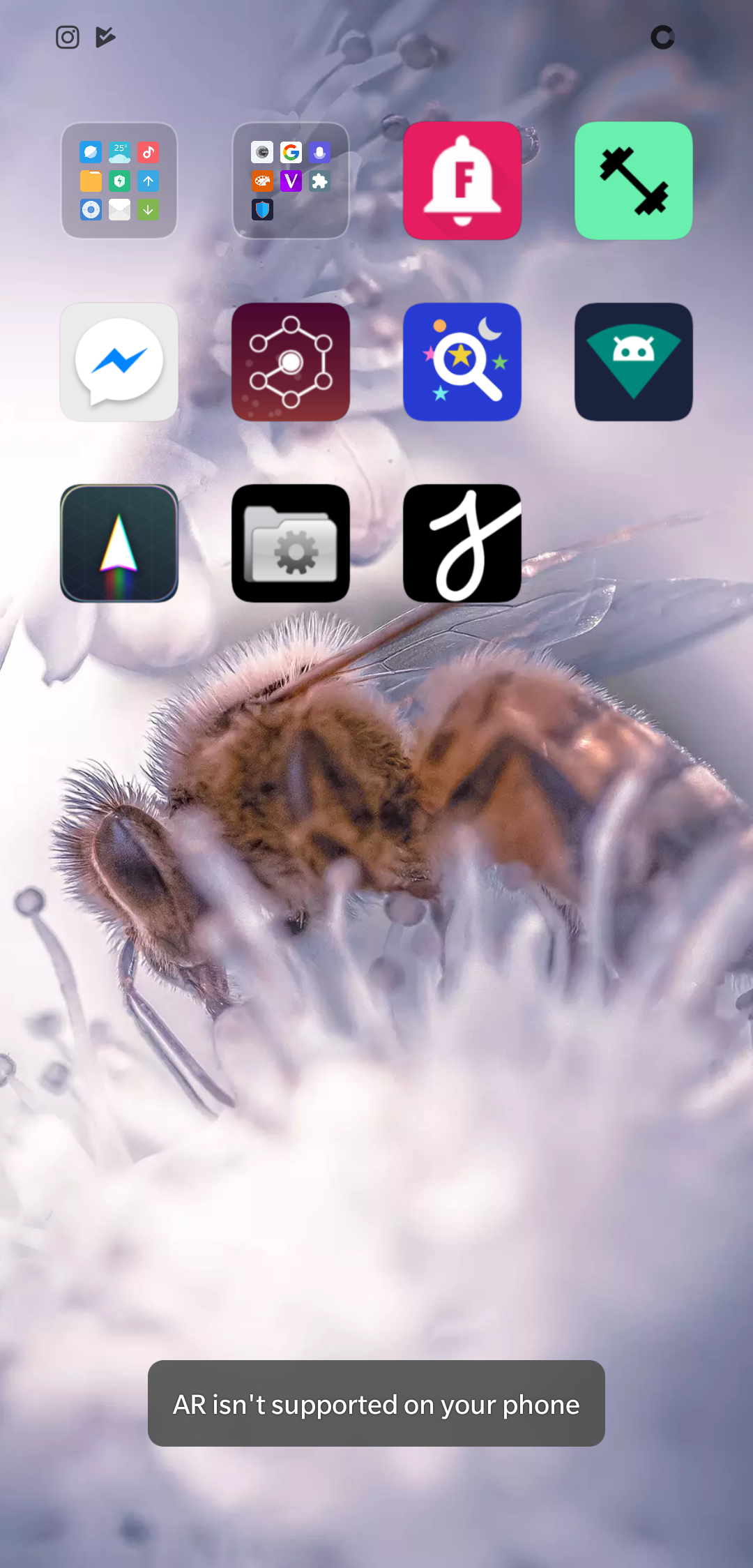

Has anyone been able to run AR apps on Mi8?
I've noticed that its ROMs come with ARCore app which gets updated regularly via play store, but whenever I download an AR app, it shows a popup that the device doesn't support AR. I'm pretty sure it does since it uses same SoC as other flagships.
Is there a fix to this issue

It works fine on global miui 9, but not on 10, I also get AR not supported. arnova's patch doesnt help either (worked on gemini)

I found solution for this. build.prop contained build fingerprint from mi6 instead of mi8. So look you have to look for ro.build.fingerprint=Xiaomi/sagit/sagit:.... and replace words sagit with dipper.
It works fine now

Brilliant! This works well. Next time Google should use other methods to detect ar compatibility instead of device names
I need root to access the file, correct? Will rooting break SafetyNet certification?
thanks for build.prob info, have found the wrong lines on the end of build prob.
arcore works now properly.
