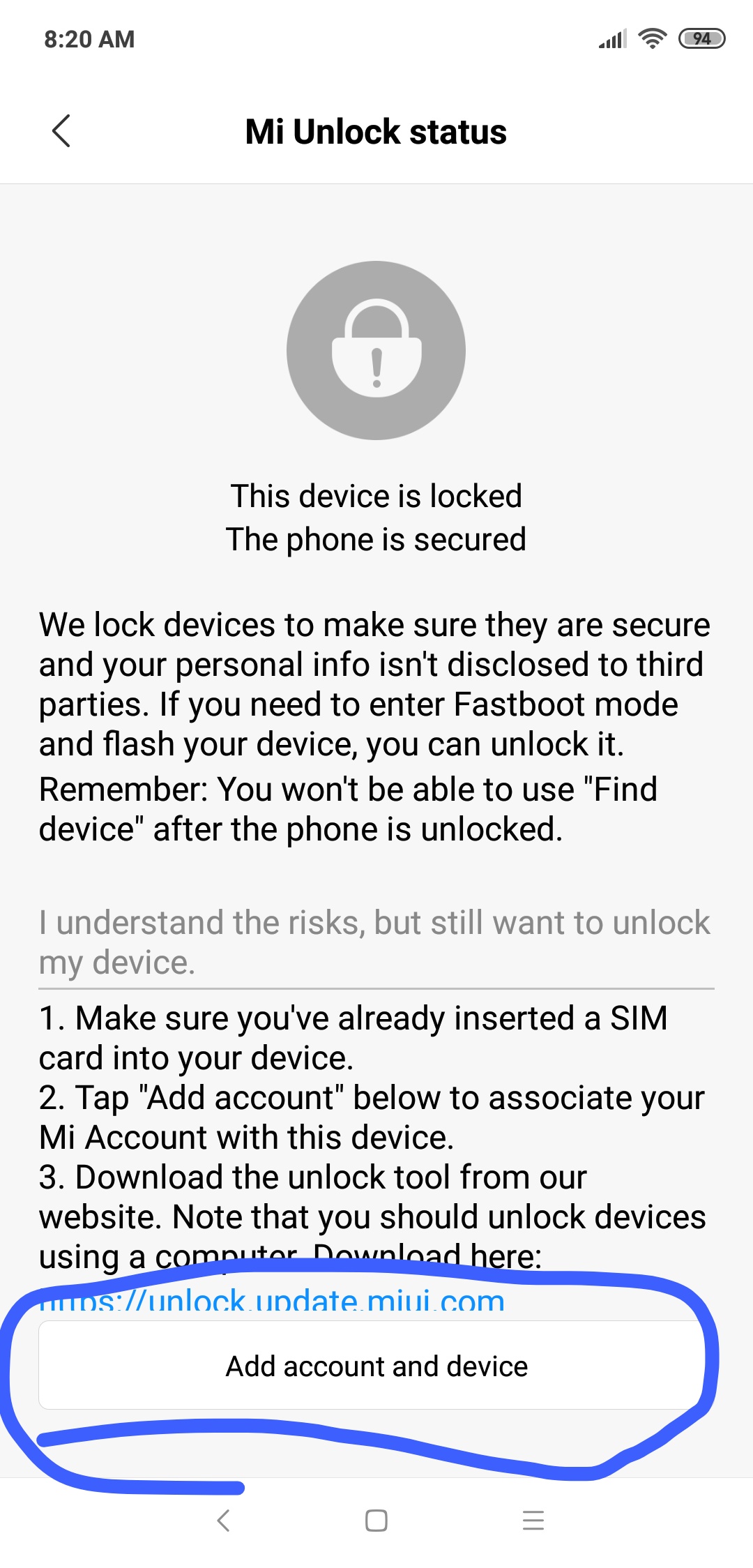

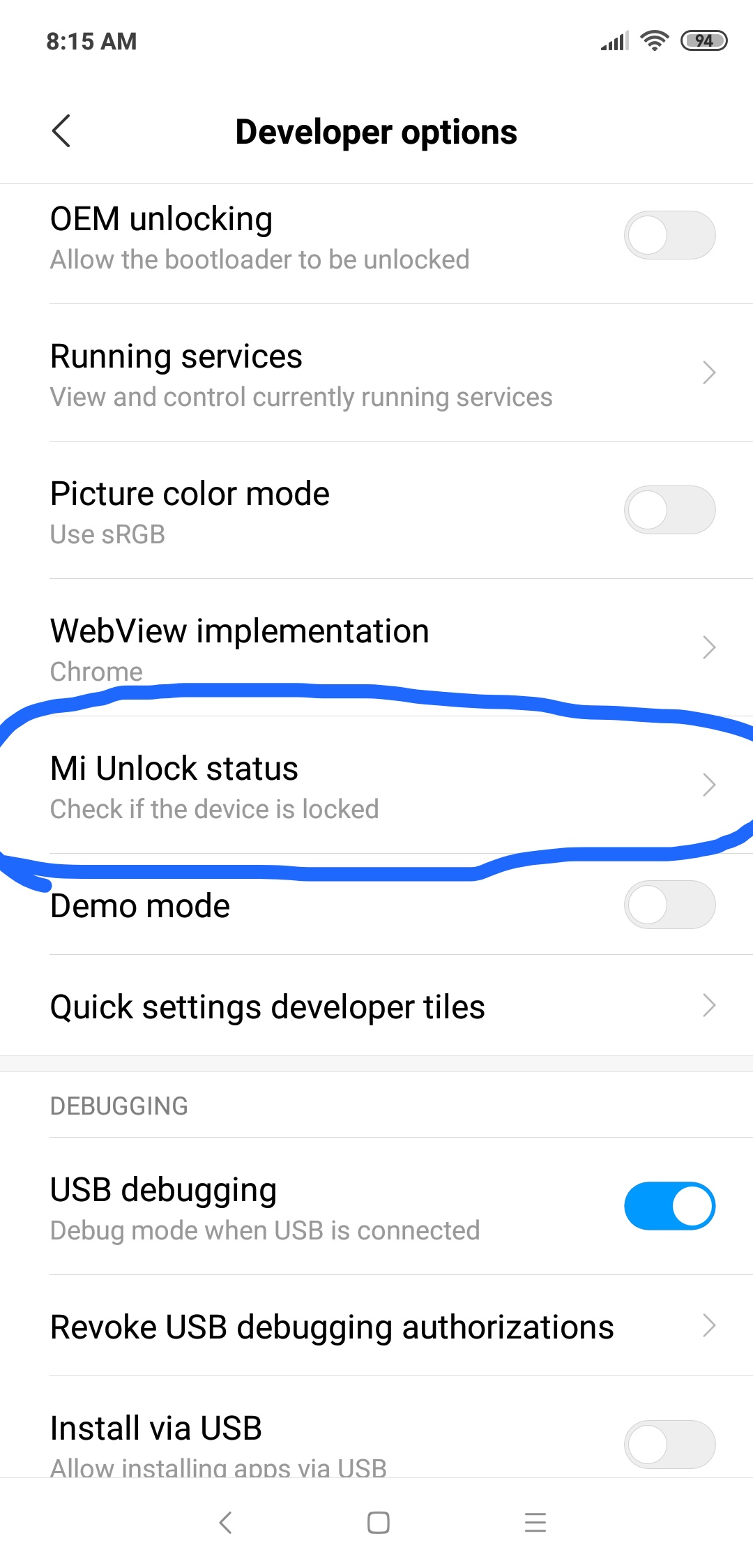

Unlock Developer Options. Goto to settings->About Phone. Click on MIUI Version seven times to unlock Developer Options. go back to main Settings. Click Additional Settings and look for Developer Options. Click on Mi Unlock Status and sign in with your account. Still have to wait 720 hours after signing up. Check the remaining time with the Mi Unlock tool.
