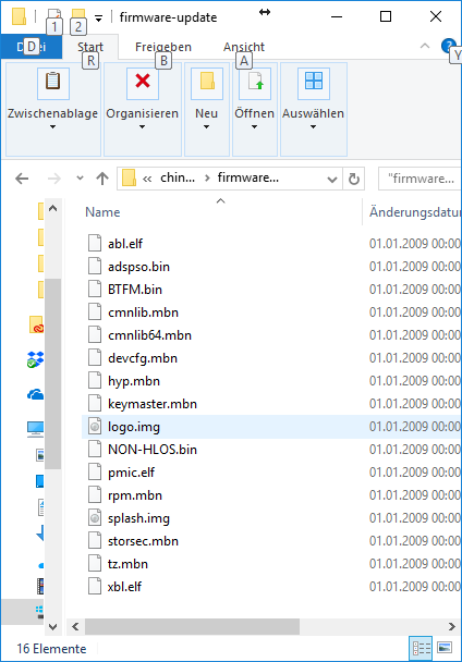

I Have me News Mi Mix 2 Bricked by Flash, in me PC is the Phone: Qualcomm HS-USB QDLoader 9008
Can i Flash the Firmware from China Rom without Bootloader/Recovery (Only Black Screen on Mobile Phone)

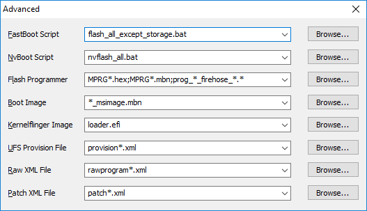

i have tested with 2017.4.25.0 "cannot receive hello packet" and then try to Reset status, after this abbort, not working...
The Version brings Syntax error for file and dirname (advancet settings Flash Programmer and more what is the settings?)

i have tested the other Mi Flasher, but the Settings? In other Phones have the zip mprg* the Mi Mix 2 have this not... What is the Settings?

I Have now unbricked with:
MiFlash 2017.4.25.0 and the Xiaomi Mi MIX 2 Latest China Stable Version Fastboot File @http://en.miui.com/a-234.html
But i have mor then one trial needed (and very mutch MiFlash Versions)
Yes its True, probably the other MiFlash Version no compatibily with the Rom from Mi Mix 2 but the Newer Version is it(after more try :-D)
