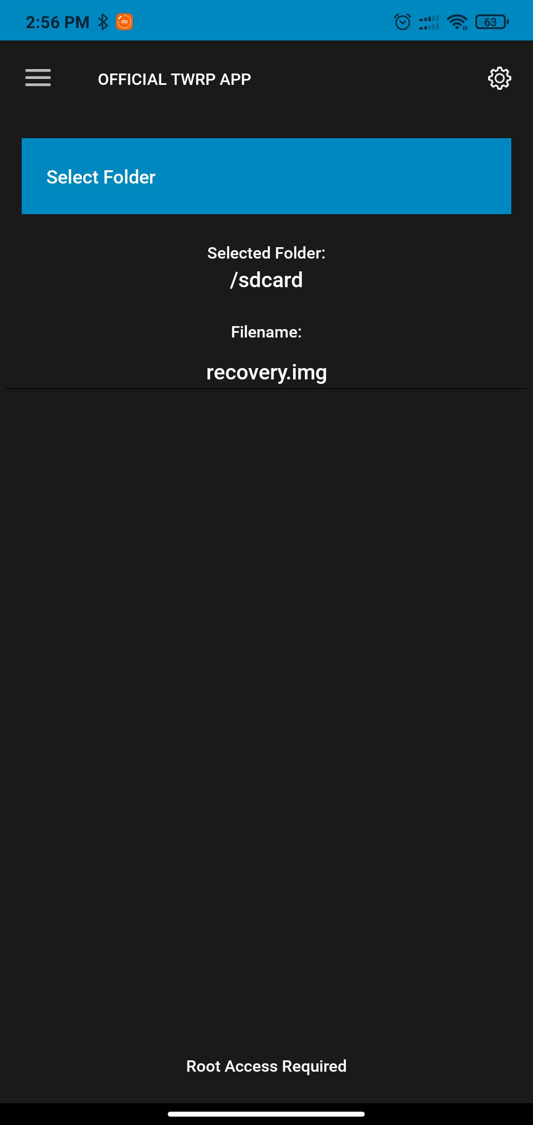

So I'm doing something wrong.
As you can see in the print, when I try to do the backup it tells me that I need root.

Don't use the twrp official app. Unlock your bootloader first. Boot to twrp. img and backup your data. Use ADB command or Fastboot/adb tools to do it.
slaihk
Jan 9, 2021
52
However, when you unlock bootloader you probably will lose your data. So back up your data like videos or music files to PC first.
