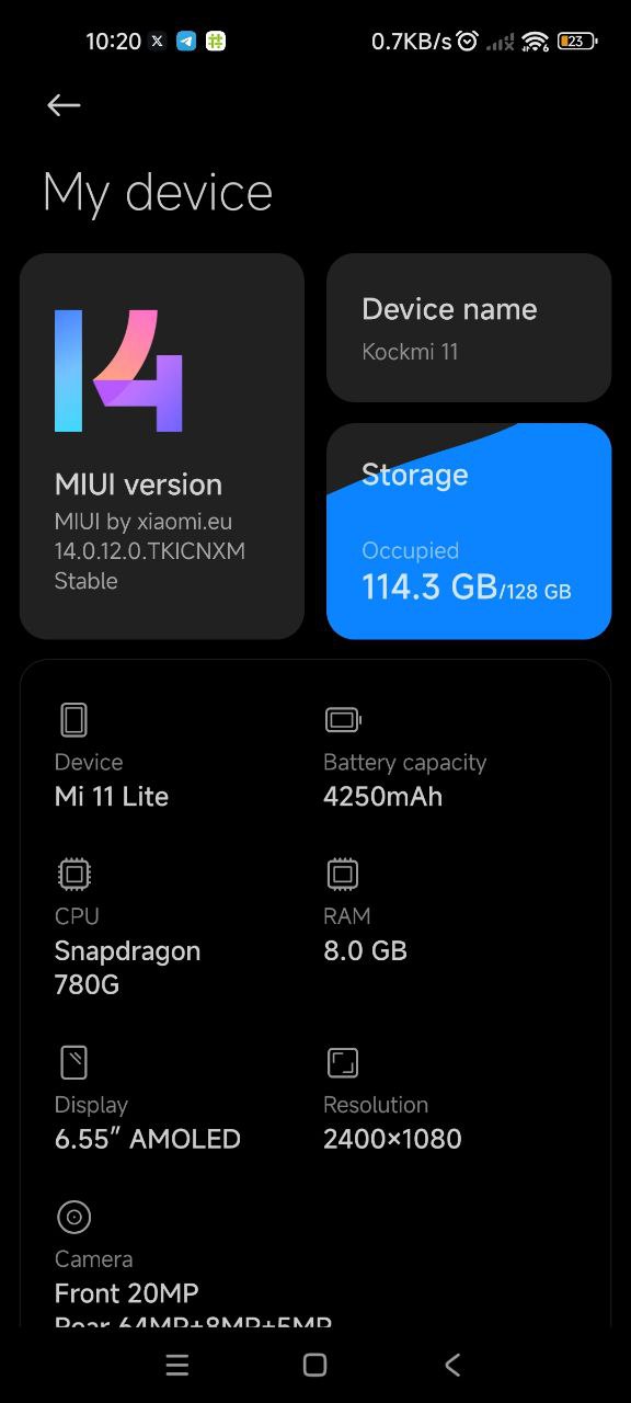

I have a Xiaomi 11 Lite 5G (renoir), I was on 12.6 EU Rom and usually living in Thailand. Since I got back to EU (Germany) for holidays, my phone wont connect to any network anymore. I have since updated to the newest available ROM from EU team (14.0.12.0) however, the problem persists. It is definitely a software issue, after I had the phone still in 12.6 and had my broken power button repaired, the network worked until I restarted, then back to the same issue.
I have searched the Forum and have seen other people and models had similar issues, with the recommendation to flash the modem.img file or the NON-HLOS.bin via fastboot using the images from official ROM. I tried using the modem.img from this rom http://xmfirmwareupdater.com/miui/renoir/stable/V14.0.7.0.TKIMIXM/ however, there was no modem.img file. I went to look for the firmware, found this one which had the modem.img http://xmfirmwareupdater.com/firmware/lisa/stable/OS1.0.5.0.UKOEUXM/, but when I flashed it my device went into bootloop. Was able to just reflash the 14.0.12.0 via fastboot and get the phone back, but still no network. I am a bit scared to brick the phone, so I would like to ask if anyone could confirm which files I should flash, and from which official rom. Maybe Modem.img from new official firmware is incomatible with the 14.0.12.0 stable? Or maybe I also need the NON-HLOS file?
Any help is greatly appreciated. I have attached screenshot from my current device version and you can see there is no network at the top.
