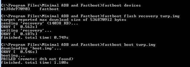

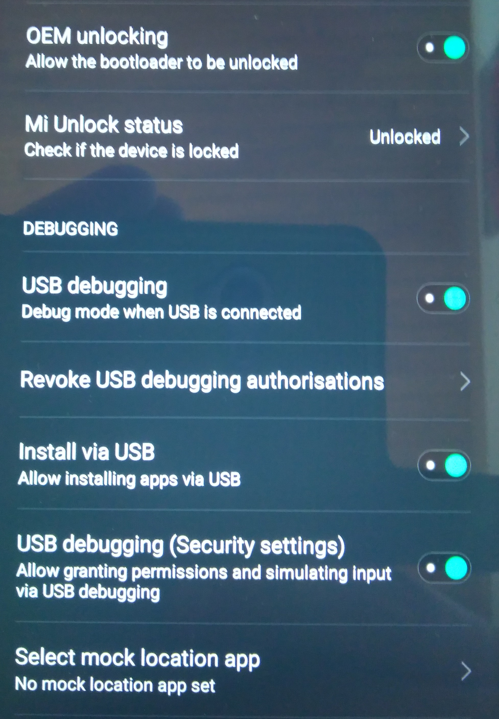

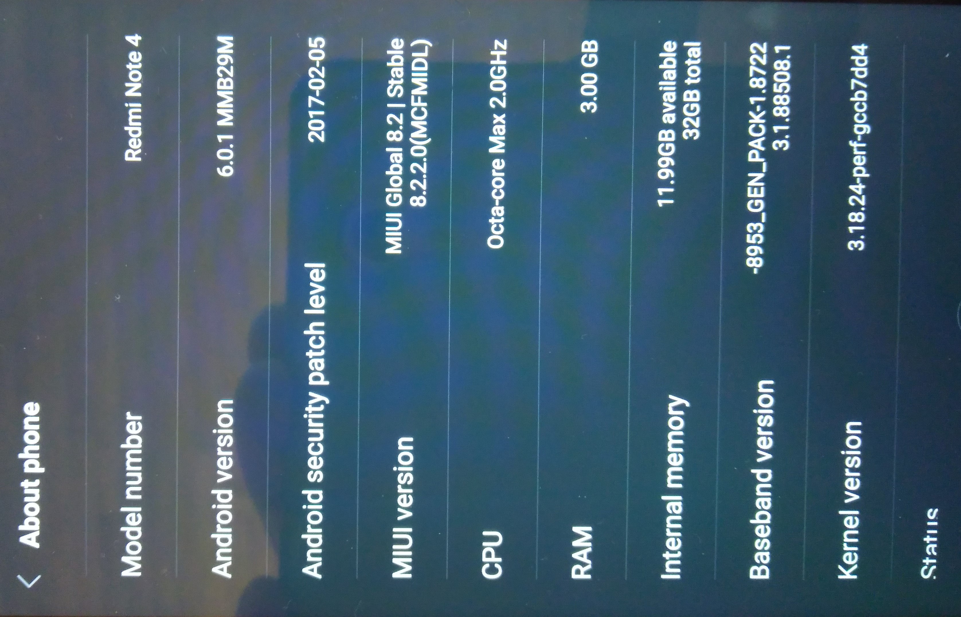

I have a Redmi Note 4 with unlocked bootloader. I have tried all sorts of drivers. The default google adb drivers, the redmi note 4 drivers etc.
He detects my phone in fastboot, but gives error FAILED (remote: dtb not found).
Afterwards I can't boot into recovery mode.
Please help.

Your installation went fine as I see. Also you made a mistake trying to boot it. It's fastboot boot recovery TWRP.img .

No, first install:
Then boot:
fastboot boot twrp.img

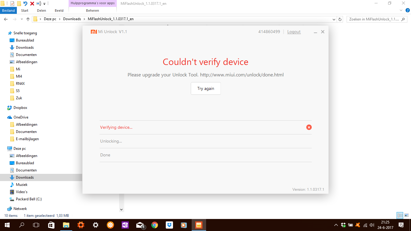

Hello, i think flashing in edl mode is not needed. I flashed again with normal fastboot mode, but this time on "clean all and lock". This did it. I had to combine the RN4X with my Mi account before unlocking. Mi unlock app gives message i have to wait 72 hours. So, in 3 days i can unlock and install twrp and flash the wanted rom.
Thanks again for your help. "clean all and lock" was the solution. Learned again.

Yet another question;
Do i have to wait 72 hours for official unlock with Mi Unlock app or can i just now unlock the device with "fastboot oem unlock-go"?
Or is that no good?
They must find out, that it worked with v1.1 without waiting. I unlocked my wifes phone last month without waiting :)
