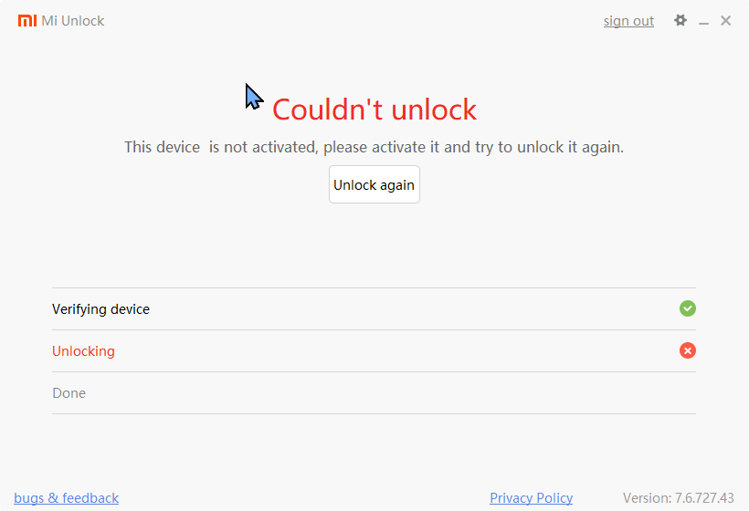

Can't unlock bootloader, can't associate account to device in developer options
Look how useless Is nc unlock, trying tò use him since two years, so I can't unlock chinese? I take It like It Is or trash It for a Xiaomi global?

Check here that it is a Global version:
and here the location and sim are activated:
On the phone's Xiaomi account, devices/current device/locate device or if synchronization of calls and SMS is possible in cloud synchronization.
real xiaomi phone, i validated on the web and all activated

i factory reset the phone, use another account i have but when i need use mi unlock require a sms code, the number has problem with that, i will try tomorrow
Currently, a lot of problems with this validation SMS.
yep, but maybe its a problem with the account, lucky for mi i have 2 accounts of many years, for no waiting 30 days
It was an old bug that came back recently, I couldn't activate my account after trying an AOSP rom even though everything worked before.

After trying several times with the same account, I decided to change to another one that I had created years ago, I factory reset the phone and started everything with the new Xiaomi account, after 4 days it let me unlock the bootloader
