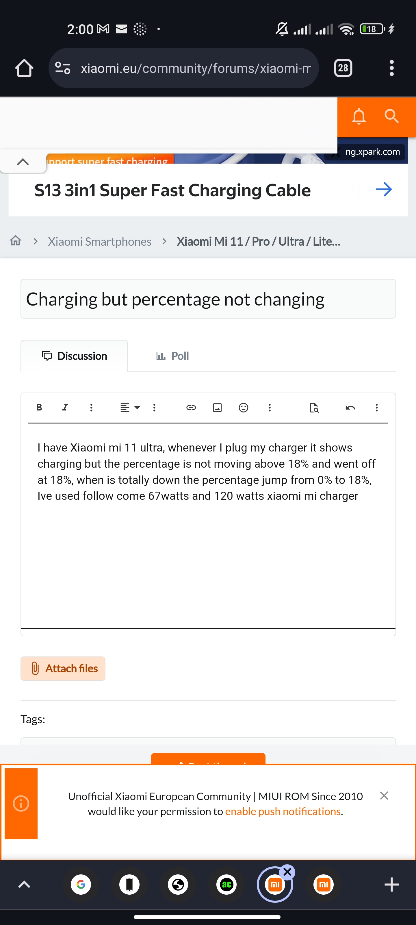

I have Xiaomi mi 11 ultra, whenever I plug my charger it shows charging but the percentage is not moving above 18% and went off at 18%, when is totally down the percentage jump from 0% to 18%, Ive used follow come 67watts and 120 watts xiaomi mi charger
Please any solutions... Ive performed factory reset and clean the charging port but atill the same
