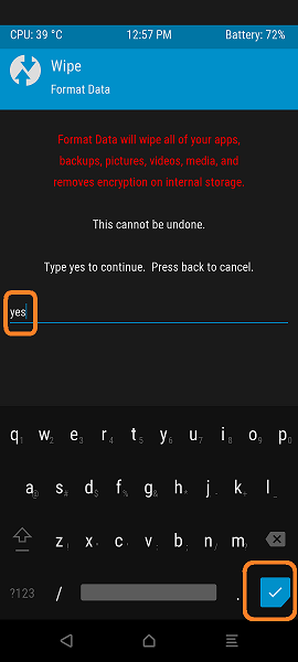

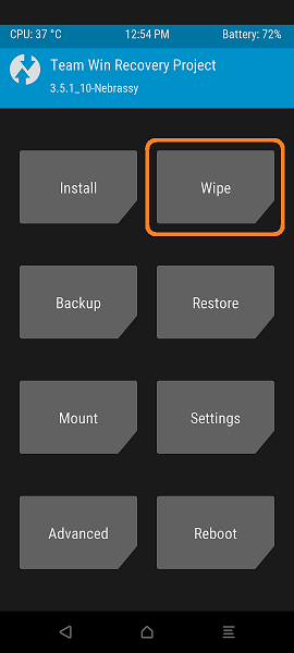

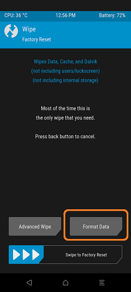

Only Format Data = Erases everything from the phone + formats partitions.

- Format Data
- reboot to recovery (TWRP)
- insert ROM into phone via USB
.Otherwise, the ROM will be deleted from the storage.
