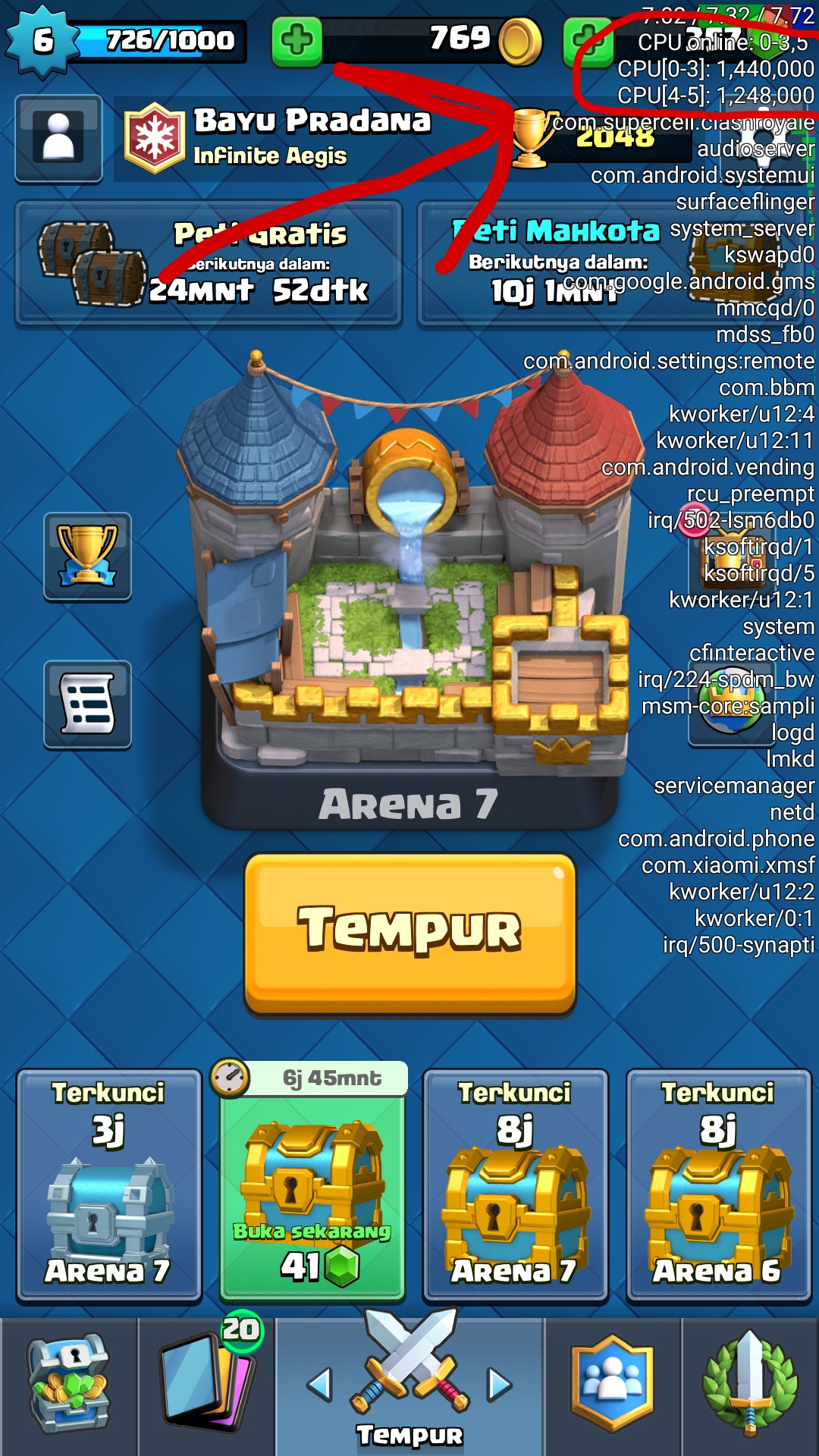

Enable your "Show CPU Usage" in Developer Options.
Look...

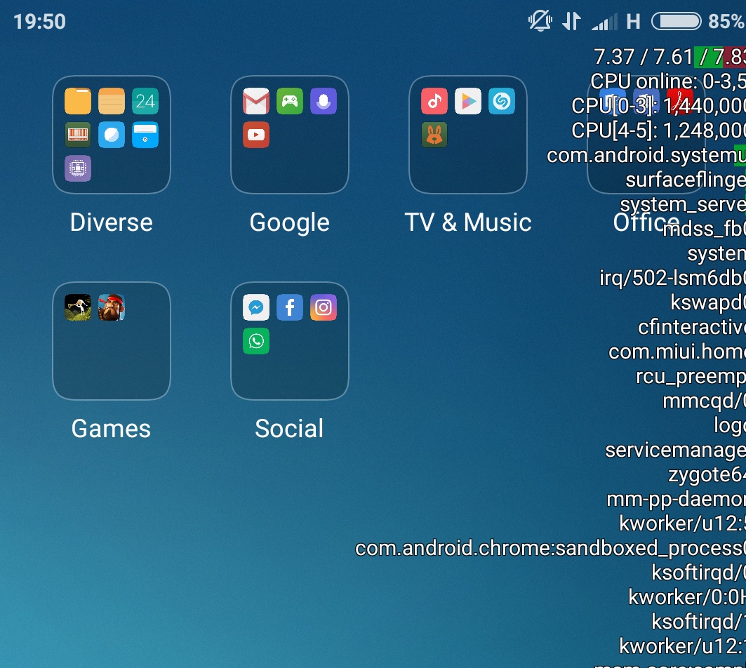

I am on MIUI 8.3 7.2.23 (Android N)

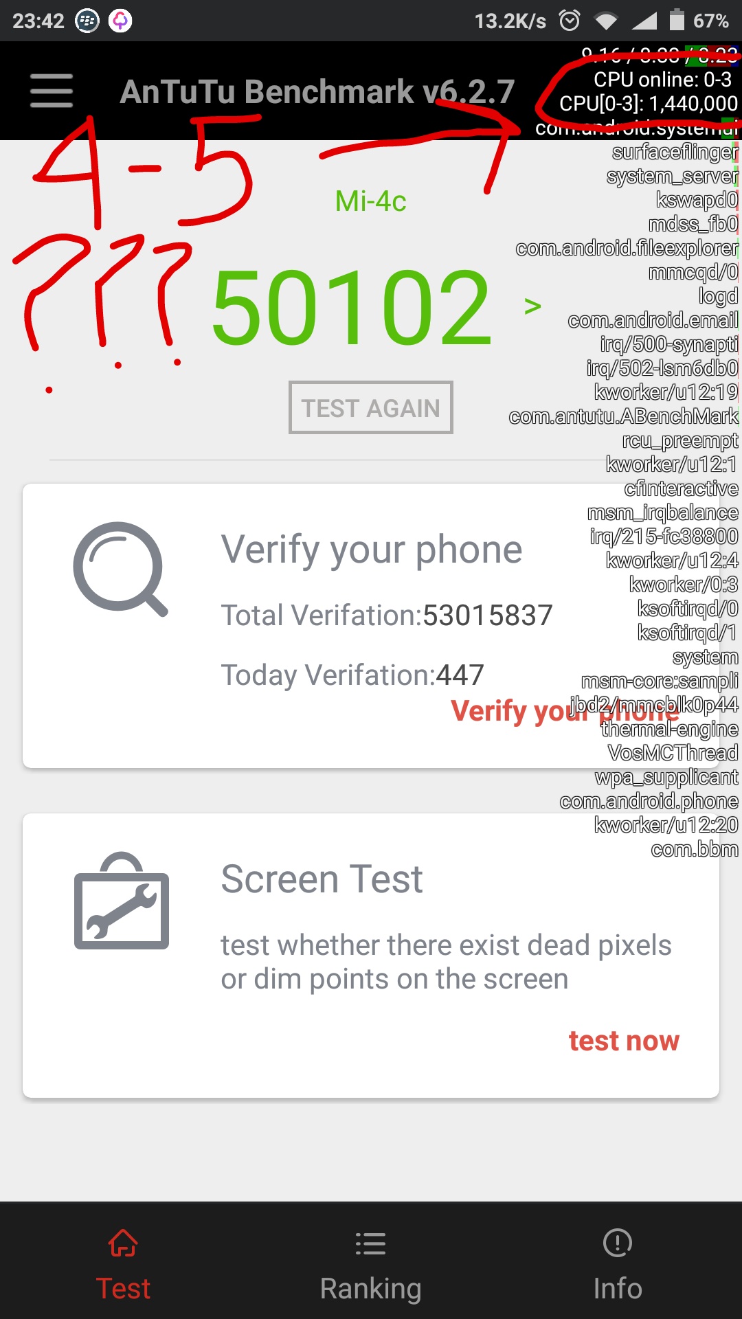

Don't know what to say.....Miui 8.3 7.2.16 beta.

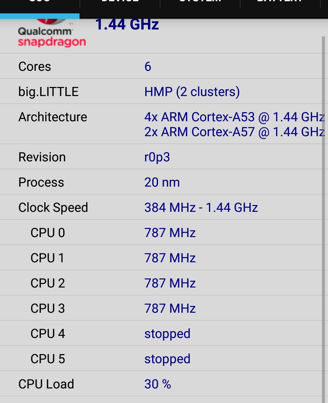

In simple terms, mpdecision service is watching the load on your device! When you'reonly doing simple stuff like browsing, texting or listening to music, the mpdecision service will completely shutdown single CPU cores to reduce power consumption. When you start games or other heavy processes, mpdecisionwill bring back online all your cores!
