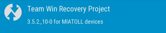

Available Android 12 recoveries for Redmi Note 9 Pro:
Orangefox recovery 11.1_X_A12
-> Required for the latest ROM versions based on Android 11/12
-> Latest version:OrangeFox-miatoll-stable@R11.1_4_A12_FBEv2.zip zo 27. September 2022
-> Download: https://orangefox.download/device/miatoll
Author dungphp
Latest versions:
"TWRP-miatoll-12.x-13-FBEv2-21102022.zip" from Oct 21, 2022
"TWRP-miatoll-12.x-13-MIUI13-FBEv1-2110202.zip" from Oct 21, 2022
download: https://androidfilehost.com/?w=files&flid=321133
-> Download install ZIP file -> install it from old TWRP

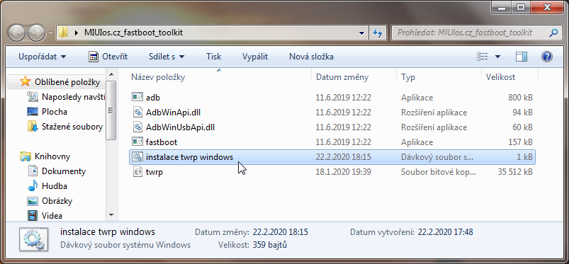

- Unzip the downloaded toolkit from the archive and insert the toolkit folder directly into the root of the system disk, add recovery to this folder, if recovery has a different name, rename it to twrp.img (if the downloaded recovery is also archived, unzip it to get twrp.img file)
38070
The file name must be twrp.img !!!
- Turn on the phone in FASTBOOT mode (start phone by holding together Power and Vvolume- keys) and connect it to the PC (in the Device Manager verify whether you have the appropriate driver for Fastboot mode - Android Bootloader
38071
- Run it in the toolkit directory "instalace twrp windows"
38072

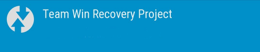

- Press any key (e.g. Enter) in the next black window
38073
- Will appears this window:
38074
- If it is written there "Instalace probehla uspesne", the installation was successful
- Now Disconnect the cable from the phone
- Launch the phone by simultaneously pressing and holding the Power and Volume + buttons
- Phone will start to new revovery
38075

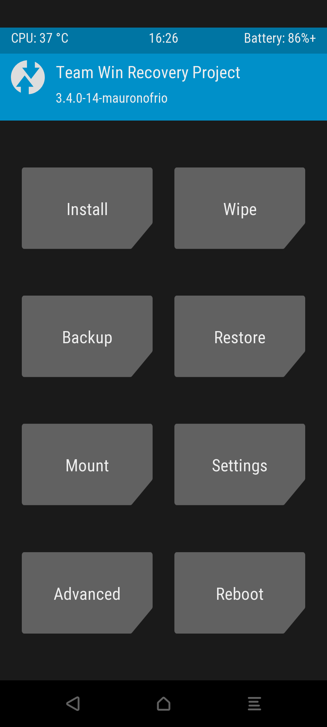

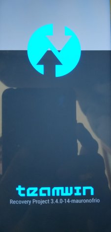

TWRP 3.4.0-14 by mauronofrio (developer working with official TeamWin Recovery Project)
-> Author's XDA pages
-> multilanguage
-> universal version usable for models Redmi Note 9S, Redmi Note 9 Pro, Redmi Note 9 Pro Max and Pocophone M2 Pro (Curtana, Joyeuse, Excalibur, Gram)
Mauronofrio's TWRP download folder: https://sourceforge.net/projects/mauronofrio-twrp/files/Curtana-Joyeuse-Gram-Excalibur/
For Joyeuse download latest file for Curtana
It works well for me
Installation instructions for a new phone:
- Install from old TWRP -> Install / Install IMG / select IMG file TWRP / select Recovery partition / Swipe to confirm
- Restart to Recovery
or
-use instructions from Author's XDA pages

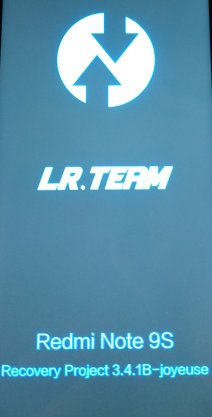

LR.TWRP 3.4.1B 0530 by russian
pages1 and pages2
-> made by modifying LR.TWRP for Redmi 9S
-> english /russain languages
-> multilanguage made from en/ru version by Cuvetto

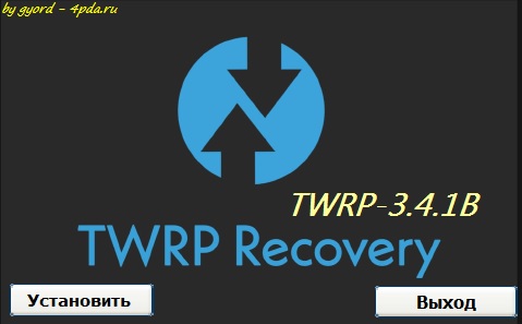

b) by first type automatic installer, using an EXE program in Windows
Download autoinstall EXE:
a) https://uloz.to/file/qidj7XRHX6wm/joyeuse-twrp3-4-1b-autoinstall-exe
b) http://www.mediafire.com/file/huff14m4s8lbbz4/joyeuse-twrp3-4-1b-autoinstall-.exe/file
Instructions for install Twrp with automatic installer:
0 -Back up all your data (photos, videos, files, etc.), the whole phone will be deleted
1 - The phone must have the Bootloader unlocked
2 -You need to have drivers installed (you probably already have them when you unlocked Recovery - they are packed in a ZIP)
3 -Restart the phone to Fastboot mode (turn on the phone by holding down Vol- and Power), this picture will appear on the phone
4 -Run the file "joyeuse_TWRP3.4.1B_autoinstall.exe" on your PC
5 -Now connect the phone to the PC and click on "Установить"
6 -Installation will take place, a black text window will open where you have to press Enter several times
7 -Close the program window on the PC by clicking on "Bыход "
8 -After installation, hold down the Power button to turn off the phone from Fastboot mode
9 -Turn on phone by pressing at the same time Power and Volume+ buttons, until phone will vibrates, then release the buttons.
10 -When the TWRP starts up for the first time, you need to immediately click on the language setting button and select English
11 -Then setup your TWRP, time zone, etc.
