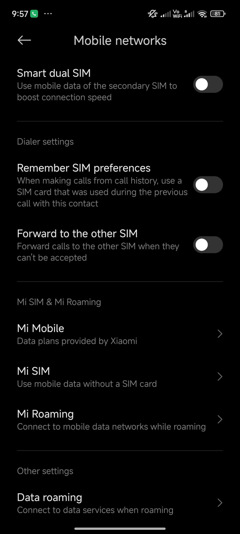

Also there are settings that allow you to add an "Mi SIM" branded service under SIM settings that has all the functionality of an eSIM but the carrier is locked to Xiaomi on CN ROM at least, how is this possible without the hardware existing?

Please, can you clarify this point for me? Is chip customization of the Xiaomi 14 houji, CN version BL unlocked and European OS, without eSIM? Is it an hardware customization? Or software? If it is software, is there any update for using eSIM on houji?
eSIM support as well as band support is a HW issue.
For example Xiaomi 14 CN version:
Does not support eSIM, does not support B20 LTE band = it is not possible to make these functions available through software.
