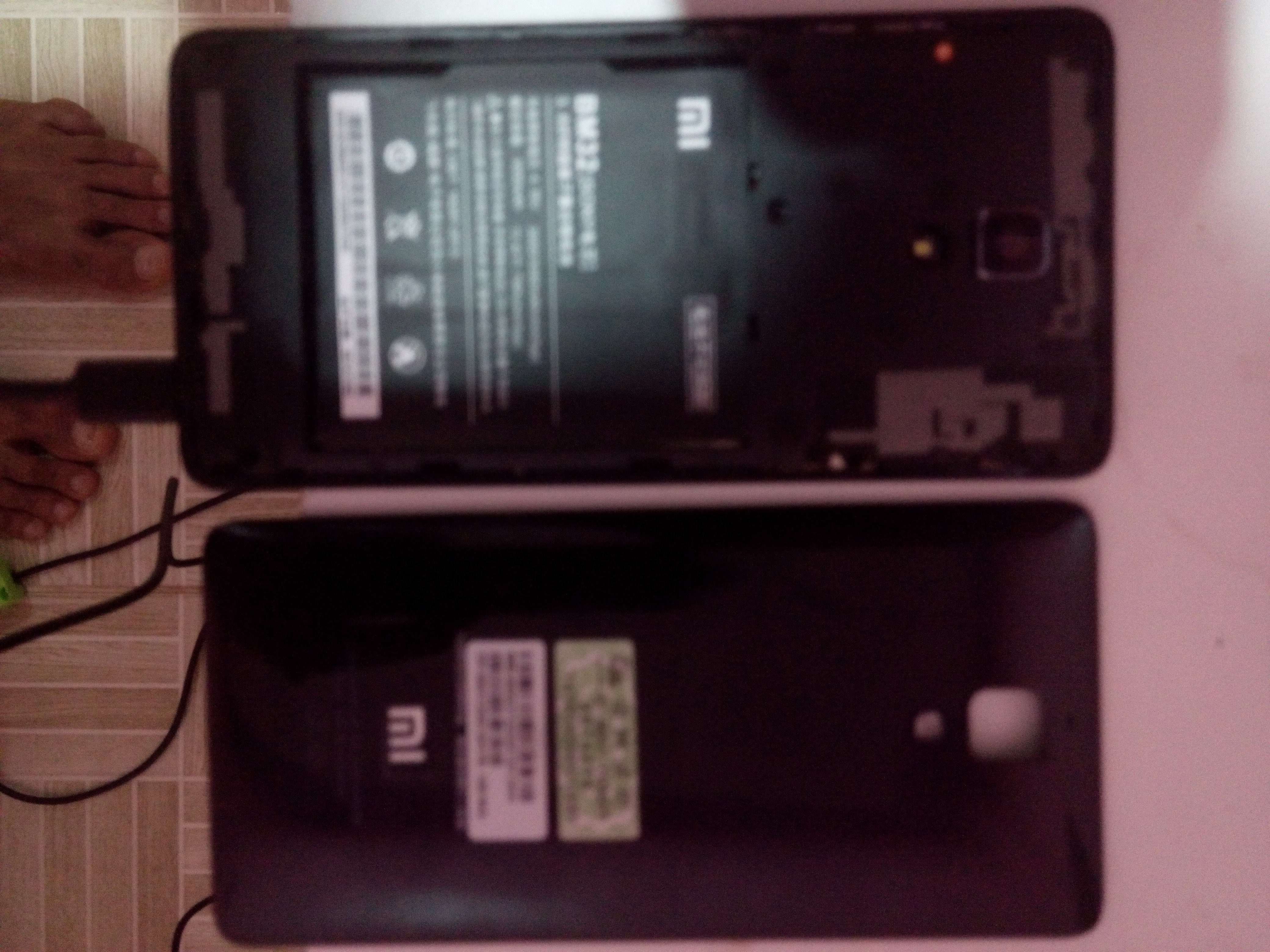

I bought a MI4 TD-LTE and can not go into fastboot mode device.
When I turn him holding VOLUME UP appear three options: normal mode, recovery mode and fastboot mode and says OK is to press VOLUME DOWN but does not work.
Checking IMEI doesnt prove anything.
Just tell us where did you buy this device and for how much?

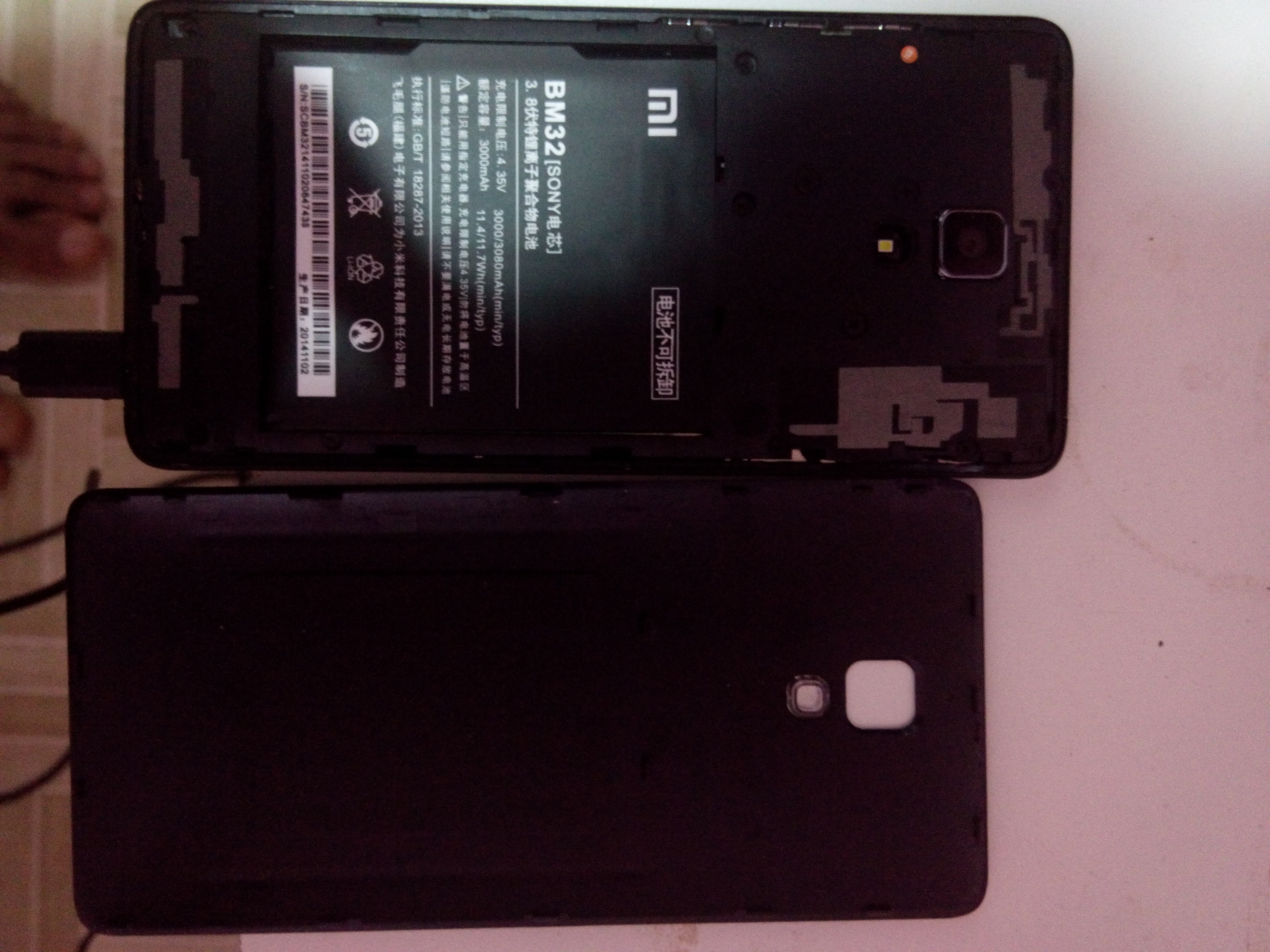

Take off battery cover and post a photo of whats under the cover.
Bought by aliexpress.com and already checked all the items that demonstrate the device's originality and mine has them all.

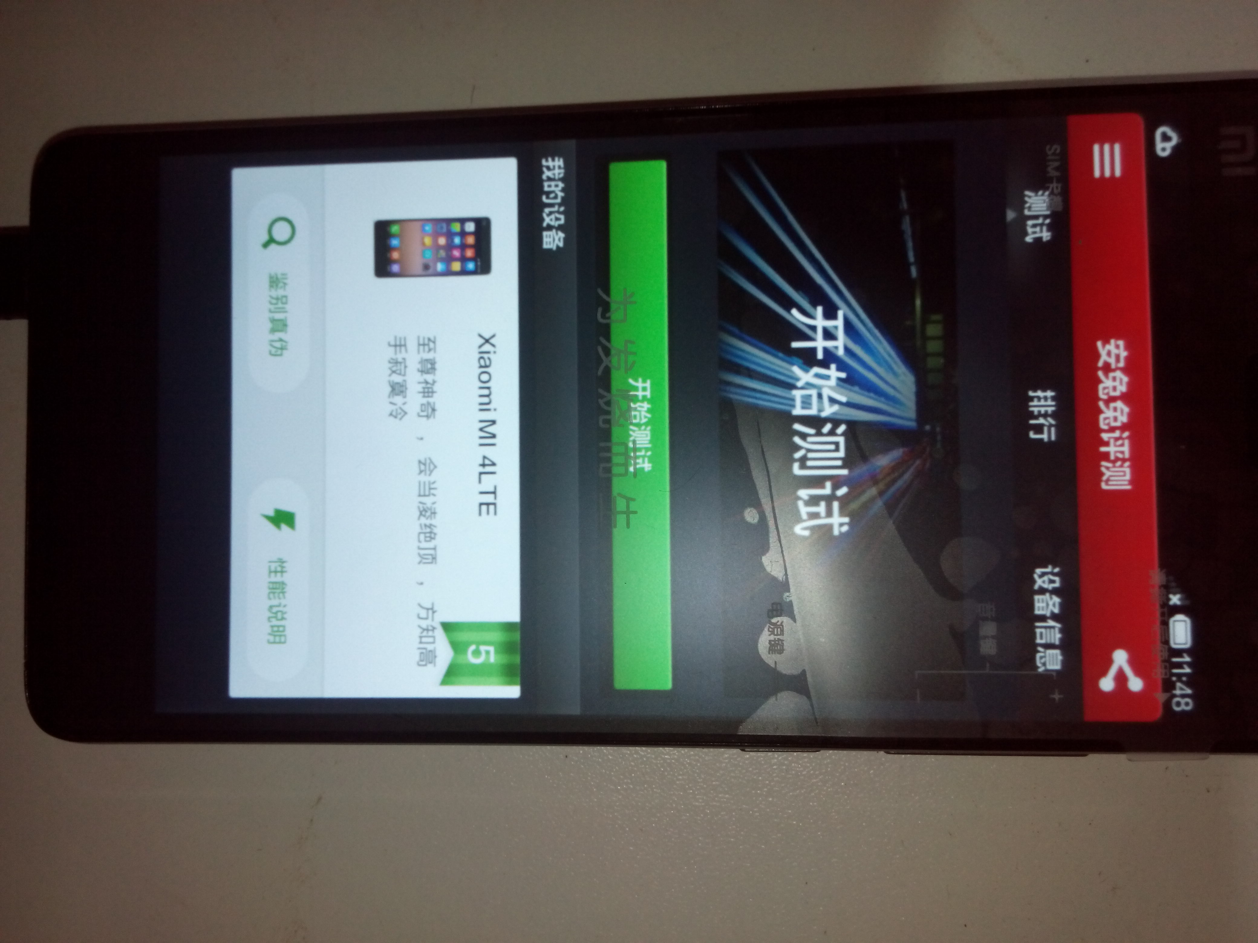

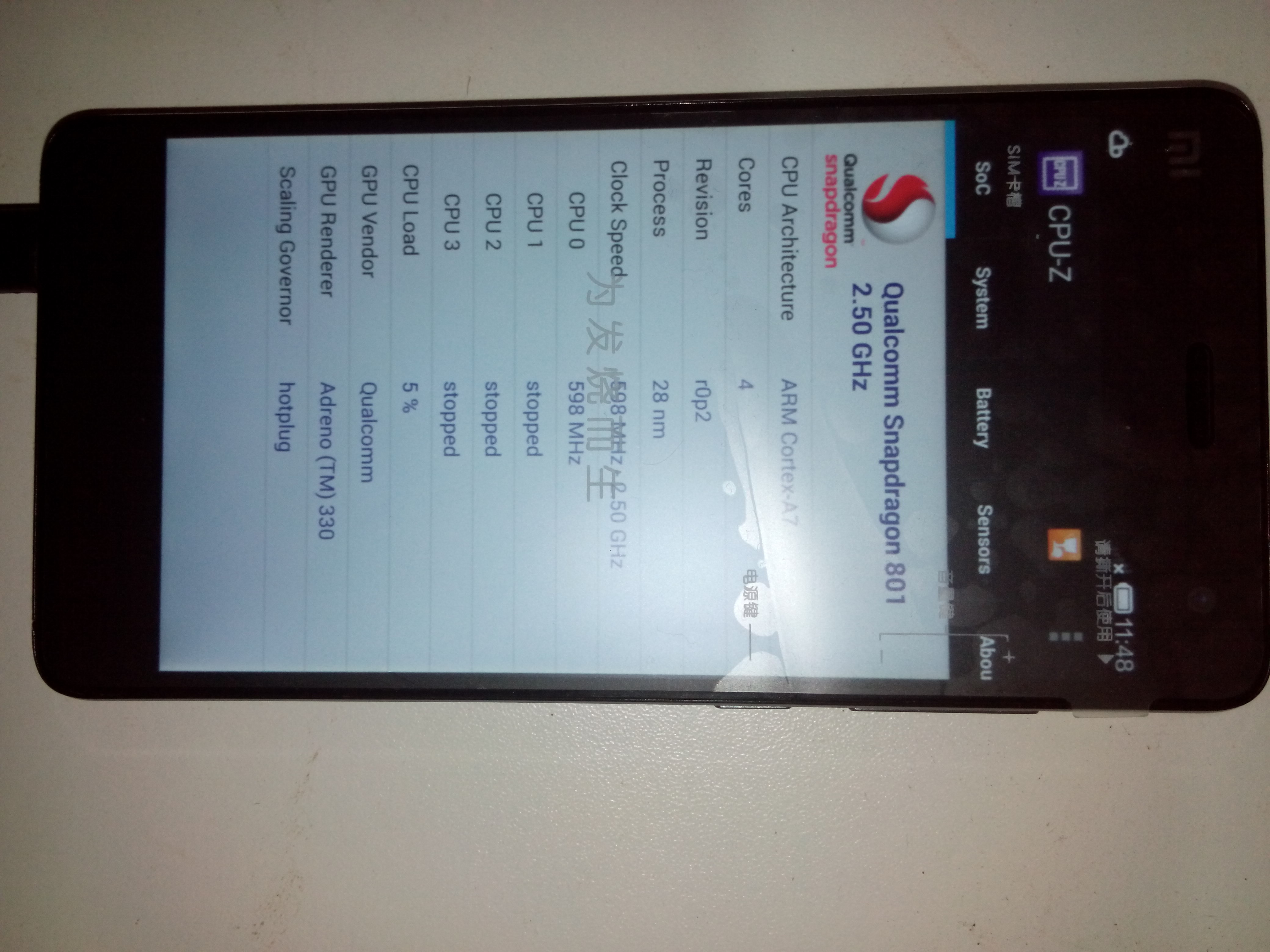

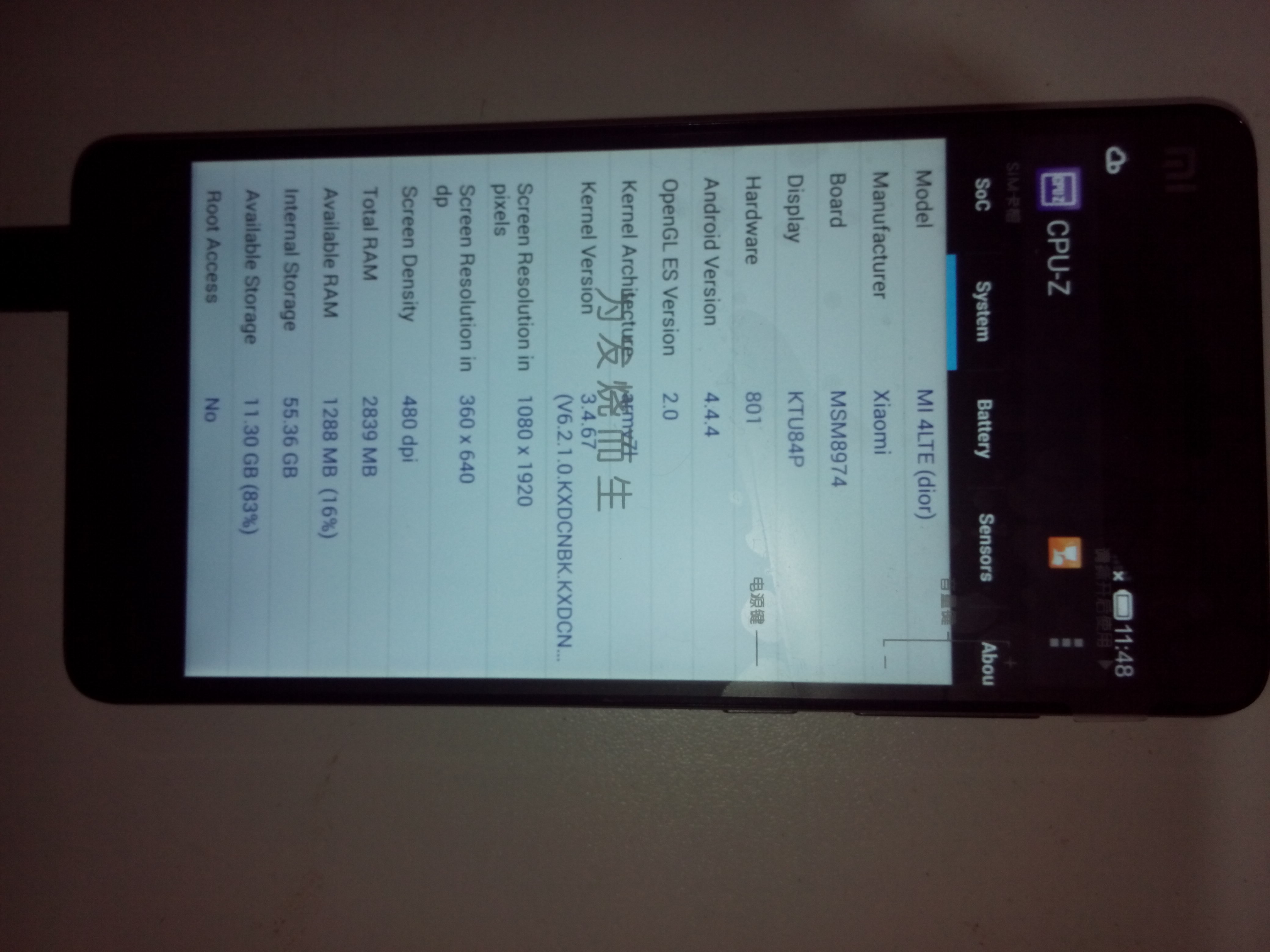

Anyway, post photos of the device, the CPUZ and AnTuTu for you to check.

Of course its fake.
Take a look for specs. These are not right:
- MI4 LTE (dior)? Dior? MI4 is cancro, not dior.
- Open GLES version: for MI4 its 3.0
- CPUZ shows version: V6.2.1.0... well this is a number for MIUI 6 version. But from photos we see you have MIUI v5.
Also new MI4 LTE models are sold already with MIUI 6 - NOT MIUI v5.
- CPU governor hotplug? Lol... Only MTK devices have hotplug governors. MI4 should have Interactive.
- Minimum CPU frequence: 589 MHz. Wrong. MI4 has 300 MHz for min freq.
- and for last: Recovery. MI4 comes only and only with MiRecovery when you access it from volume up key + power.
You wanted to safe that few bucks and buy from alishit stores. Good choice.
Now you have a cheap imitation and you can't do anything with it.
