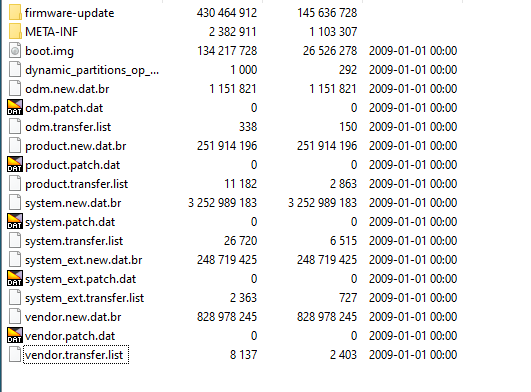

In the rom folder are these items
2222444-png.40146
This is not MIUI 13 xiaomi.eu ROM
If you are using the official xiaomi ROM contact the official forum.

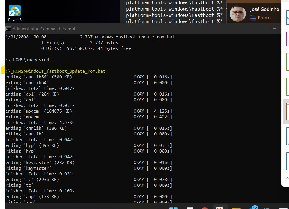

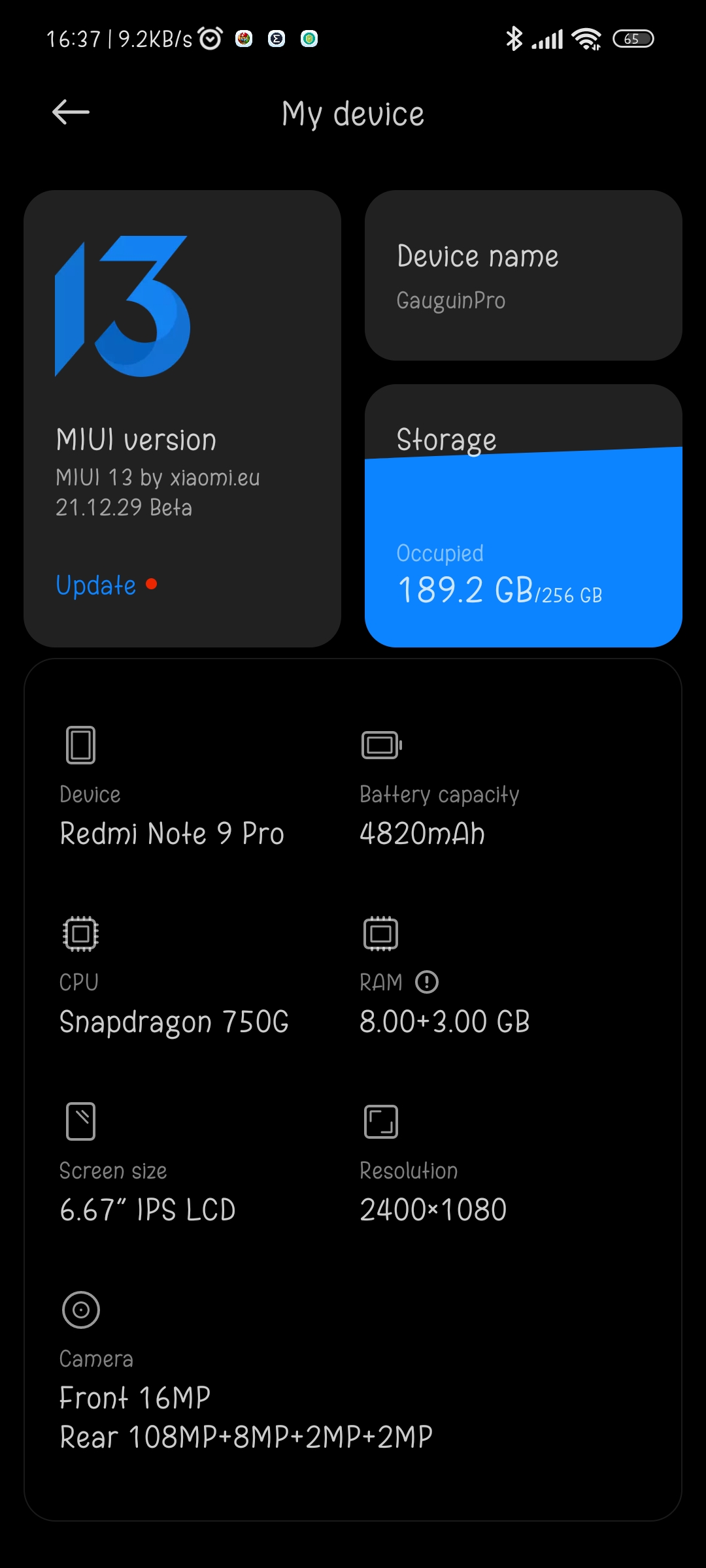

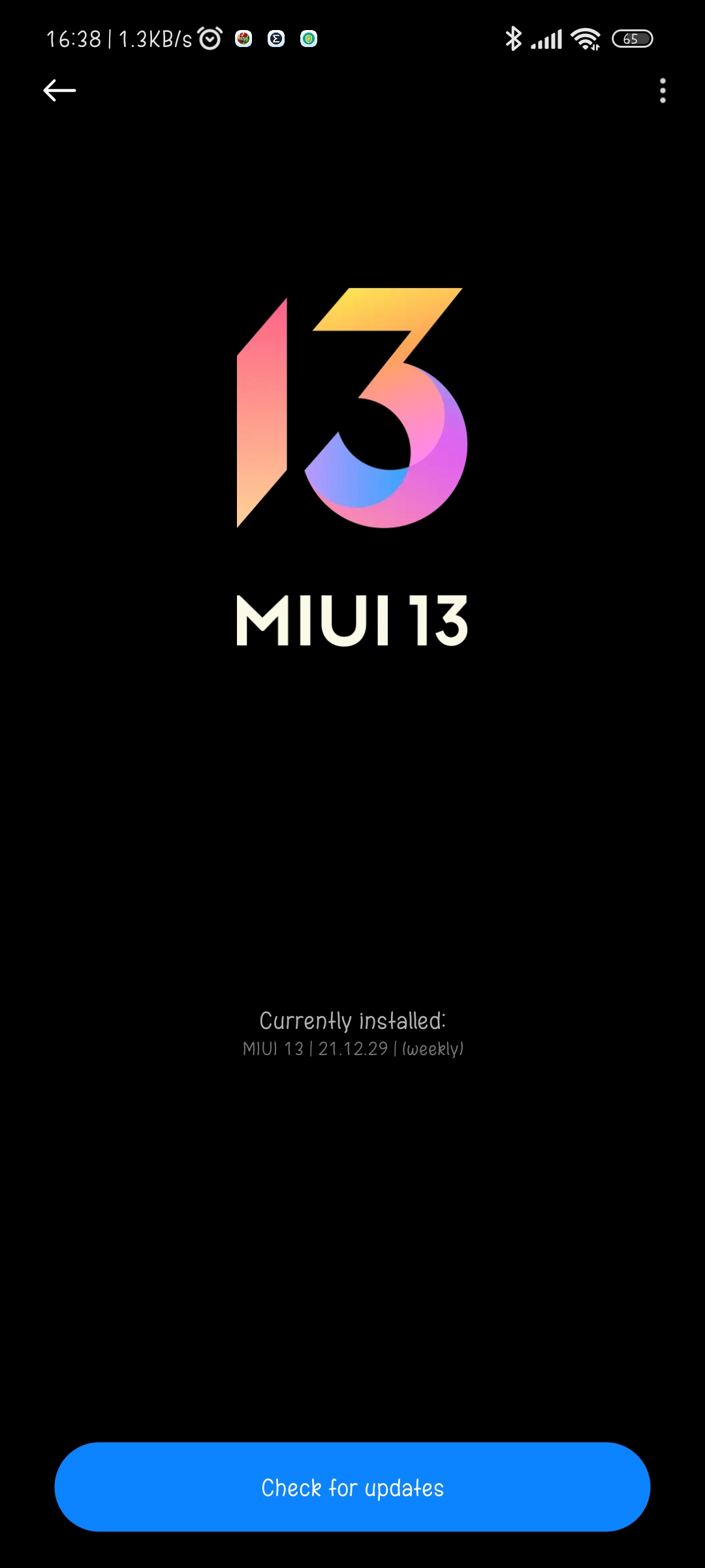

extract the rom in windows,
device in fastboot mode,
run the chosen .bat (new install or update)
wait for the device to reboot.
a longer boot time is normal.
enjoy.
