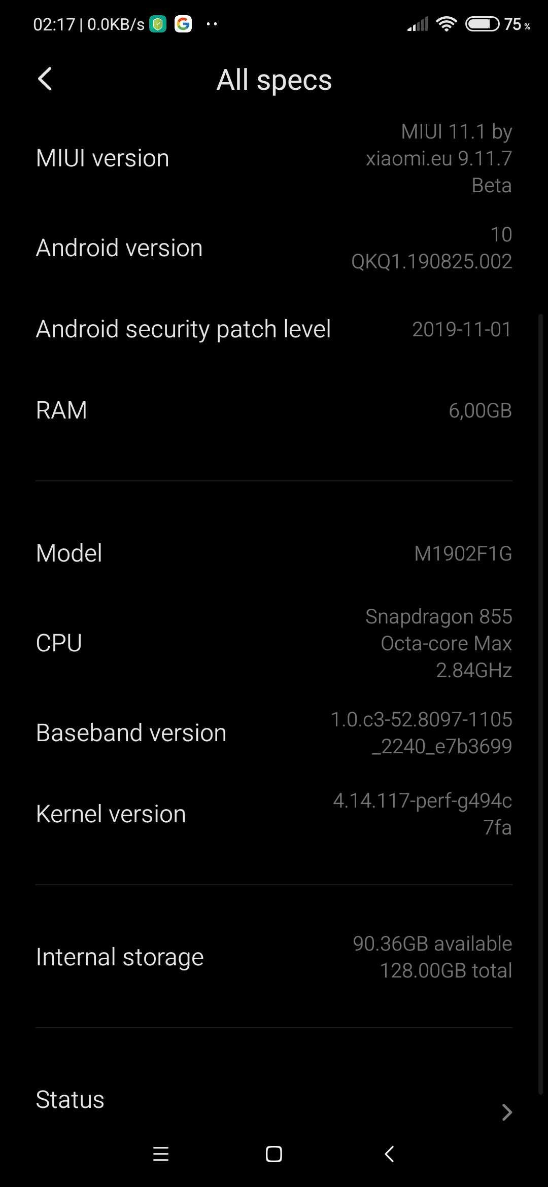

In settings, my device, all specs:
There is a G at the end of Model number. In my case of Mi9:
27125

Yes have to check they really promote a GLOBAL version. Must be written on the box!
Serious sellers don't trick.
Require them to send it sealed box. (that's the best way to not get any tripped rom)
So little risk at all.

Sorry, answer your first question too:
It is only a hardware difference. A global rom on a chinese smartphone don't activates LTE band 20.
Hi and thank you Mali2 and LOLO9393,
thanks for your answers, seems to be easy to verify.
Thanks again and bye
