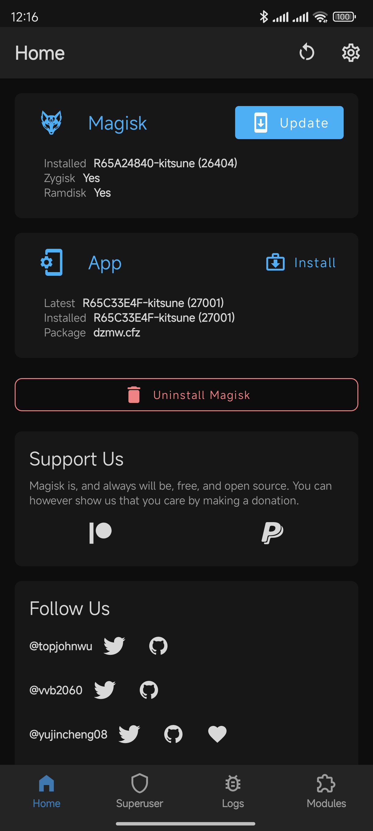

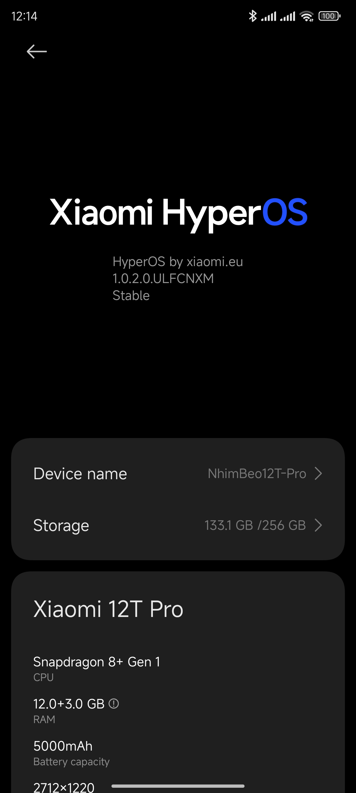

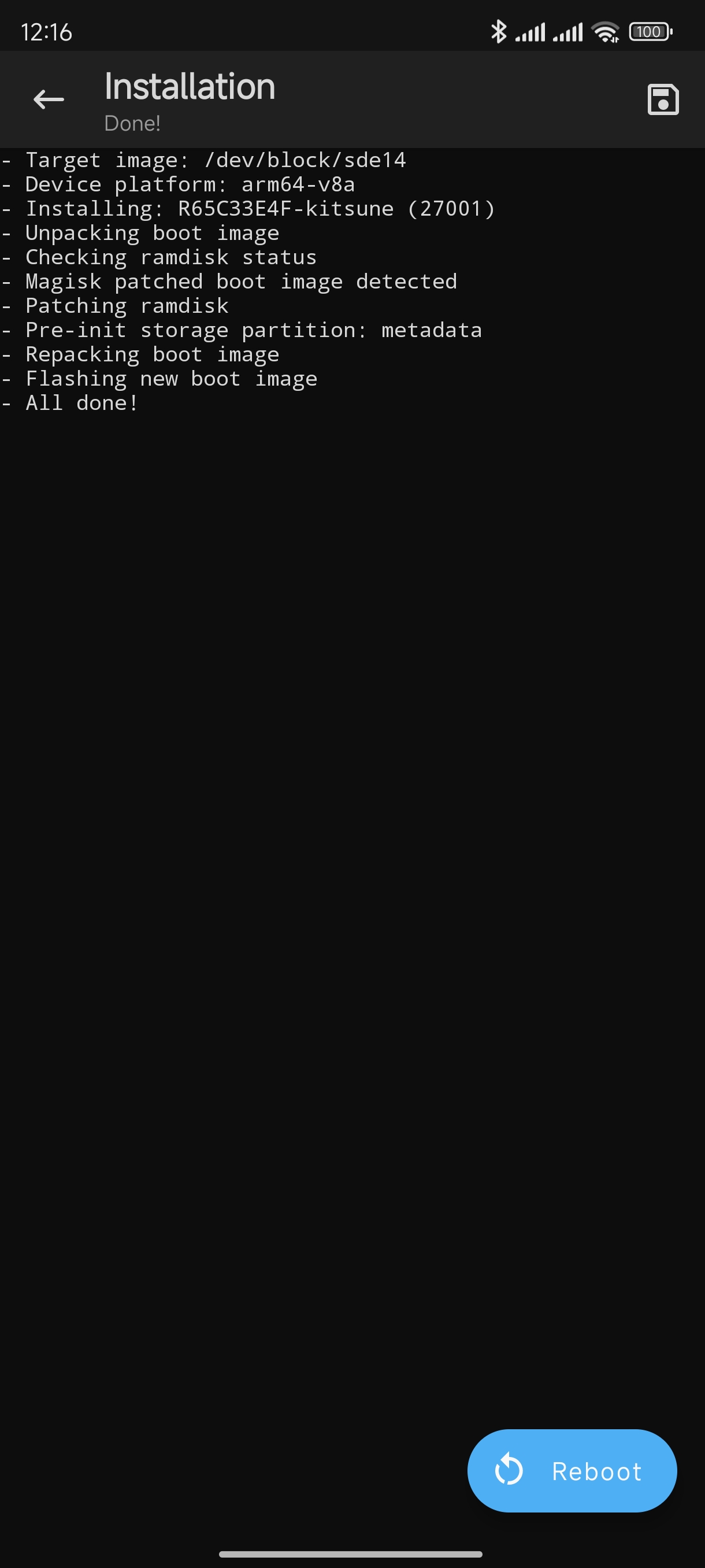

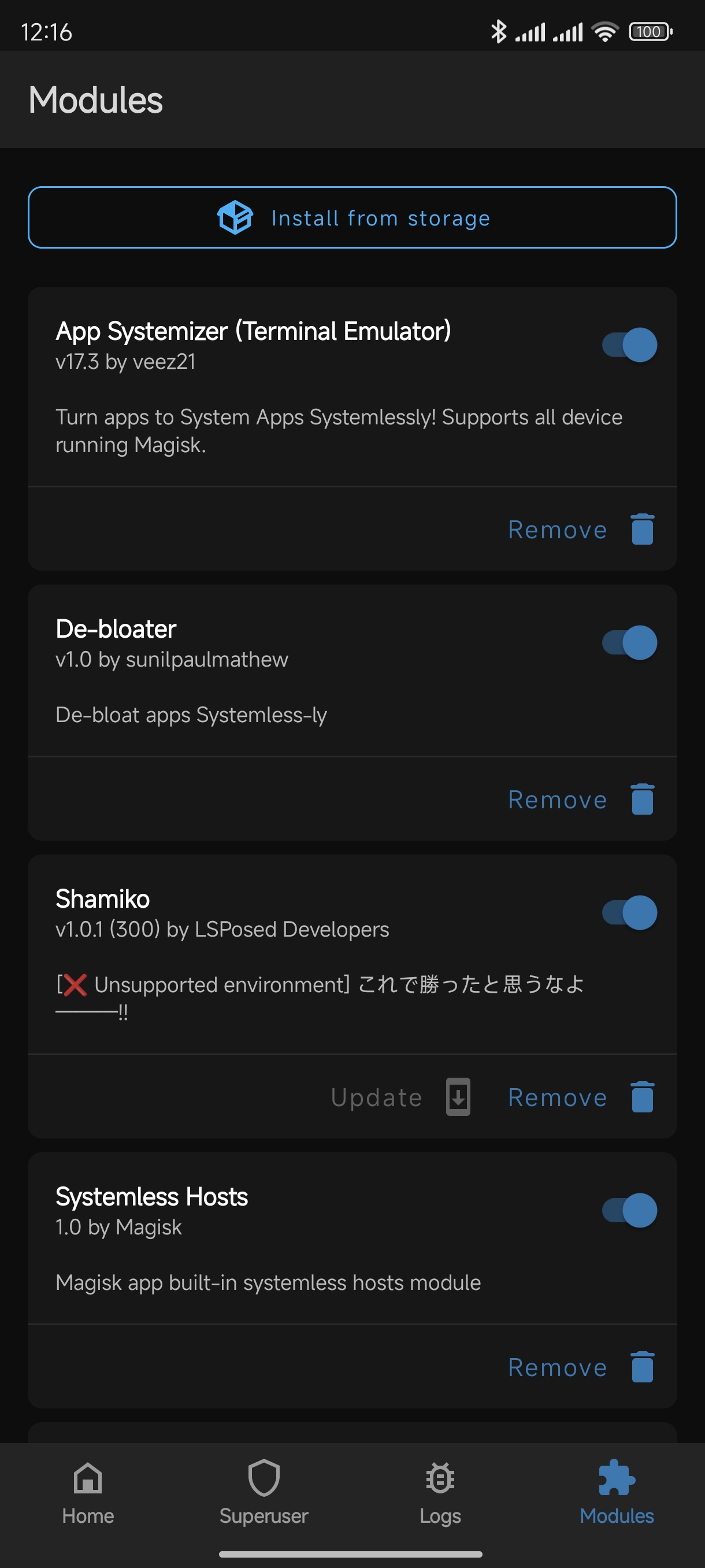

I'm also using 12T Pro (diting), which twrp version did you use to upgrade to Hyperos? Does HyperOs have Second Space?
Screenshot_2024-02-09-00-14-32-764_com.android.settings.jpgScreenshot_2024-02-09-00-16-18-799_dzmw.cfz.jpgScreenshot_2024-02-09-00-16-22-077_dzmw.cfz.jpgScreenshot_2024-02-09-00-16-27-628_dzmw.cfz.jpg
Confirm that Diting (12T Pro) up Hyperos is still normal rooting. When I flashed the rom from twrp, I checked the option to install magisk as well
