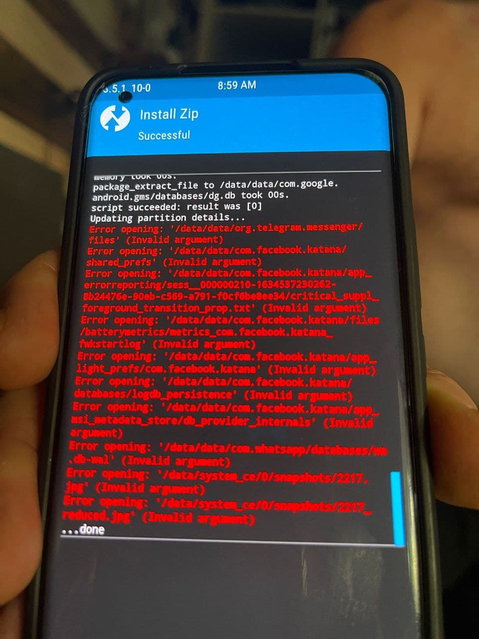

i entered my twrp recovery and im in the twrp i saw unusuall red raws with mention to these 3 apps , i dont know what is the meaning and i cant photo it .

i have mi 11 pro eu rom stable .
i had problem today with my whatsapp, facebook etc .i couldnt anter them , so i decided to install eu rom stable ,another version with my twrp .
i run the instalation and in the end he wrote me "done" with a few red raws .
i made a dalvick wipe and wanted to reboot into system , but no way , i couldnt enter the system and he still on twrp .
i can do what i want in the twrp but i cant see the file of the rom , if i want to reinstall it again .
im not expert so i left it till i find a sulution from the experts here

ive made clear data , format data .\
i succseed to enter my system but all my data was wiped like a factory rest
so actually i needded to flash the same eu rom version and not to downgrade it? that was the problem?
That was the problem for the TWRP reboot. But maybe cleaning your data will help as you will restart fresh for your applications which had issues in the first place.
