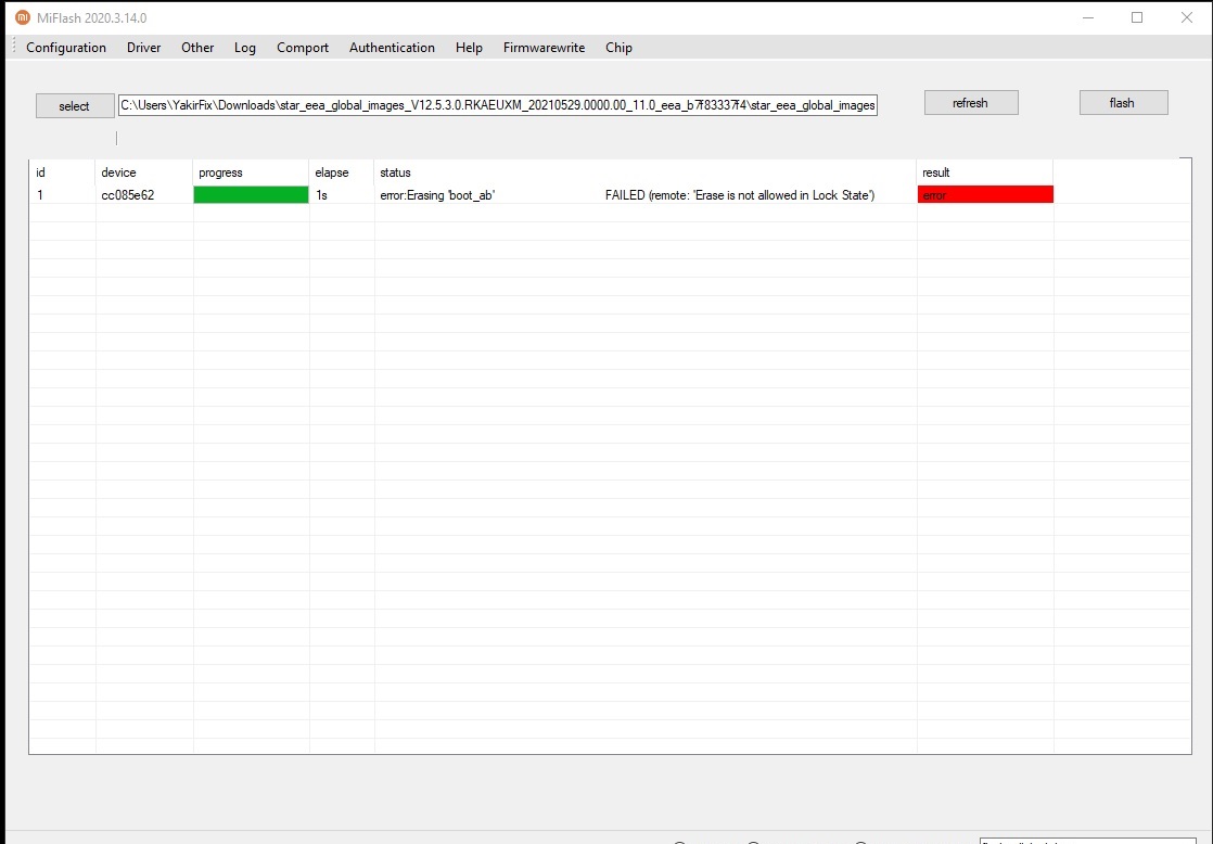

i decided to flash back the original ROM, and relock the bootloader, i thought it is the solution for my problems
but after doing that, i write the command oem lock , after that my phone died, stuck on "System destroyed bla bla bla"
i tired to flash back what ever ROM, but i can not because of error "Flashing is not allowed in Lock State"

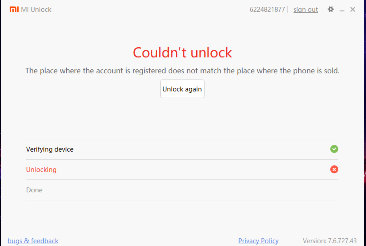

i tried to unlock bootloader again, did not work "couldn't unlock the place where the account is registered" tried to make new account, did not work i need Chinese phone number

If you have a Chinese version of the device and you have installed a Global or EEA ROM, you must not lock the bootloader!
Now you need to find a repair shop or some online unbrick service
You can only lock the bootloader in the following cases:
- CN devices
with CN ROM
- Global devices with any Global ROM derivative (MI, EEA, RU, TU, TW, ID, IN, etc.)
You must seek service.

but any idea what to do now ?
I already wrote to you. Find a service center to fix it. For example, online Unbrick etc. or a physical repair shop near you.
