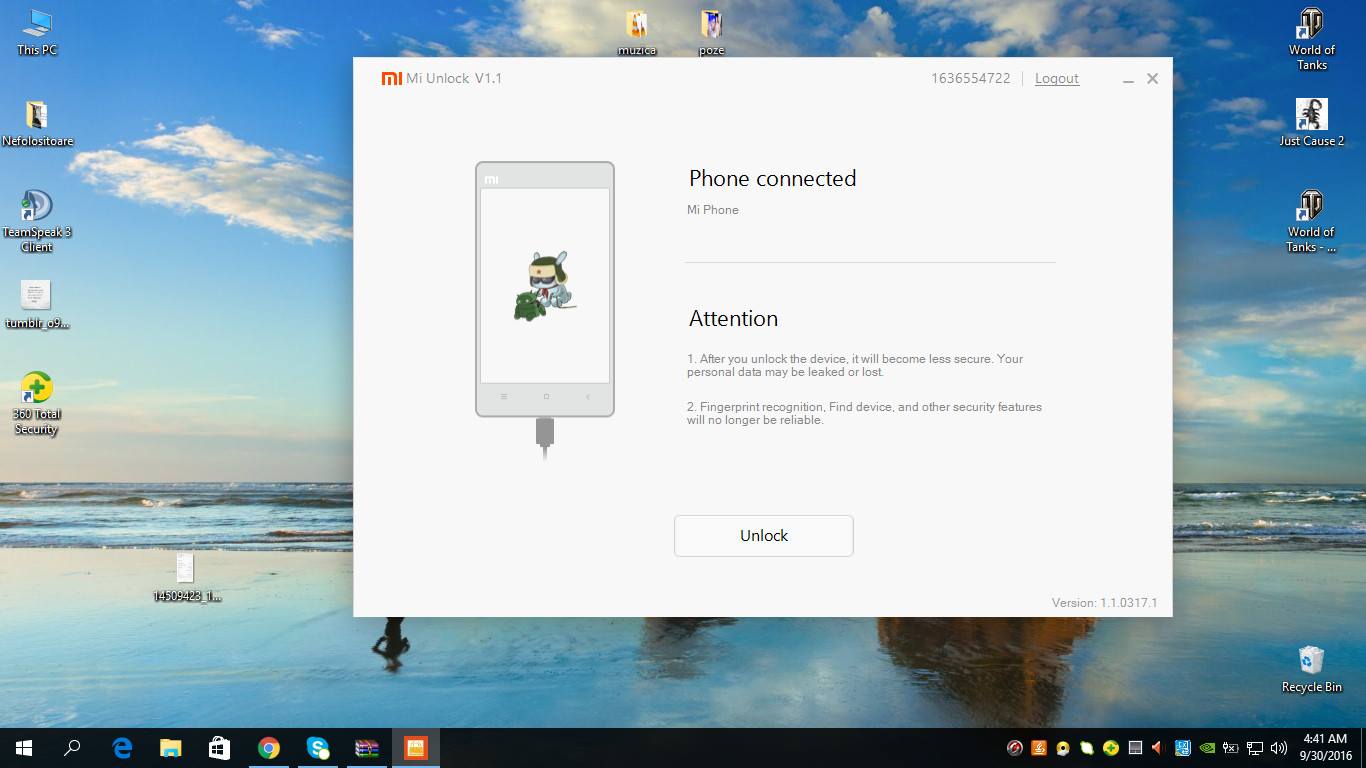

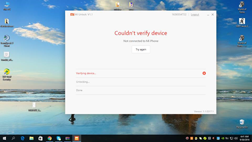

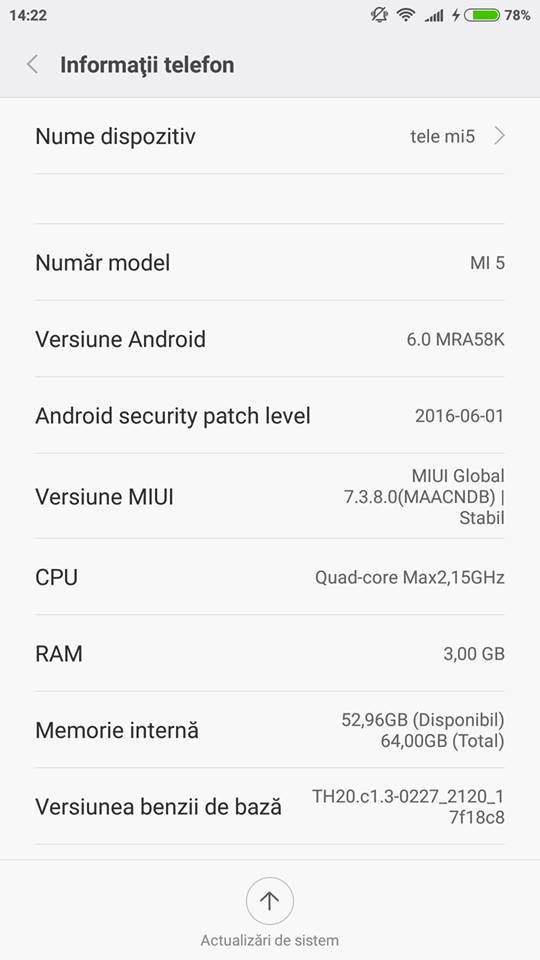

First i want to say that i tried to Unlock my bootloader , i get permison from xiaomi , i tried miflash but when i press vdown+power button , the bunny appear , unlock proces goes to 50% and after the bunny disapear (appear for about 12-13sec) and after it disconnect .Version - MIUI Global 7.3.8.0 (MAACNDB) Stabil

i know , for me xiaomi cable didn´t work , then i tried with a better cable and was fine (xiaomi mi5).
With mi pad2 i had same problem flashing , better cable has solved the problem.,
You rom is non genuine, it cannot be 'global' with *CN* in code name.
You need to install OFFICIAL dev rom (china or global) to unlock.
For that, you may need a PC 64 bits, a deep flash usb cable and miflash.
Confirm: I had the same issue with "50%" problem. Tried many times - without any success.
After I've install the OFFICIAL dev rom (Global) - I've successfully Unlocked my Mi5.
Hope it helps )))
