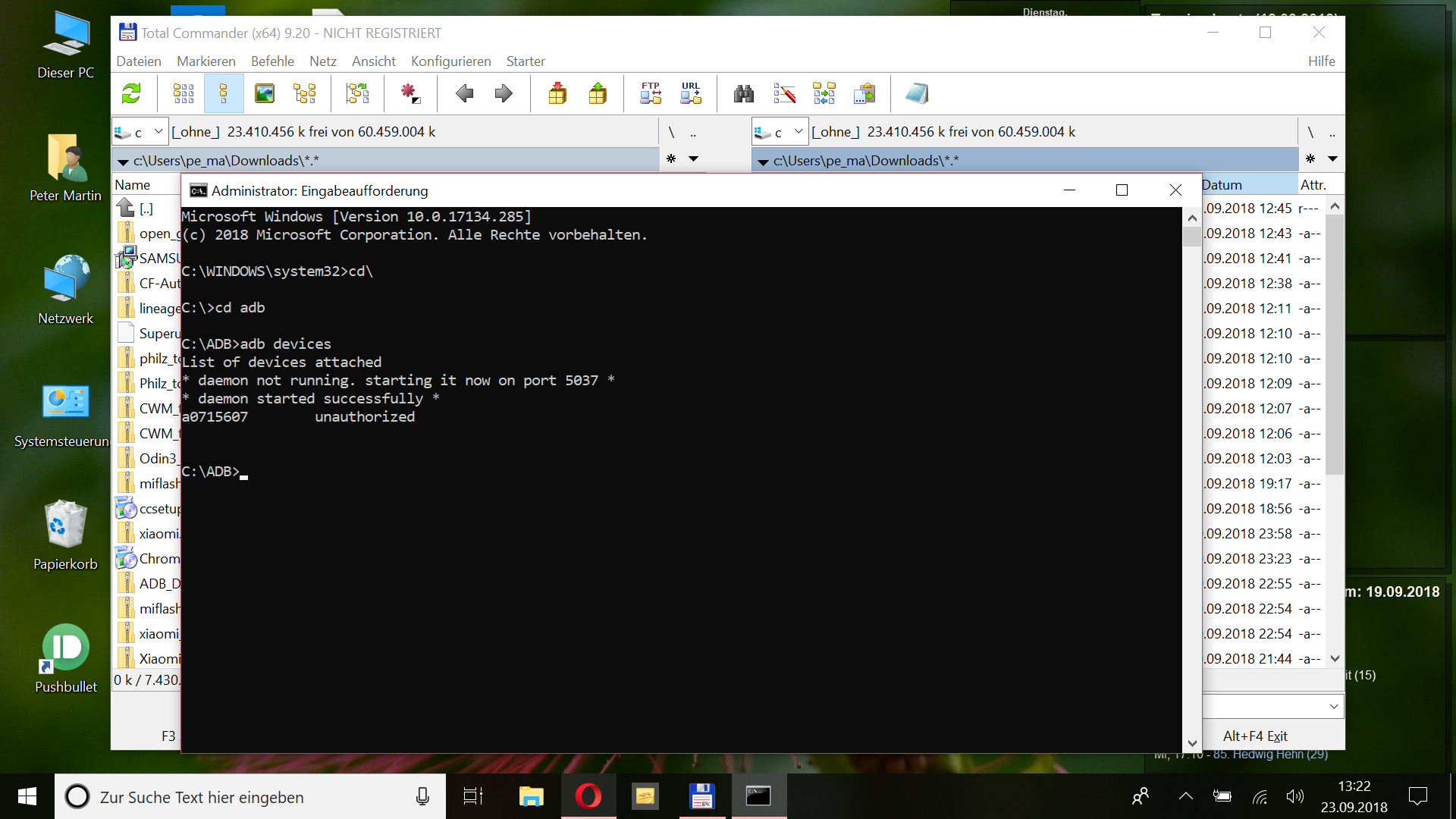

What happens if you reboot the phone from ADB, using adb command, in Windows while phone is connected to PC?
This is a screenshot
You did not authorized connection to PC.
When connecting to PC in Windows mode look for pop-up massage and allow connection, you may swipe down once to change connection mode from USB charging to file transfer:

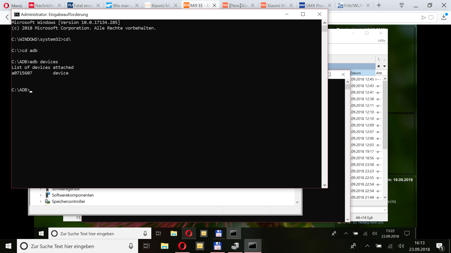

adb reboot bootloader
Hello!
Now thats the result!
But if i start in the start in "fastmode-modus" and connect to my laptop the modus stop and restart the phone.
There will not be a connection on the unlock-programm.
Can anyone help what can i do?
