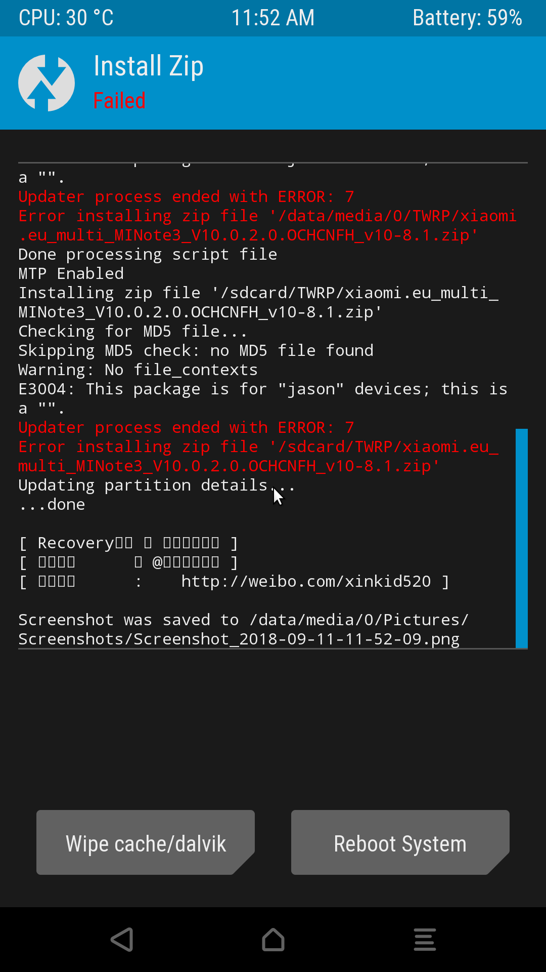

Hey guys,
I need your help, please. After the release of Miui EU 10 Stable I decided to update mi Note 3. My actual ROM is version 9.5.10 stable.

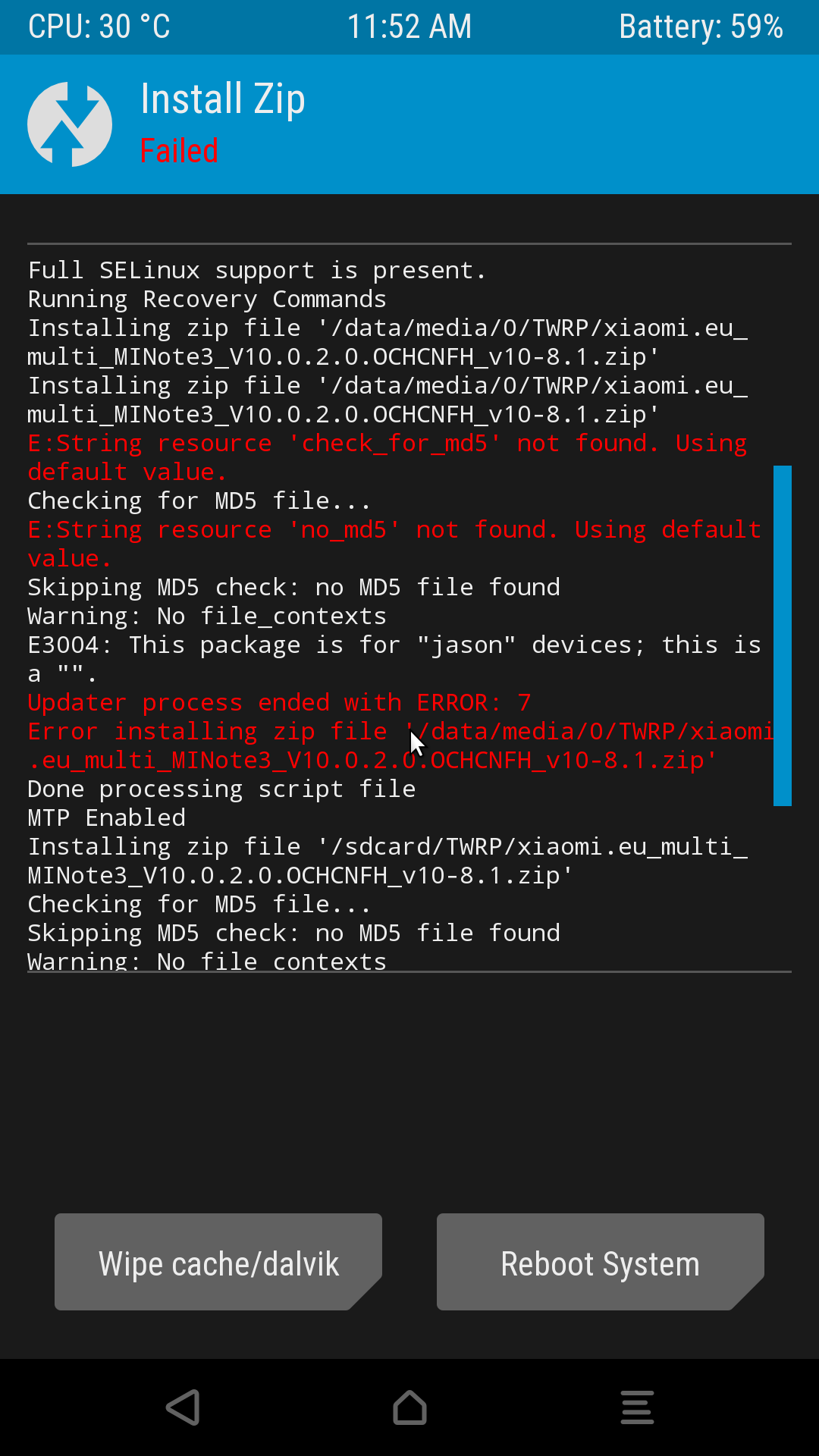

First problem: the updater-app show the possible update, but after press the download button a message "you have already the actual rom". So I run plan b to download manually to install via twrp
Second problem: twrp installation failed with an error I've never seen before (attached files)
Does anybody have got an good idea?
thanks a lot

That means you need to update TWRP to a newer version.
okay this problem solution seems simple. Thank you!
to be sure: data are not deleted on the update of twrp via fastbbot, right?
No, not unless you make a mistake.
TWRP should only be flashed to the recovery partition, never to system or data or anywhere else.
