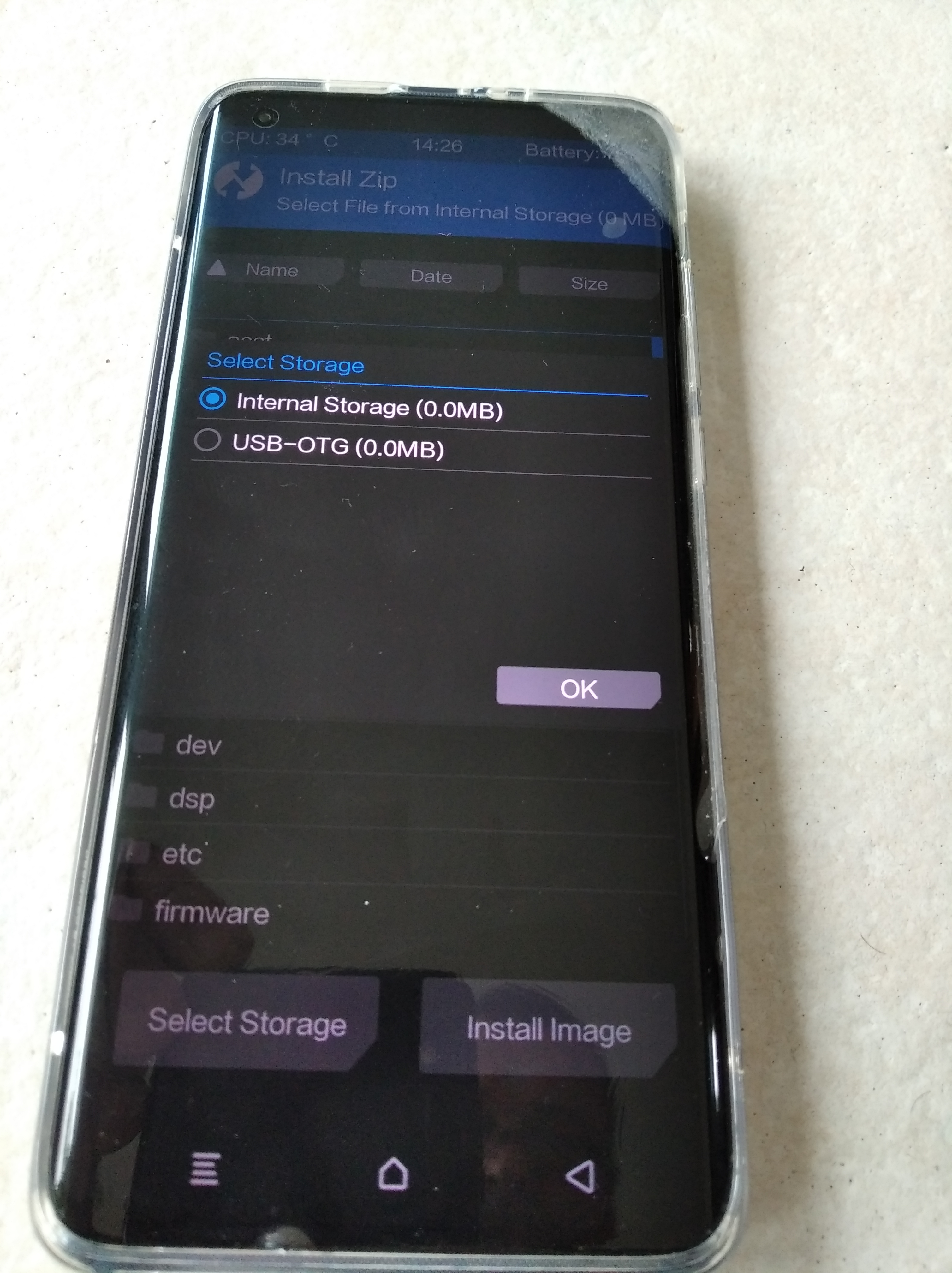

After this, during normal use, it rebootet to fastboot and there seem to be no more files on the phone and it just can be restartet to fastboot mode or the twrp.
Before I do the same mistake a third time, I need your help, what I have to do to get a stable running system.

1- install clean rom in fastboot mode again with global version of xiaomiflahs from here (http://c.mi.com/oc/miuidownload/detail?guide=2) just check clean all
2- reinstall twrp in fastboot mode
3- start in twrp, go to erase and just format data, start again in twrp, copy rom xiaomi.eu in the phone memory, with usb connected and twrp open. install rom xiaomi.eu and reboot into the system.
4- do nothing else in twrp, only format data
You must do all of this to get your phone shipped from the factory first, before doing anything.
