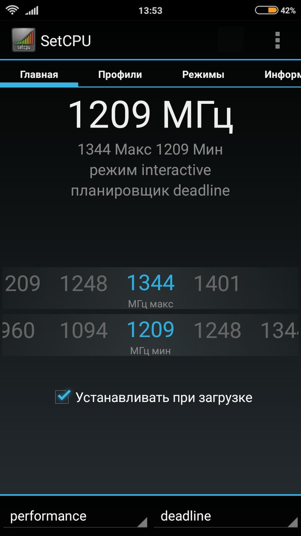

Generally guys ! I found the campaign to solve the phone reboot . Making Root , and then install the application " Setup CPU " and set up the processor speed min 1094 max 1344 and enjoy the stable operation of the phone ) ) ) ) ) ) ) ) I want to say that while this option Test

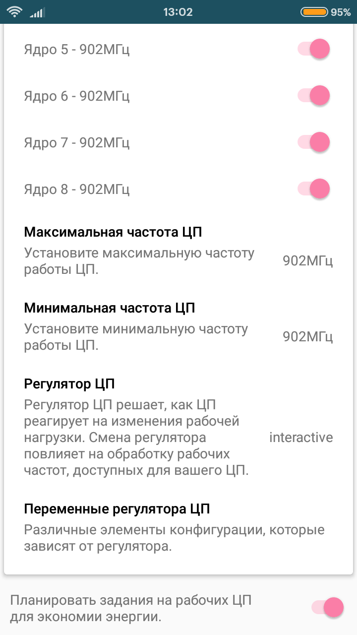

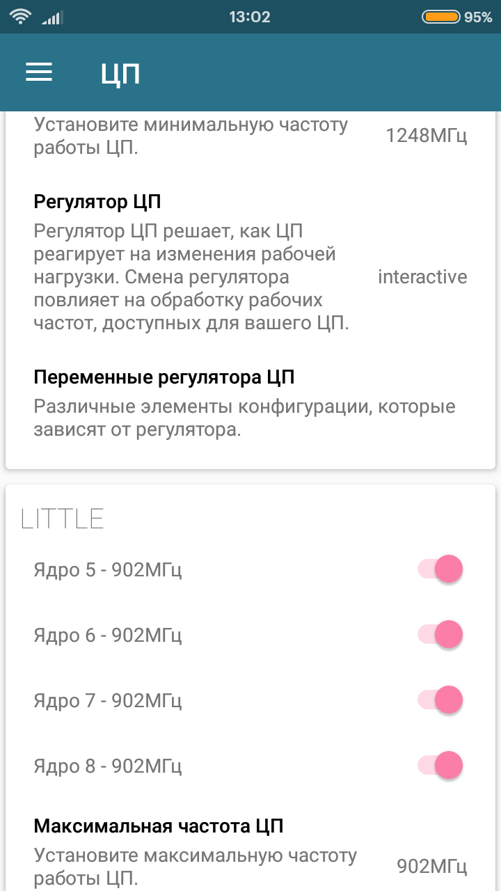

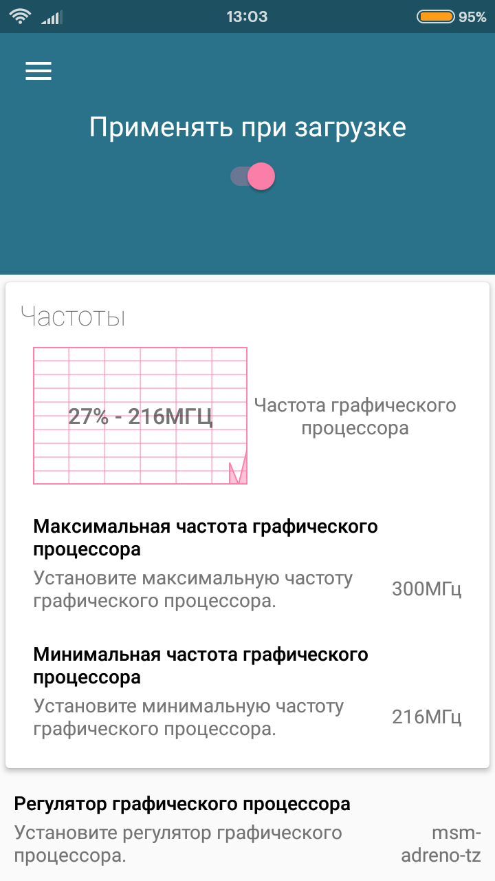

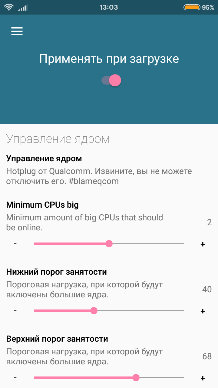

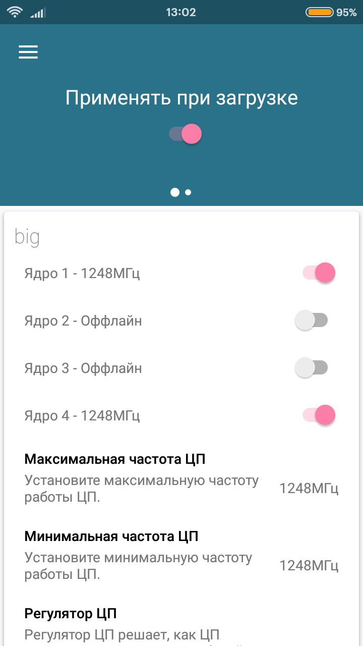

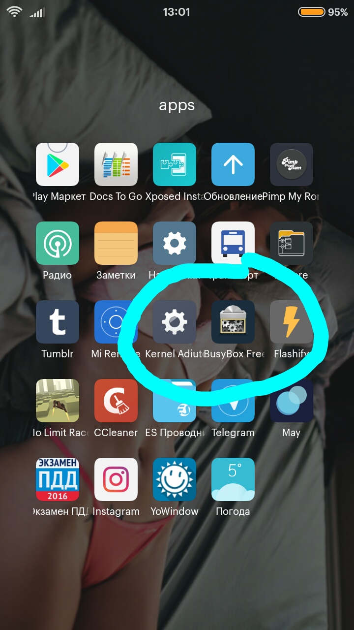

Hello!I found a solution to the problem with a reboot:
1) do root
2) put the last busybox
3) put the kernel auditor
4) to set up the kernel auditor cpu and gpu as in the picture
The whole trick is that the cpu to the minimum frequency was the same as the maximum frequency, this is done with the gpu.it does not always deliver zabudbte "run at startup"
1) do root
What do you exactly do with this method? Put CPU/GPU freq @ Max or remove them from being at max??
