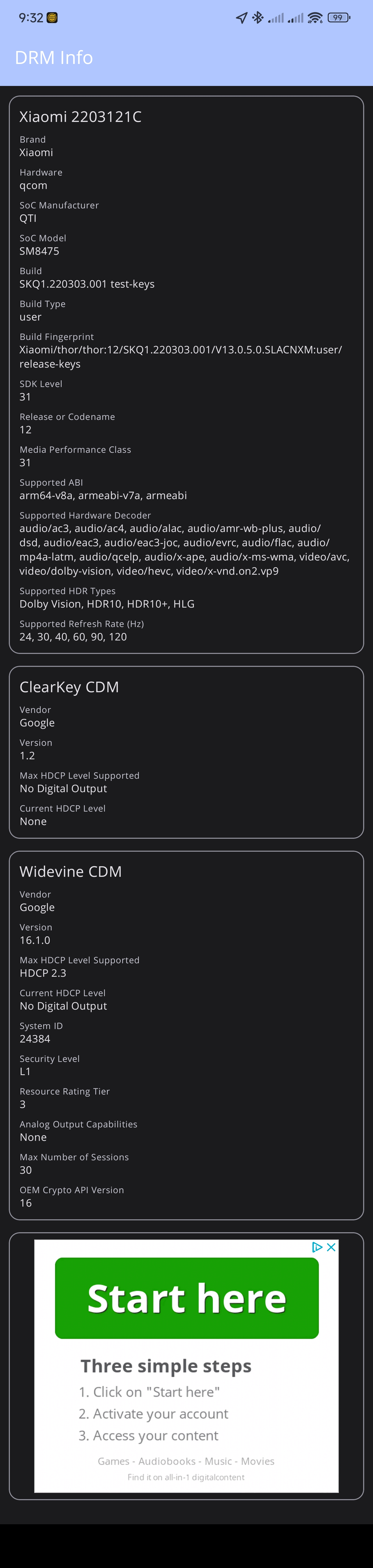

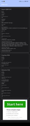

Need Confirmation : Mi 12S Ultra widevine L3 ?
12s Ultra DRM info attached

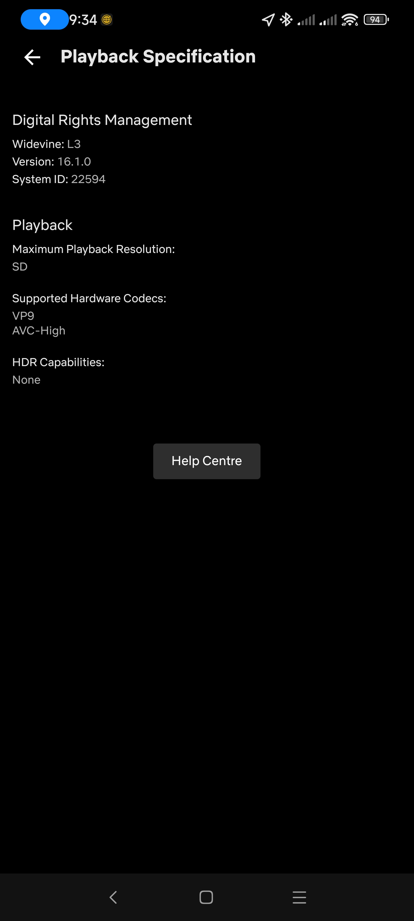

Yes mine does too but it works fine. See screenshot.
Same for me.
L1 in DRM info
L3 in Netflix app
So, only SD quality on video streams.
its SD quality only , so it doesnt work fine for me.

DRM info is L1
Netflix app is L3 and SD quality
Tried to update certification, FIDO and Alipay updated successfully but only Widevine failed, error code is 1
Is there anything we can do? even by rooting? or maybe with an update of the rom?
