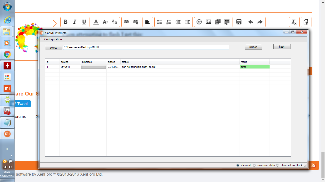

Upon attempting to flash I get this:
Where do I find these .bat files??

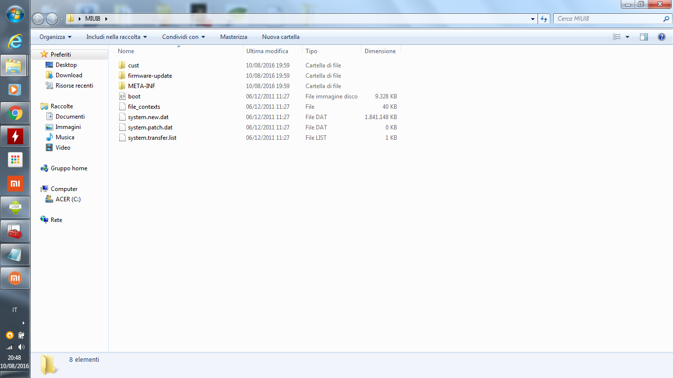

This is my extracted folder:
EDIT: The ROM I am attempting to flash is latest China Developer ROM (MIUI8). I haven't unlocked device.

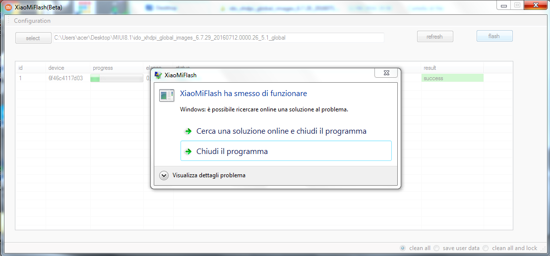

I downloaded that ROM, extracted into folder, I used XiaomiMiFlash and it said "successful"
However now it does not turn on anymore, I believe it is stuck on bootloop. This is driving me nuts :D HELP
EDIT: It also stopped working right after Flash.
After I see "succesfull" it did not turn on for 15 minutes and I was panic but suddenly it become alive :)
How many minutes passed in your case?
This is what happened after Flash.
And now it's 5 minuets since 1st attempt. Should I wait or am I doomed? ...
But progress did not completed but it is succesfull, I dont undertsnad this. Actually I dont know what to do now.

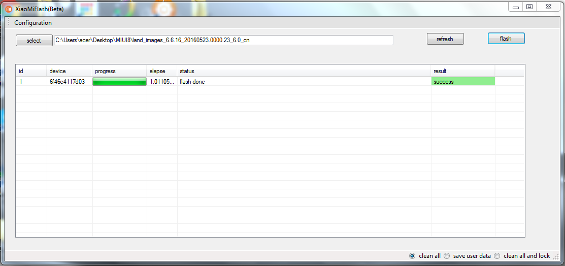

I installed the ADB drivers, followed all the guides and I even made sure the phone was at 100% battery. I can't even access recovery mode by pressing home + vol up.
UPDATE: I flashed the China Dev ROM and it shows like this:
Now I will check if it boots.
UPDATE2: Still stuck on boot....
