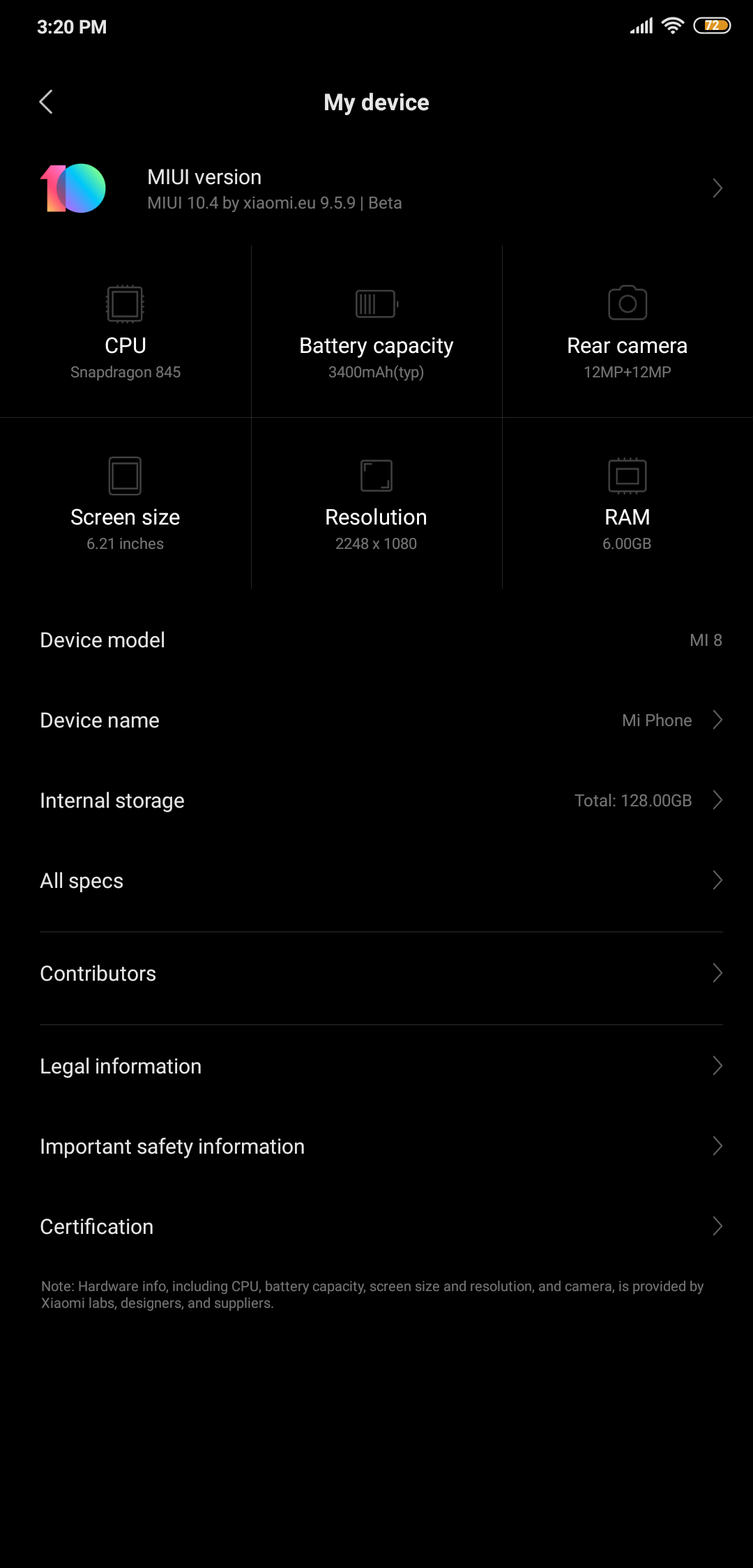

Reboot to recovery after successfully flash magisk in latest built (9.5.9) on mi8.
ashylden
Mar 8, 2019
4
Any solution for it?

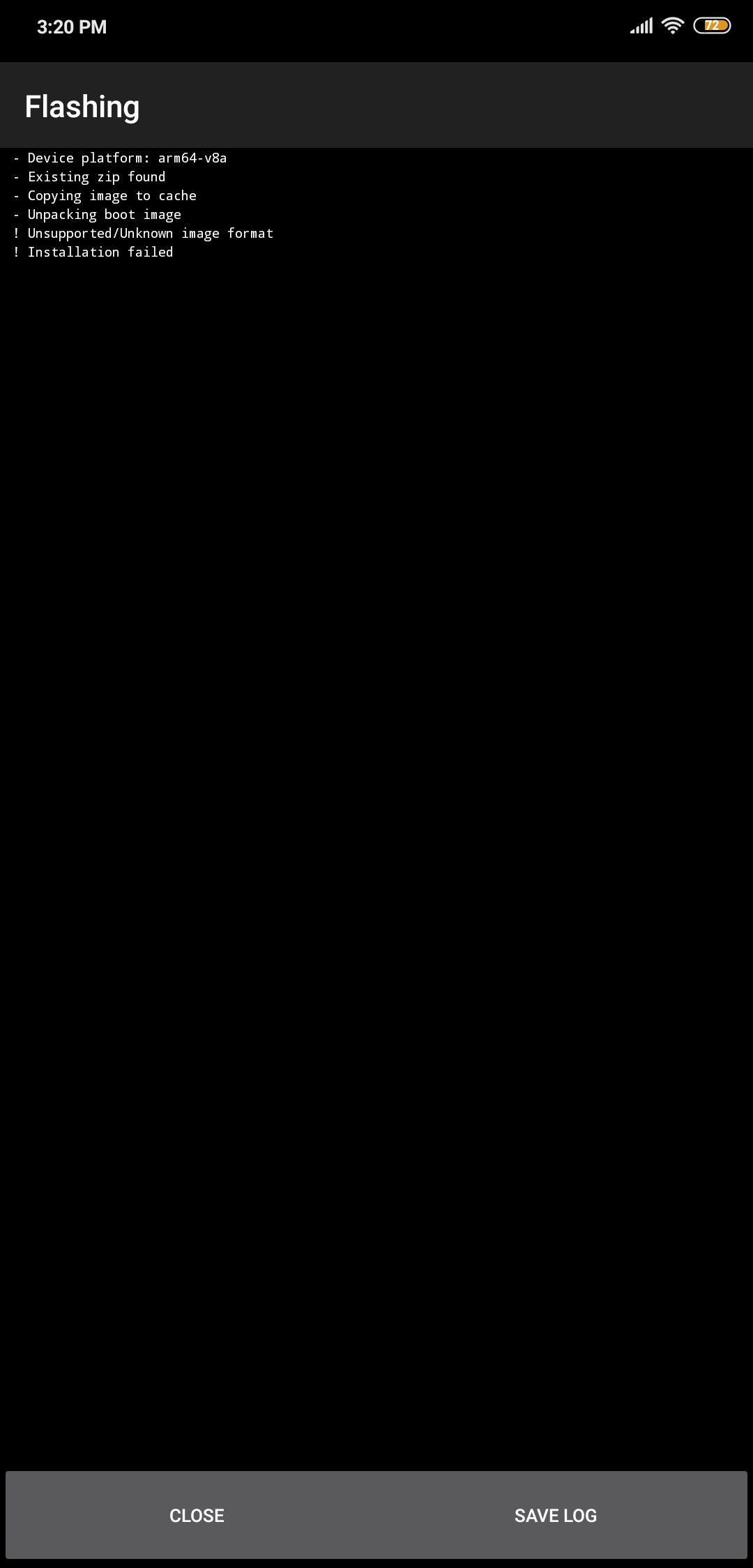

When i try to install magisk using magisk manager which is "Select and patch a file" method, the log says
- Device platform: arm64-v8a
- Existing zip found
- Copying image to cache
1022+1 records in
1022+1 records out
1047368 bytes (1022.8KB) copied, 0.007234 seconds, 138.1MB/s
- Unpacking boot image
Parsing boot image: [/data/user_de/0/com.topjohnwu.magisk/install/boot.img]
! Unsupported/Unknown image format
! Installation failed
I try to flash both magisk v18 and v17. Same issue.
Really appreciate to those who help to find a solution

Issue Fixed with :
-Reflash the latest eu rom
-Flash magisk v19
-Flash previous Sphnix kernal (v2.7)
Before this i :
-Fash the latest eu rom
-Flash magisk v19
-Flash latest Sphnix kernal (v2.8)
The issue cause by the latest :
Sphnix kernal which it v2.8
