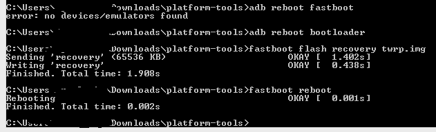

is there a miflashtool rom i can try?
i was on xiaomi.eu 9.6.27 and was flashing upgrading to 10.3 stable
in the process, i got both locked out... android and twrp 3.3.0.0
anyone encountered this issue?

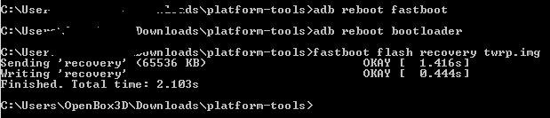

after doing this
still got booted into encrypted TWRP

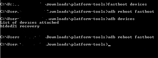

You should try to boot into TWRP after flashing TWRP
fastboot boot twrp.img "should boot into twrp" allow all modification
in twrp do a format data "to get rid of encryption"
reboot again into twrp
Copy latest xiaomi.eu rom to root directory of Smartphone
Flash rom
reboot
Flash rom
reboot
the "should boot into twrp" instead becomes "boot into encrypted TWRP" and requires a password
i used Vol - and Power to get into fastboot again and same thing happens.
