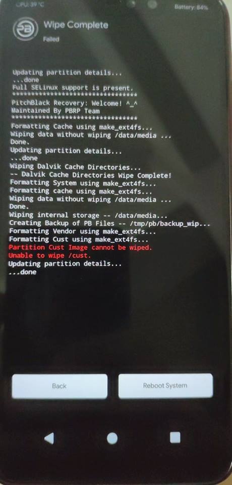

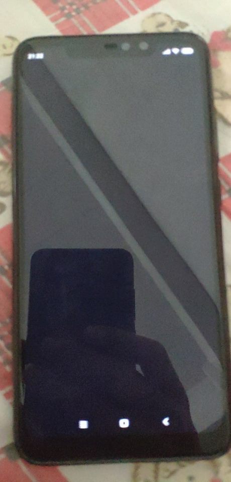

I need help. Xiaomi Redmi Note 6 Pro My Phone Instrall Rom Weekly 8.11.23 have wipe advance on twrp
Camera is not working. I'm not sure how that happened. I can not use the camera right now. (twrp pitchblack) And (twrp Unoffcial by xda)

Maybe the problem can be related to the custom recovery? Did you try to re-install the official rom?
I have the same problem. I tried to flash stock rom but my camera still dead. So sad T--T
I've read several posts like this....very strange. It seems that after flashing the custom recovery the camera is gone.
I have tried reinstalling. still the same

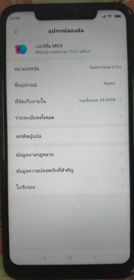

Flash phone via Xiaomiflash (miflash) to Official Miui 10 Global Developer from fastboot rom with option clear_all
Maybe its issue with twrp or xiaomi.eu rom?
Did You format/wipe persist partition - vendor partition? Maybe yes and its a result... DONT FORMAT/WIPE PERSIST/VENDOR PARTITION.
Its result of this stupid action.
Show about phone info when You flash to Official Rom via Miflash not twrp!

I think reason is on TWRP, People format Vendor parition and lose drivers/vendors.
And why he wipe/format system too?
I never wipe system....
