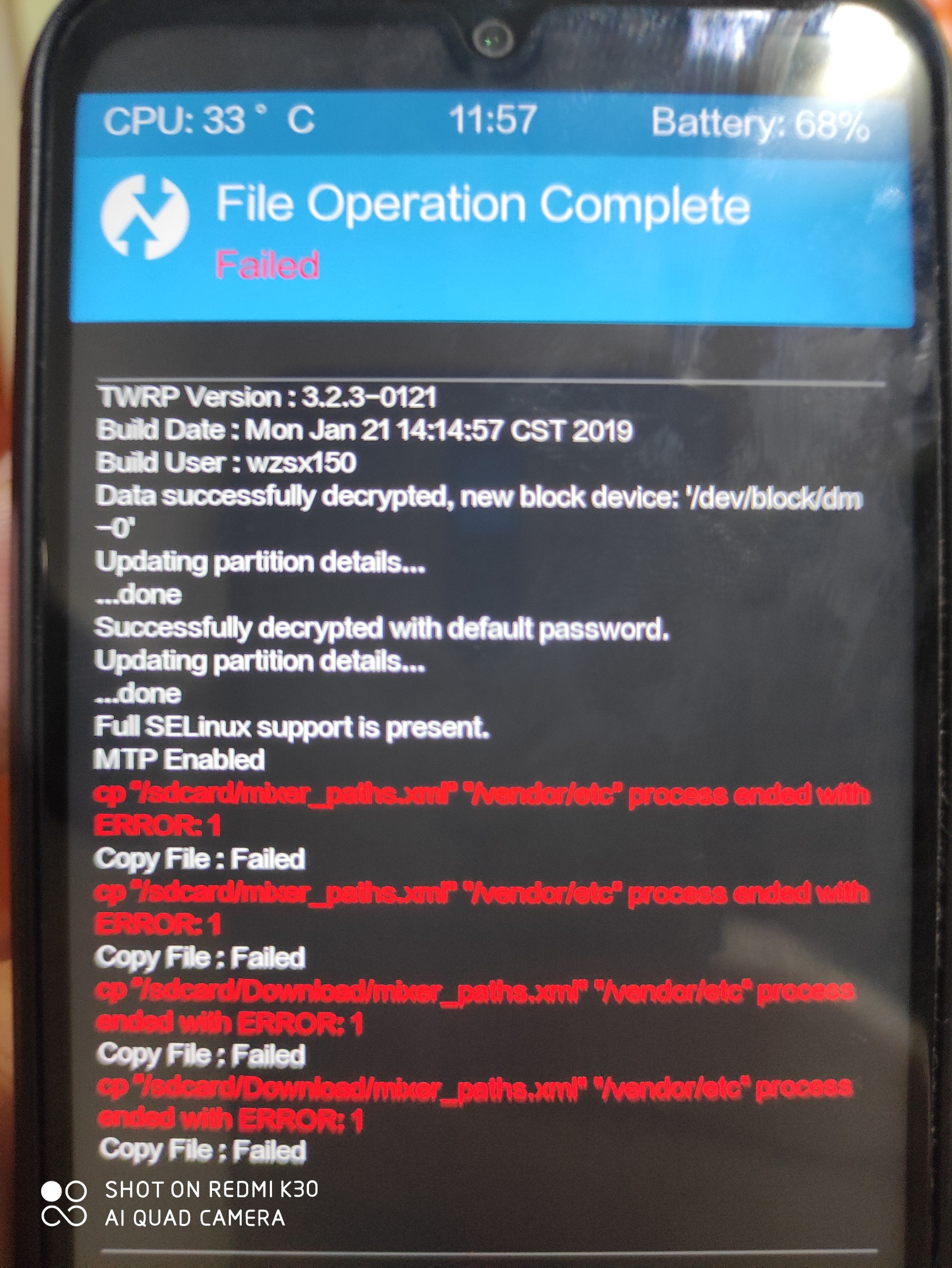

Sorry for spam. I have successfully mounted. But when I copy the file to the error message as shown above. TWRP can't copy this file @@
