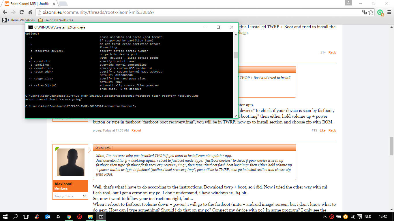

"cannot load recovery img"
what to do?
You need to place recovery and boot images in the fastboot folder.
I did and then I got another screen:
Still "cannot load"
