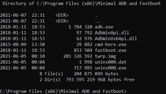

only some questions because in your questions there are not so many details. Did you do this things:
- unlocked the bootloader
- installed the USB drivers (Minimal ADB and Fastboot)
- enabled the developer mode
- enabled Usb debugging from the developer options
- copied the twrp-image file into the path from "adb and fastboot" folder
- is the filename from twrp-image the same as in your command line (fastboot boot TWRP-IMAGE-FILENAME)
- checked with "fastboot devices" if your phone is recognized (in fastboot mode)
- checked with "adb devices" if your phone is recognized (phone is up and running)
And DONT do this: fastboot flash recovery C:\recovery.img
Do this: fastboot boot twrp.img
If you can answer all questions with "yes" then it should be no challenge to install twrp and the xiaomi.eu rom
PS: You can spend me 20,00 Euro-> you have saved 5 Euro :cool:
Short explanation:
Devices with A/B partition scheme don't have a recovery partition so you cant "flash recovery twrp.img"
You can only boot in recovery mode with "fastboot boot twrp.img"
To permanently flash recovery to A/B devices, you need to unpack both boot.img (A/B) from device
Replace the ramdisk with the one extracted from twrp.img and repack then flash boot.imgs back to device ...

First: Thanks for a very exhaustive and serious answer and I'm sorry about being unclear about the details in my first question. I also appreciate your explanation at the end. Although it (obviously) was many years since I wrote code mysefl I'm still interested in learning things.
Out of the 8 questions:
1-5: Definitely: "Yes"
6: I think yes but can not swear on it
7: Yes: Command prompt returns
"5392ed16
fastboot"
8: Do not know but I guess the last part means that phone is up and running? Comand promt returns:
"List of devices attached
* daemon not running; starting now at tcp:5037
* daemon started successfully"
Among the things I DO have tried is the part you have written in red, starting with "DONT...."
I will now try the instruction in green first and see it that works for me and if it does I think I need to better understand the next step in "undoing the ****up and install TWRP as in this thread https://xiaomi.eu/community/threads/guide-install-twrp-for-mi-11-pro-ultra.61239/ )
P.S I would seriously be happy to transfer some euro as a thanks for a solution.
fastboot boot twrp.img from command line resulted in the following:
downloading 'boot.img'...
OKAY [ 4.323s]
booting...
FAILED (remote: Failed to load/authenticate boot image: Load Error)
finished. total time: 4.377s
Any idea of what that meand and how I can try to get around it (if possible).

I'm using the TWRP- version linked to in this guide https://xiaomi.eu/community/threads/guide-install-twrp-for-mi-11-pro-ultra.61239/ (Mi11Ultra(Pro)-twrp3.5.1-recovery-21.5.9-decrypted) which I have renamed to twrp.img an put in the same folder as the "Minimal ADB and fastboot"-directory.
Attached is the screenshot from my adb-folder.

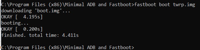

Attached is also the result of writing "fastbbot boot twrp.img" which is exactly the same thing as I did with the exactly same file when I wrote post 13 in this thread. I tried it several times and also both switched USB-port and restarted the phone and computer several times but kept getting the message "FAILED (remote: Failed to load/authenticate boot image: Load Error) " every time.
Now it worked as can be seen in one of the screenshots.

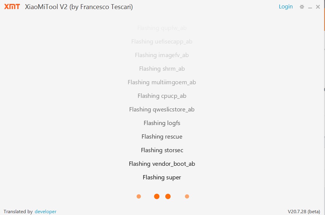

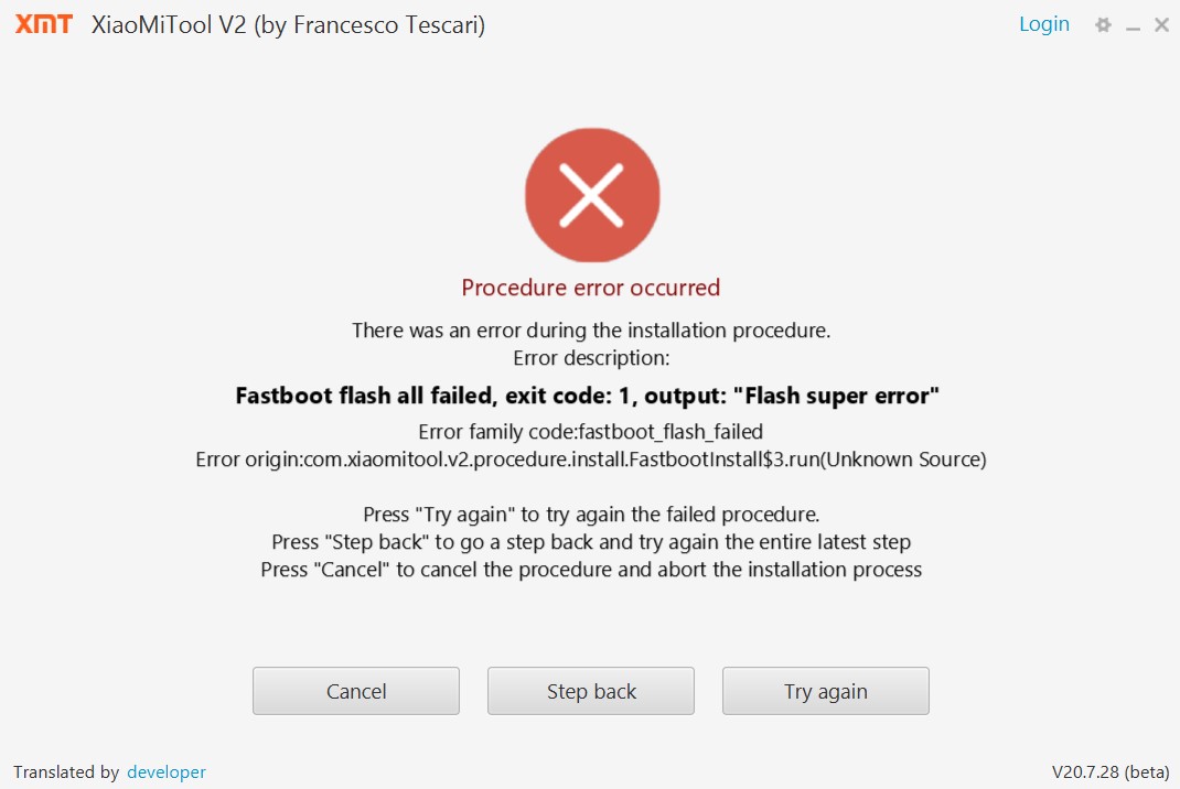

XiaoMiTool V2 is said to support this operation and I can find "Star" in the list of phones but if I try that way the process fails at "flashing super" (attached pictures).
If I instead download MiTool 20200314 I get errors when trying to install the drivers and the links for help results in the familiar error 404.
