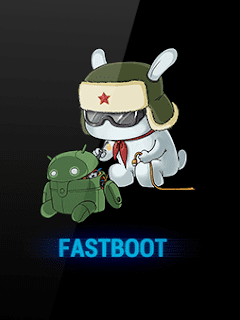

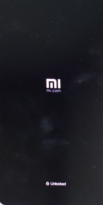

- if u r the first user of the phone, it is locked.
- reboot to Fastboot actually : power off then press Volume - (down) button and power button together, it will go into Fastboot mode.
- forget about the misc.bin
- sometimes you need it but not always. forget about it too.
the pictures show the "unlocked" logo on boot and fastboot logo when get into.
